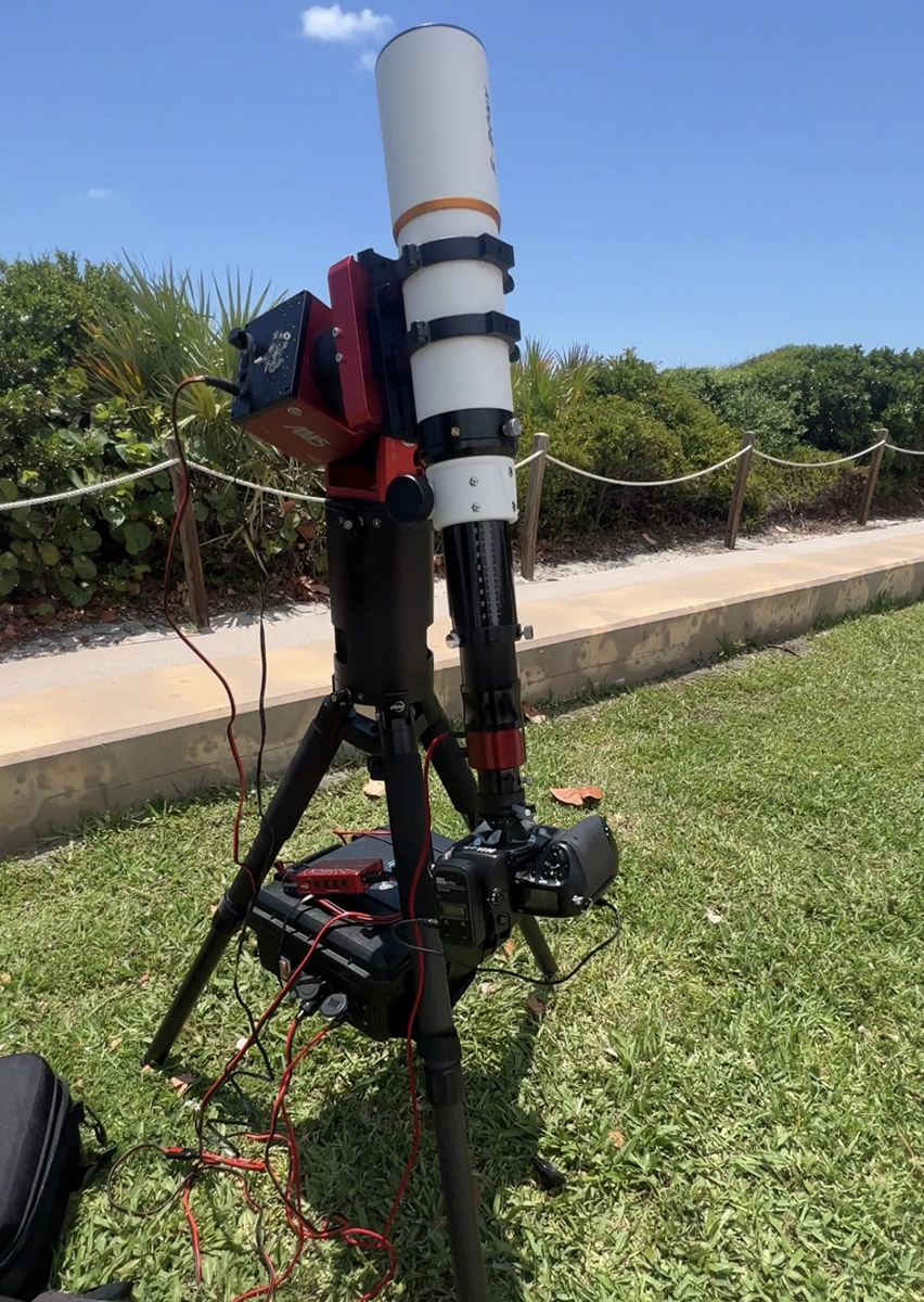

I'm using a 420mm focal length telescope with a Daystar Quark hydrogen filter to image the chromosphere which has a built in 4.2x teleconverter.
