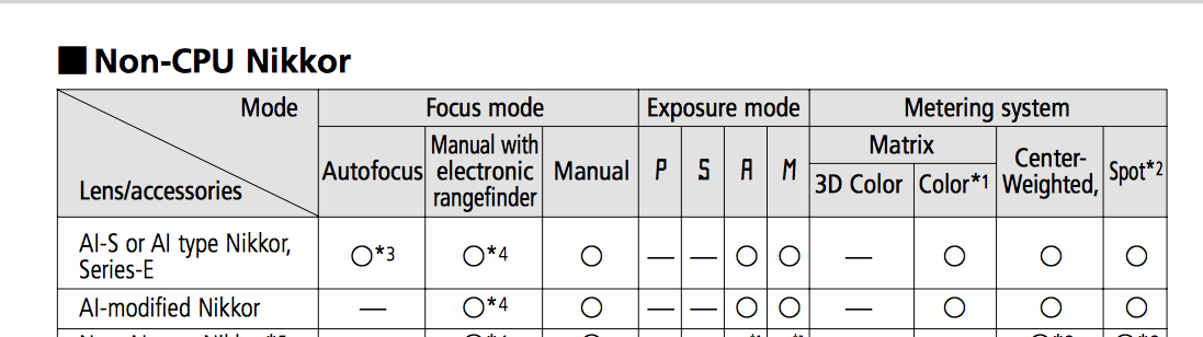

... not even the F6 will work with E lens, ...
F6 manual indicates this:

The AI-s or AL type Nikkor series E are manual focus. Unless Nikon has updated the F6 manual in the past couple of years the E lens had been released.
