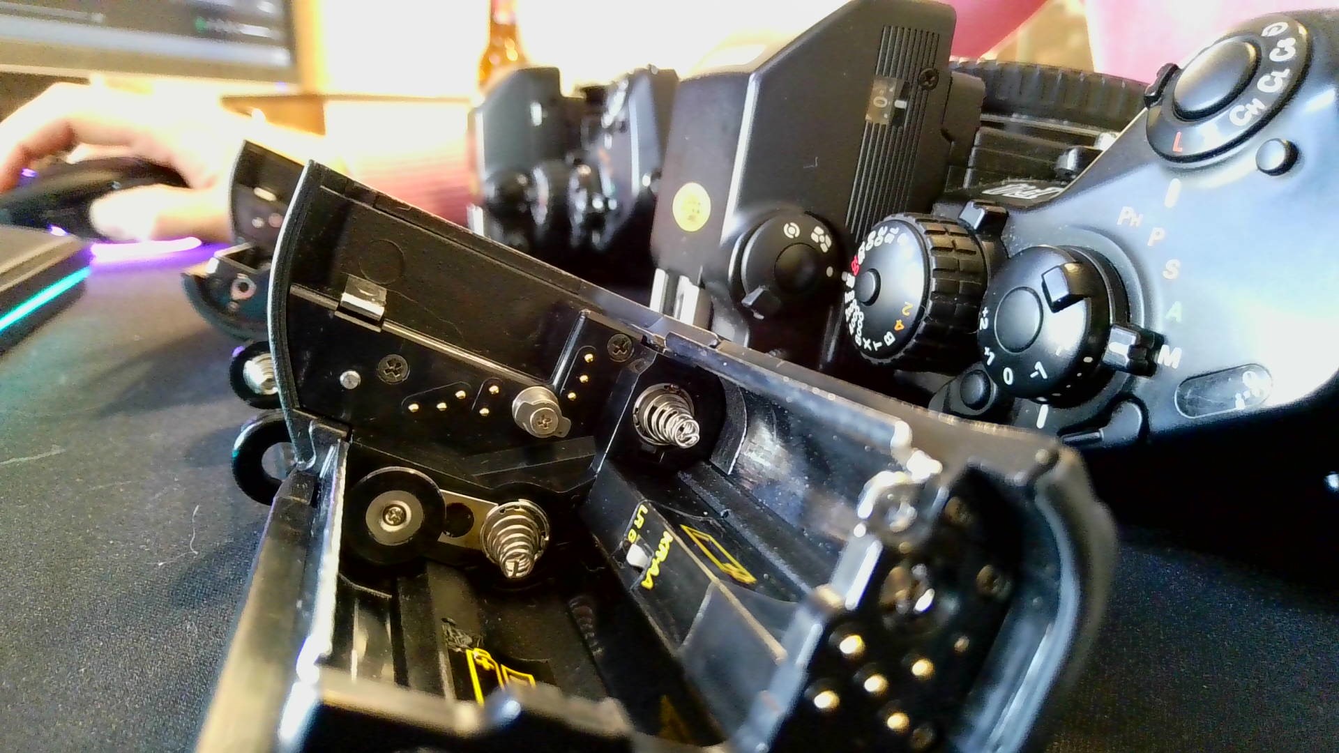

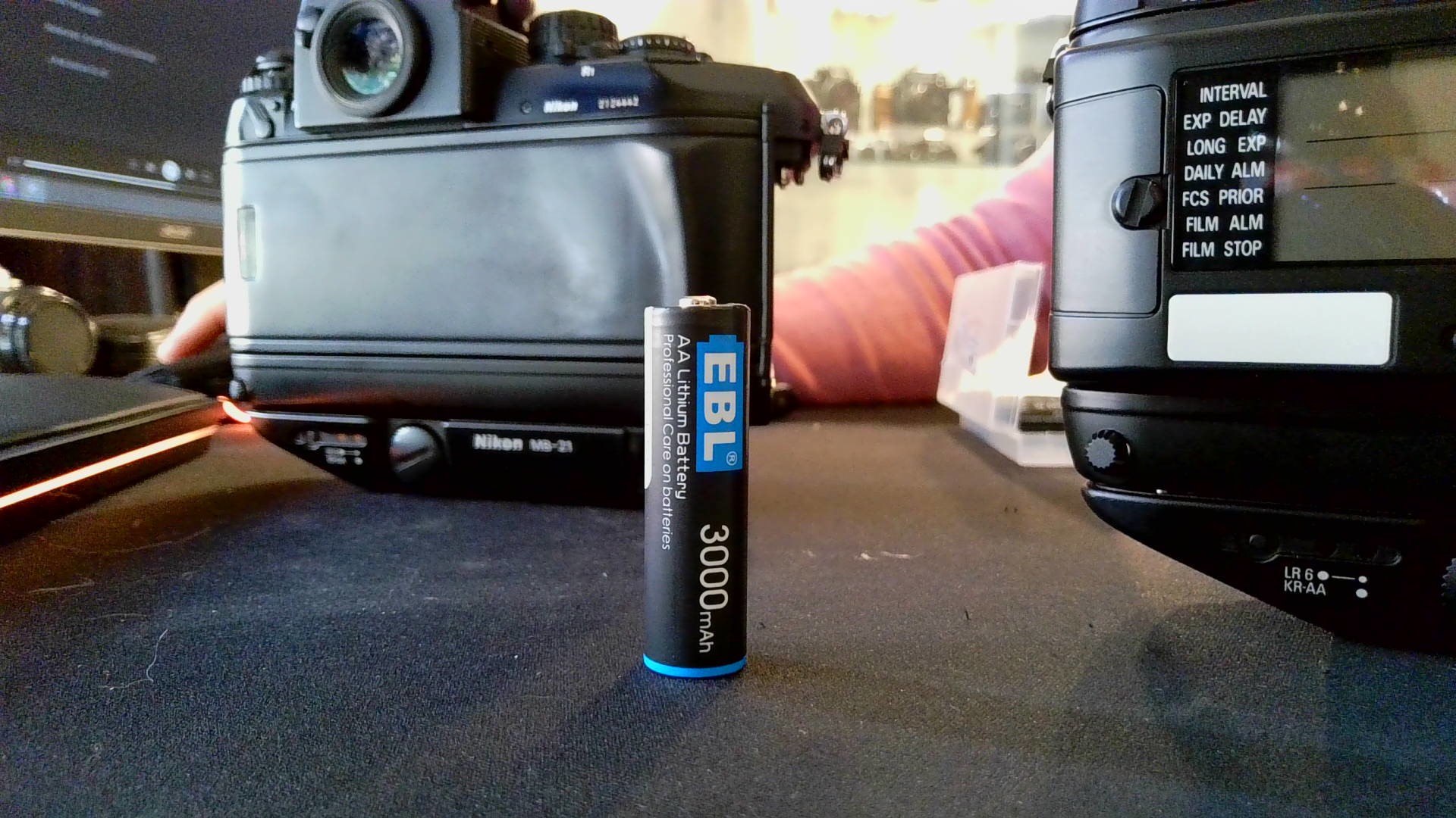

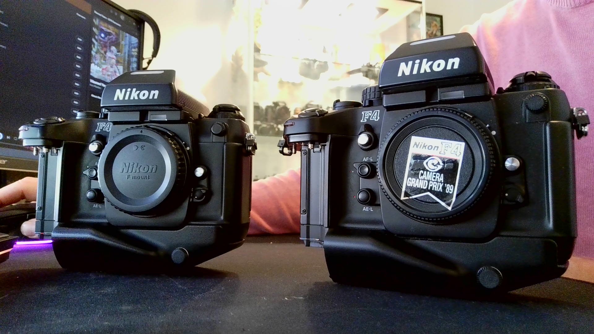

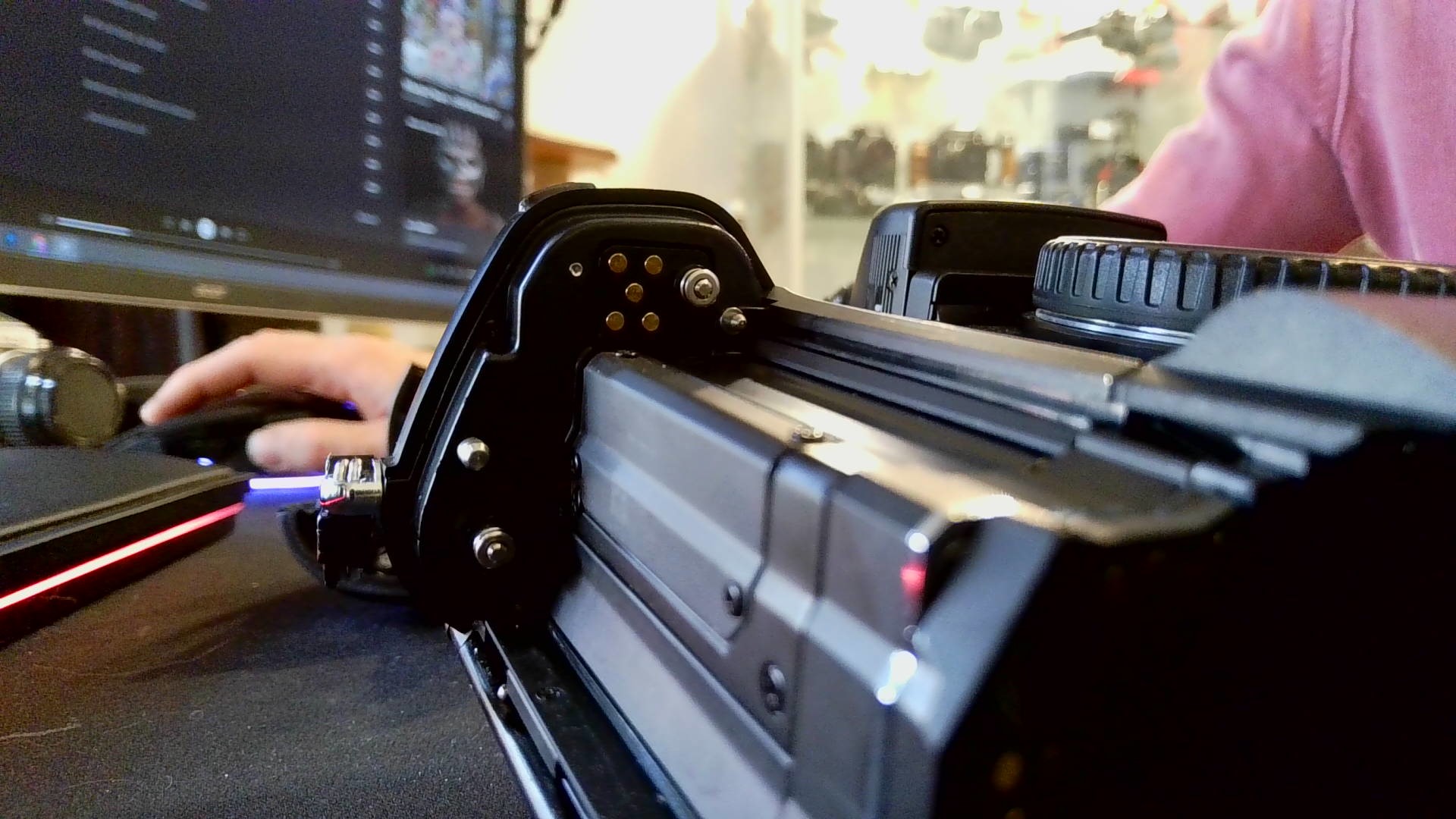

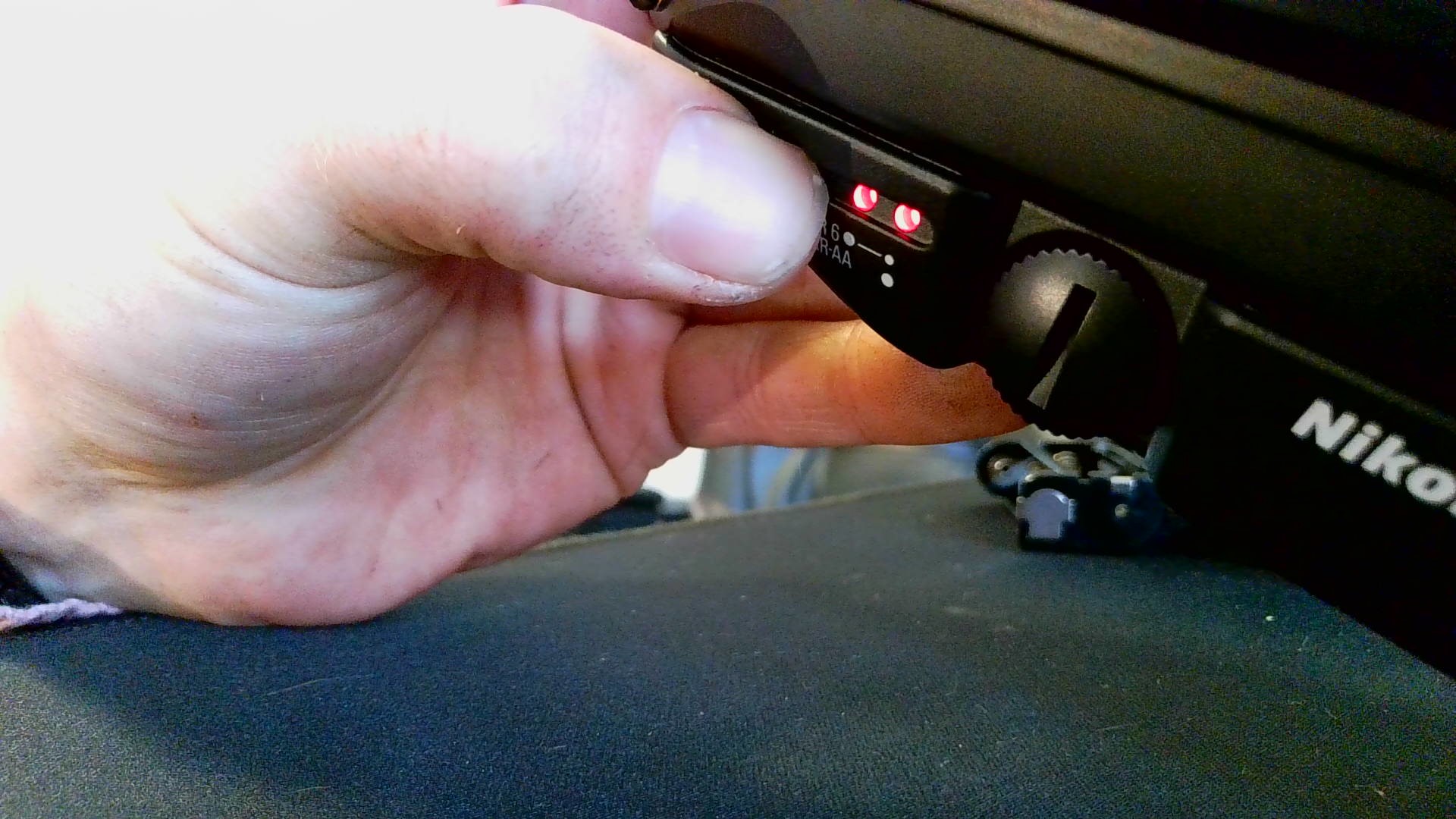

Picked up two Mint nikon F4 cameras recently that seem to hardly be used and were stored in a hard case for 15 years, but I can not get either of them to turn on. I have tried giving the contacts a clean, using different batteries, swapping and matching the battery holders, removing the prisms but i can't get either to turn on. I've tried using the pictured batteries, fresh alkaline batteries and rechargable batteries. The only sing of life is the battery check button. Has anybody had a similar experience, is it worth getting them professionally looked at?

there are no signs of life besides the LED battery light

I don't see the battery holder for the base. Do you have them? you need 3 batteries in the base and 3 in the grip. I used my F4 wth EBL Li-Ion rechargeable batteries and it works fine.

The operating voltage is obviously not reaching the other electronics in the camera as @Henning Serger assumes. The two battery contacts in the battery compartment into which the second battery holder is inserted could be the problem here. I would work on these intensively with electronic cleaner and an eraser.
I would definitely check the output voltage on both battery holders with a multimeter, it should be at least 2 x 4.5 volts with fresh batteries. If it is less or 0 volts, a contact problem could be the cause - clean as described above.
If that doesn't help, the camera must be opened to check whether voltage can be measured at the inputs on the circuit board for the operating voltage. However, disassembling the F4 is not trivial.
From then on it becomes difficult to check because you need to know the circuit to do so. The troubleshooting tips in the service manual or SPT journal for the F4 may help. But that is already very special.
