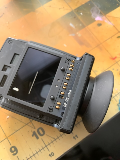

I believe I have tracked the issue down to the dp-20 viewfinder. If I take the viewfinder off it focuses no issue. Upon further inspection one of the contact pins may be damaged between the body and viewfinder. I also do not get any display on the lower lcd. I can’t seem to find any pictures of what it should look like but one contact is definitely missing. Can anyone confirm that all pins should be present?

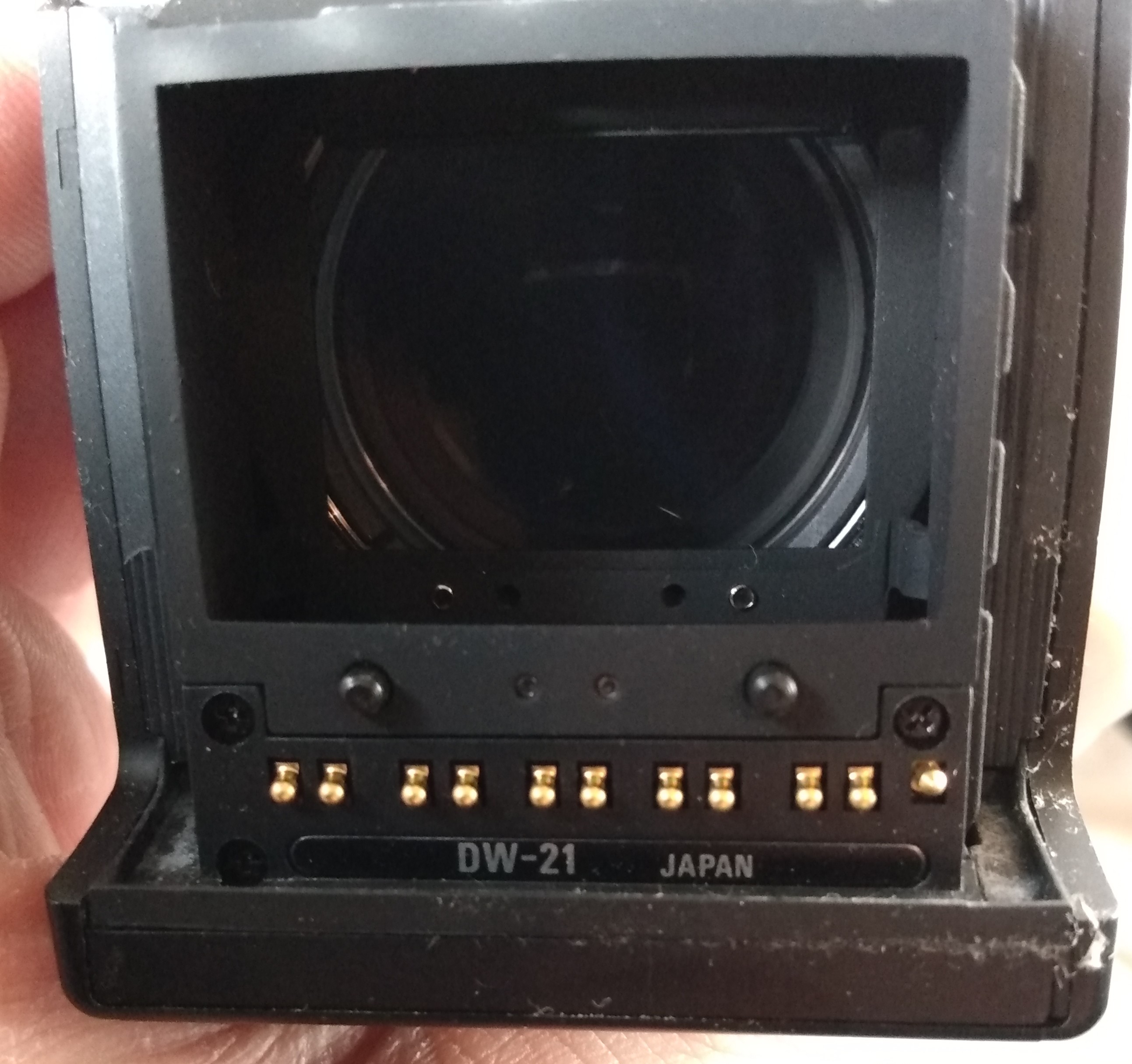

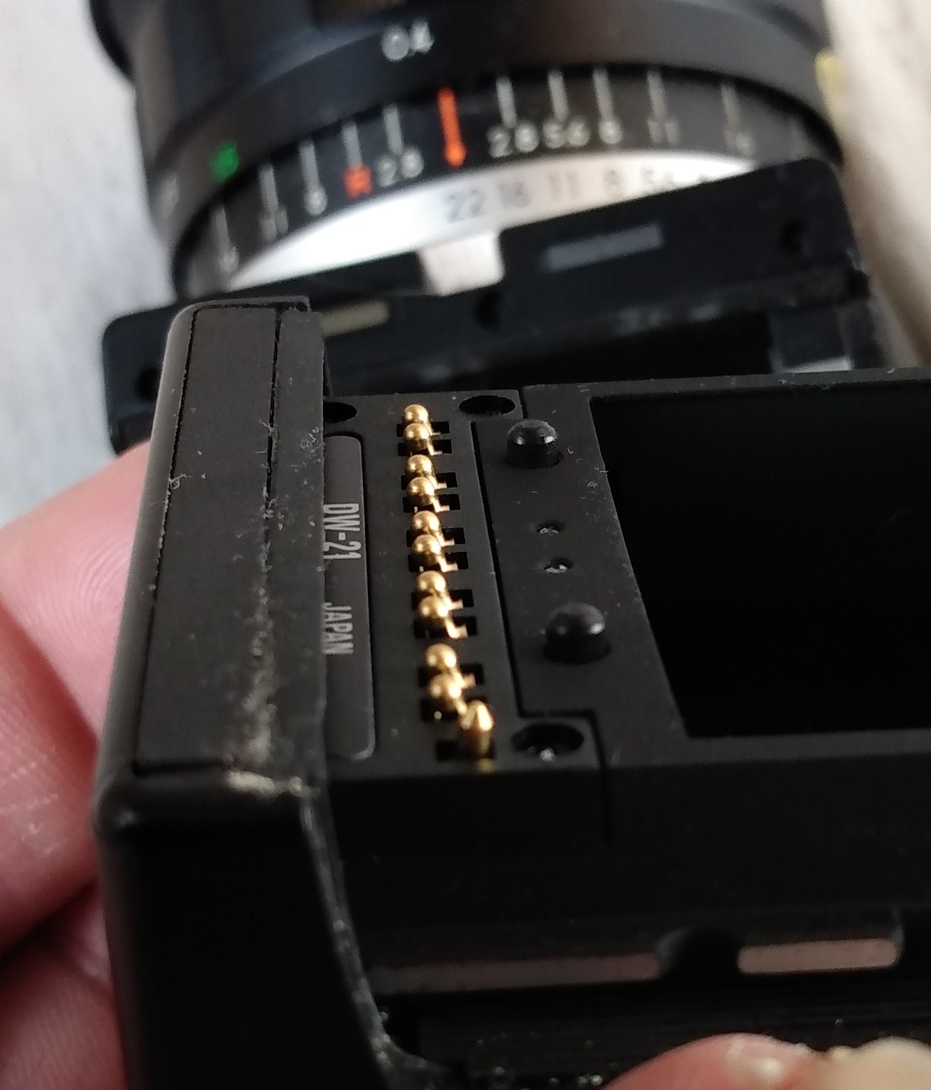

I've only got my DW-21 to hand , but I'm positive they are both the same.
Notice the last one on the right is a different type of contact than the others , likewise the contact for this pin is different on the camera body as well .
( Apologies for the crappy phone image )

Thanks for taking a look! Yeah, the one pin on the far edge is different but I found the repair manual for the viewfinder and pin “I” for CLK (not sure what that is) is definitely broken off. The contact on the camera side looks slightly marred too. Likely from when it broke off. Looks like I’ll have to hunt for a replacement viewfinder or parts.

Mine has 11 pins present, 10 are the same and 1 different. Mine looks like the photo above. Is the viewfinder fully seated onto the body?

when it’s fully seated I have the AF issue. If I unseat it it works as normal but I no longer have a full viewfinder. I’m pretty clearly missing a pin.

I can see the pin there in the photo, its pushed under the hole.

I don’t think the rest of it is inside there but I’ll open it up later and see if it’s just a matter of bending it back.

My F4 has a DP20 also, I just looked at it, there is nothing I could do to get my pin to disappear like that. Makes me think it broke off. If you keep the body, it also looks like the contacts could use a wipe of deoxit ( removes corrosion/oxidation form contacts ).
I see several DP-20s on E-Bay in the $50.00 range, some less.

This ended up being a replacement on the viewfinder fixed it. The contact was broken off. All is good now. Thanks everyone.
