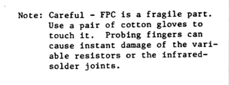

http://arcticwolfs.net/ has factory service manuals for the F3 V1, F3 V2, and the F3T and a arts list. Figure out which version you have, download the service manual for it then look at the shutter release diagrams. Its likely you bent a contact of the multilayered release switch when the cable release broke or during removal of the cable release plunger. It may be as simple as gaining access to the switch and reforming the contact to as complicated as replacing the release mechanism.
If you decide to open it yourself be sure to pay attention to notes such as this one:
