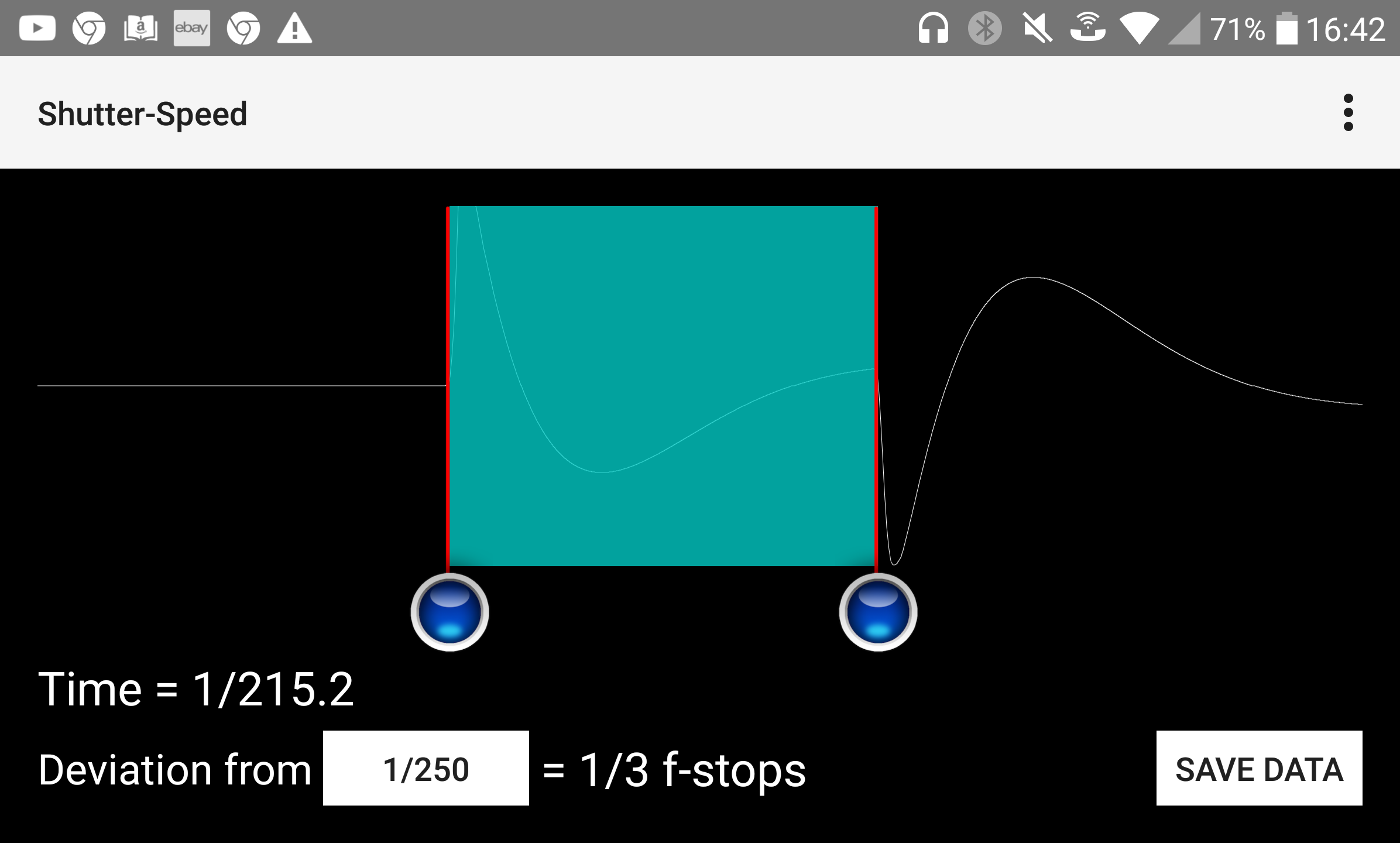

Couldn't find it in a search but am hoping this is an issue with a known fix. I just got a photoplug to check shutter speed accuracy and am filling the app's database on my cellphone with all my cameras. Everything was going smoothly until I got to my F3HP.
All of the slower shutter speeds from 8 seconds through 1/60 are dead on accurate, flawless. BUT, every setting beyond that, from 1/125 to 1/2000, is exactly 1/65 sec. I thought it was interesting that they were all exactly 1/65, not 1/60, don't know if that has any significance.
The batteries were only a year old with light use but I put fresh ones in anyway and still the same thing. I bought the camera a year ago from Keh in "Ex" condition, and have only used it a handful of times at slowish speeds, so I'm not sure if it's a recent problem or if it's always done this. Kinda wishing I thought of checking the faster shutter speeds when I bought it before the warranty was up. I know it isn't the photoplug because I tested 10 other cameras at the same time with no problems. Thoughts?

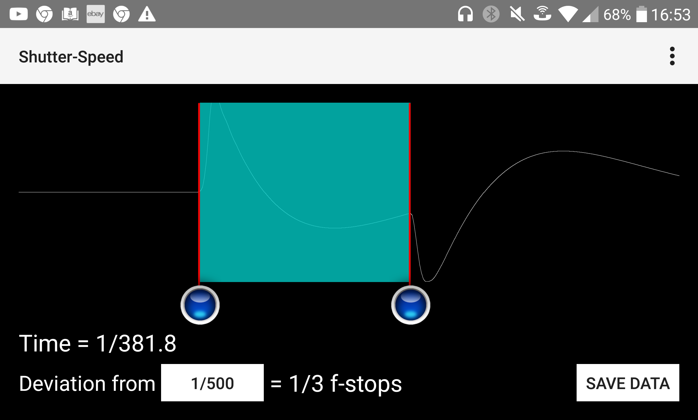

Ahh, crap. I completely forgot that it defaults to mechanical speed on the first few shots before you get to 1. I even remember hearing that before. Interesting though that slower speeds all work fine. Pretty sure that's it, thanks a lot guys.
Christophoto
Aug 5, 2016
77
Maple Valley, WA
And I'm back in business. Thanks again guys, thought my camera was broken for a bit there. It's a third to a half stop slow at faster shutter speeds, and I suspect 1/2000 is highly optimistic, but no biggie.
