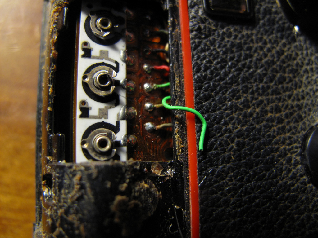

Mystery solved:
That green wire is supposed to be connected to the switch....
Such an easy fix, such an impossible place to get to.

Ya gotta wonder how it got flexed to such an extent that it broke like that -- I'm assuming Nikon didn't let it out of the factory that way!
trythis
trythis
Sep 26, 2013
1,208
St Louis
Yeah, there isnt really any opportunity for it to move inside the body at all. I am wondering if the previous owner had it pulled by a technician because it was acting weird, but I would think they would have gone about it differently. The camera has been serviced and it was owned by a reporter (supposedly) and its possible it was damaged while being serviced. I think that is most likely the case, now that I write this.

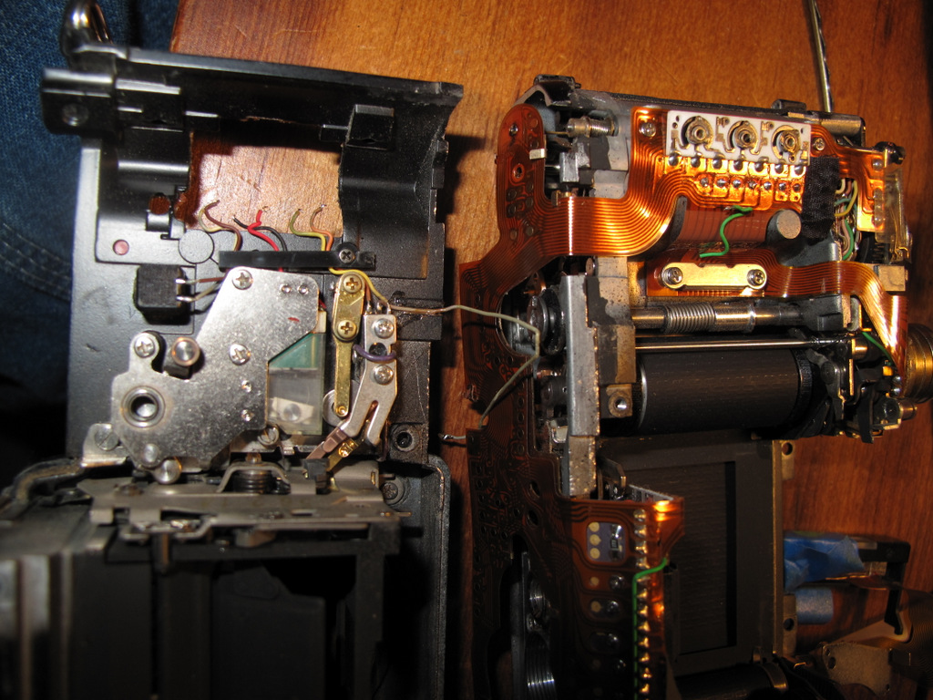

Nearly there, lots of unneeded steps in the repair manual to get to this point. Most of it is de-soldering.
I haven't broken or lost any parts yet, so there is hope!
I am thinking of doing just a tiny bit of cleaning the dust off a few places, but I dont want to do too much.
I am surprised to see fabric ribbons used with the metal shutter.

Just in case there are lots of lurkers wringing their hands, hoping I will fail or succeed, I fixed it!
Its all back together and everything seems to be completely functional.
Its also a lot cleaner inside and out. There was a lot of grit all through the camera. now there is no grinding noise when rotating the aperture ring and the winding lever is smooth.
I did break the aperture ring string in the process...:blink:
