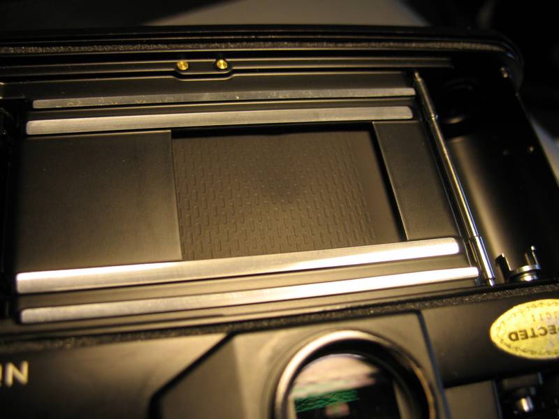

The second curtain of an F3 that I just received (no films shot yet, not by me at least) shows a small depression. Is this something to worry about? Or quite normal for an F3? I have no experience with these cameras at all. Thanks, Sander

It's not normal but it should still work normally.

I wouldn't worry about that at all unless it is obviously interfering with shutter operation.
I've had a few Nikon F's that had a slightly more severe dent/crinkle with no ill effects.
Make sure you keep your thumbs away from the film gate anytime you have the back open to prevent this type of damage in the future.

Thumb print. :sad: Should be ok tho. My original F that I bought 45 years ago and well used at the time, had two sharper creases in the curtain, well, 45 years later, it is still working just fine, complete with the creases.

I'll just add to what others have said - your new F3 appears to be just fine; it appears that someone has accidentally put their thumb against the shutter when inserting or removing film, though without actually doing any damage to the (Tougher than one would think!) shutter curtain.
Mine, too has got a mark like that - put there as I was loading the 2nd roll of film (as shot by me, that is) into it. Still works a charm, some 19 years and 650+ rolls later.

Thanks guys, I've never asked a question here that got such a consistent set of replies! So that's really comforting.
"Thumb print", never heard that one before. I know cloth shutters and metal ones- the F3 seems to be somewhere in between (?): sort of kinkable, but looks breakable as well.

F3 shutter is titanium foil.

Along with it's predecessors, the F2 and F. They are in fact very durable, designed to last at least 150,000 frames.

Hummm, that honestly looks like my old F3 I sold 5 years ago, same depression, same place. By any chance does it have a small dent on the top of the finder?

Haha, this thumbprint is more common that you would think.
I choked in the heat of the moment on an assignment once when I was green and put my thumb through an Fm2 shutter. :blink:
Luckily I had a backup body.

This happens, probably with someone less experienced with loading or when loading IR film in a bag or in the dark. I wouldnt worry unless you see it rub or see marks of rubbing on the raised bumps. Test it by going through the faster speeds with some film.

Unfortunately mine happened when I had the camera hanging around my neck while loading film. I had the back open, camera facing lens down about to load when the film canister slipped from my hand and landed dead centre on the shutter. It looked bad, but everything worked fine, no light leaks or any issues since.

It's a small thing. Most probably works fine. Shoot a roll and decide
