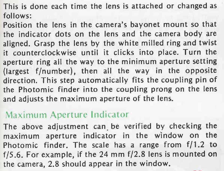

Chances are you probably already know this, but I'll ask anyway: when you mount the lenses, are you twisting the aperture ring from max to min and back? When done correctly, the max aperture will appear in the metering head's window. If you don't do this, readings will be incorrect.
I'm familiar with the Nikkormat FT-N lens mount shuffle but the process with these F2 seems a little different from that for the Nikkormat FT-N.
With the Nikkormat, I set the lens to f/5.6 and move the auto indexing prong on the body clockwise to the stop, mount the lens and rotate the aperture ring back and forth a couple times...then check the red dot.
With the F2 (DP-1 and DP-11) , ithe process Ive been folloing is slightly less involved....set the lens wide open, mount the lens and rotate the aperture ring back and forth a couple times...
I admit, I came up with this just by gut feel...I dind't know about or think about that little window on the front of the DP-1 / DP-11.
Am I doing it correctly ? (I'm at work so cannot check directly at the moment)

This is for the DP-2, but I assume it works the same for the DP-1.
The little window on the front of the prism has to show the max aperture of your lens eg 1.2. If it doesn't, then you are either mounting it incorrectly or there is an issue with it.
Got it. This'll be among the first think I play with / check when I get home tonight. :smile:
OK. Thanks. Given this, I'm pretty confident that what I did is correct.
