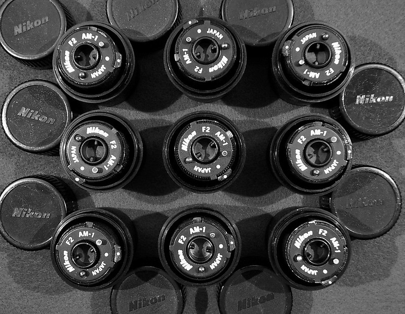

I know I can use standard cassettes, but I’d like to use the cassettes that open when the film door is closed so I wouldn’t have to worry about scratching the film. Nikon did make them, they’re the AM-1.

You're looking for AM-1 cassettes.
The nine reloadable AM-1 film cassettes seen in this image only works in the Nikon F2 SLR.
Nikon also made a reloadable film cassette that worked only in its rangefinder cameras and a reloadable film cassette that worked only in its Nikon F SLR.
I preferred rolling my own 35mm film cassettes using the metal felt-less Nikon AM-1 in my Nikon F2 35mm SLR. These reusable and durable cassettes do not have the felt light traps that are found in less expensive film cassettes. As a result, film is more likely to move faster and smoother as the motor drive pulls the film out of the cassette. Also, thin emulsion films are less likely to get scratched as they are pulled out of the cassette.
Nikon AM-1 Film Cassettes by Narsuitus, on Flickr

The AM-1 is marked AM-1 and has an F2 in white paint. Different mechanism than the earlier units.
I'm pretty sure the F2 cassette is AM-2. There were enough of 'em on ebay a couple yrs ago.
There are eight film cassettes in this image that are clearly marked AM-1. The AM-1 cassettes work in the Nikon F2 body but do not work in the original Nikon F body.
The one cassette in the middle of the image is the film cassette for the original Nikon F camera. It does not work in the Nikon F2 body.
Nikon F2 AM-1 Film Cassettes +1 by Narsuitus, on Flickr
