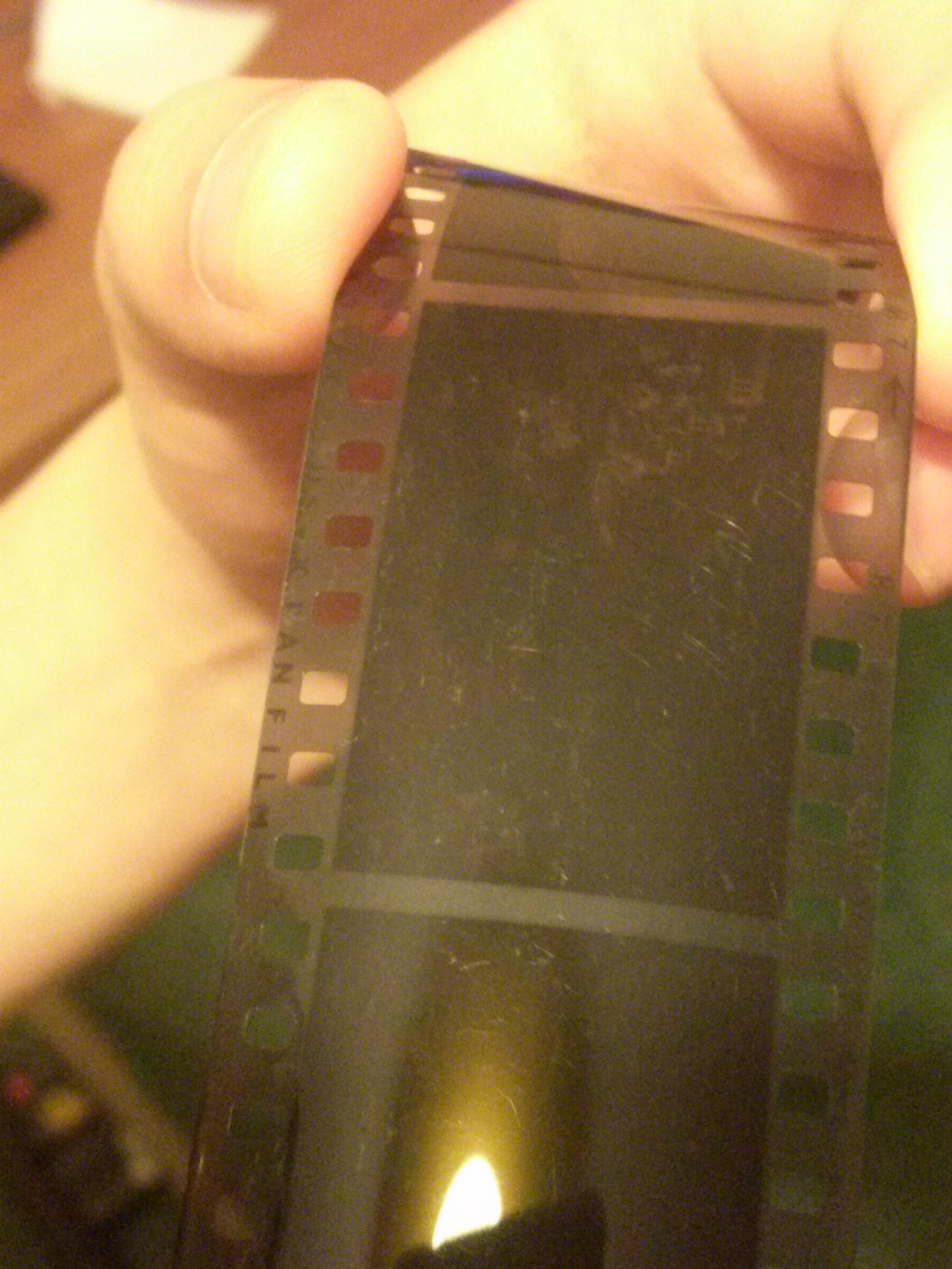

The scratches are on the shiney side, just developed some b/w film. They were a 40yr old bulk roll of Kodak Plus X 125 given to me but they have scratches on the shiney side but not the dull side. They are not uniform long lines but random scratch like marks. CLA? Used replacement? Replacement door?

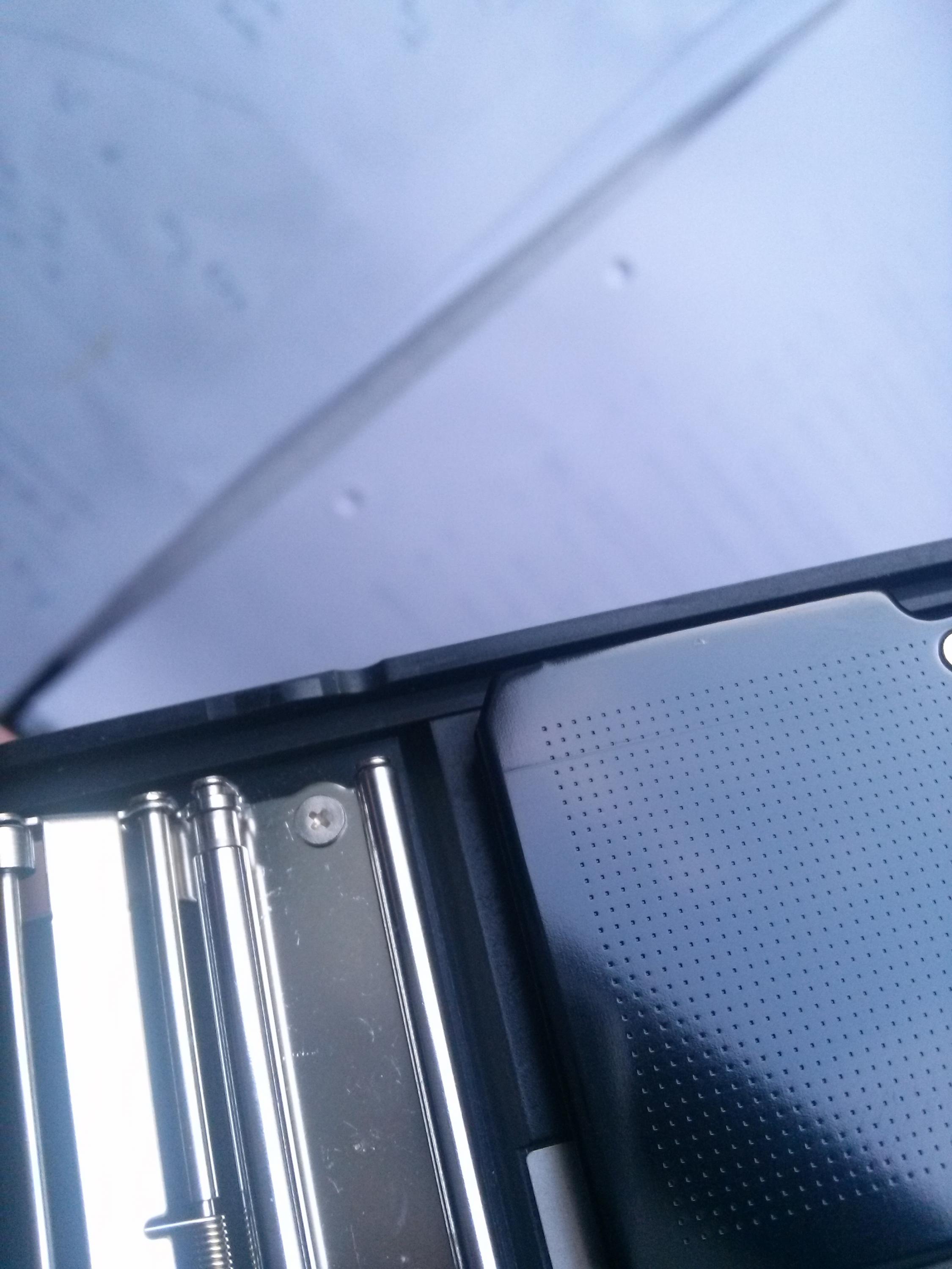

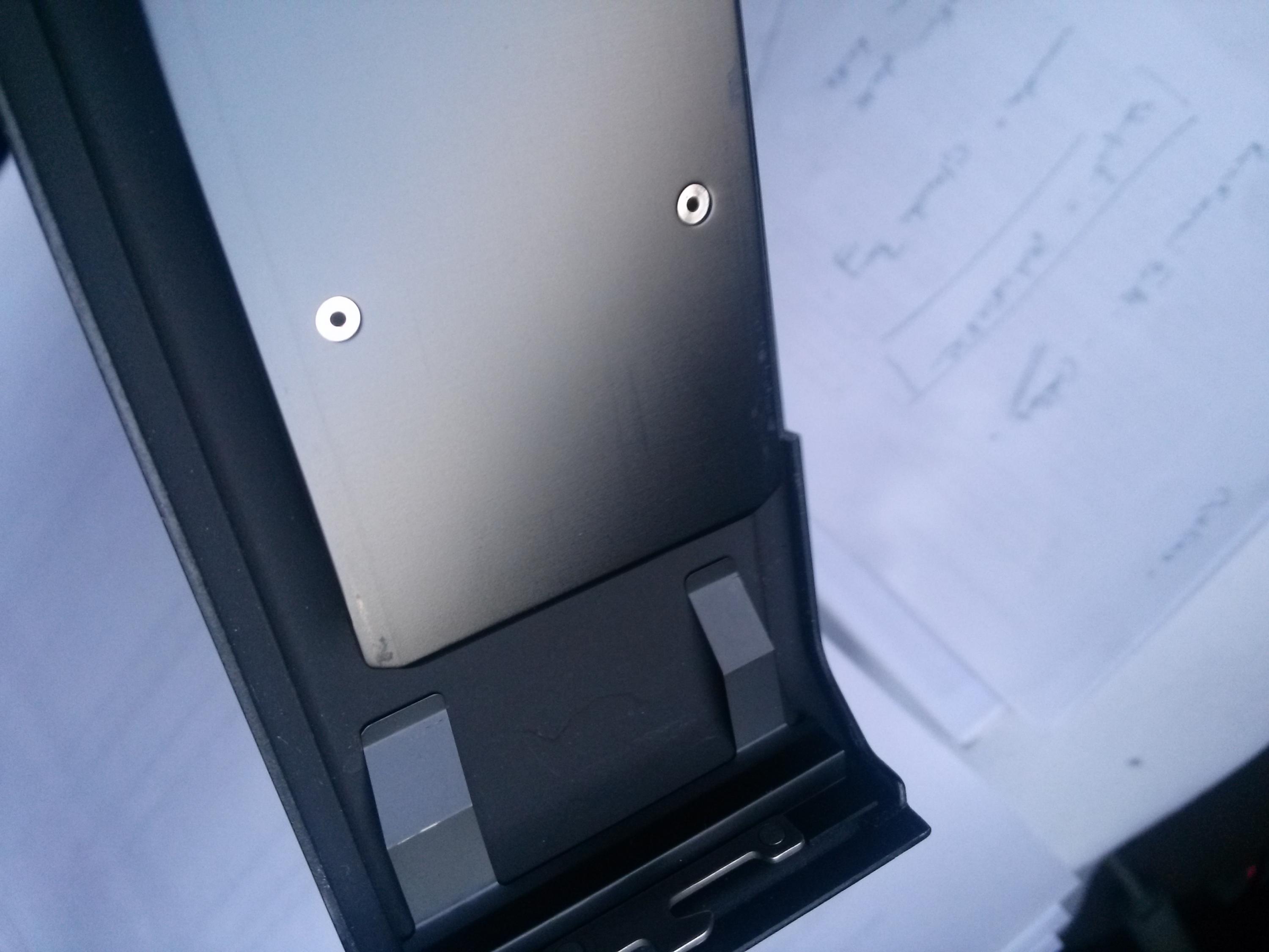

Here is a difficult photo of the pressure plate.

There are some scratches on the plate also. But I am not sure about it - there is a long horizontal line or two but what you might not be able to see is if you tilt it to the light you see kind of a kitchen scouring (steel wool) pot cleaner marks - as in circular rub marks.

Here is attached that old filmg given to me - looks like it is too random but I will shoot a commercial individual roll of B/W to check.

What you show in the picture looks more likely to be from general handling than something caused directly by the camera.
When you load film in the cameras do you cinch the film tightly, loosely, or not at all? That is yet another way of getting scratches (cinching too tightly).
