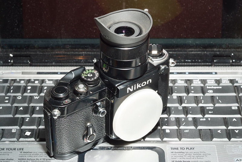

For critical focusing, I prefer the Nikon DW-2 6x Magnifier Finder as seen on my F2.
on F2 by Narsuitus, on Flickr

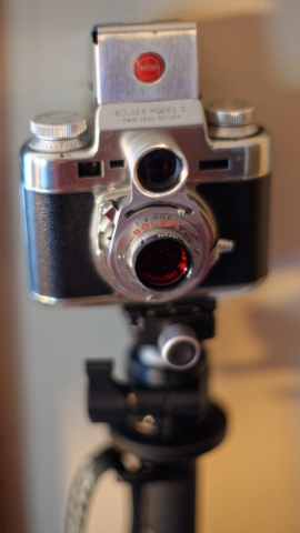

I'll shoot around with a Bolsey 35mm TLR with a monopod for a change of pace. Good for scale focusing, but you can slow down and get critical focus via the ground glass + magnifier if you really want. No issues seeing the ground glass image, but YMMV.

If you really want a 35mm with WLF how a Bolsey model C with duel focusing, WL and rangefinder. Never owned one, but collectors say it take a pretty good picture.
