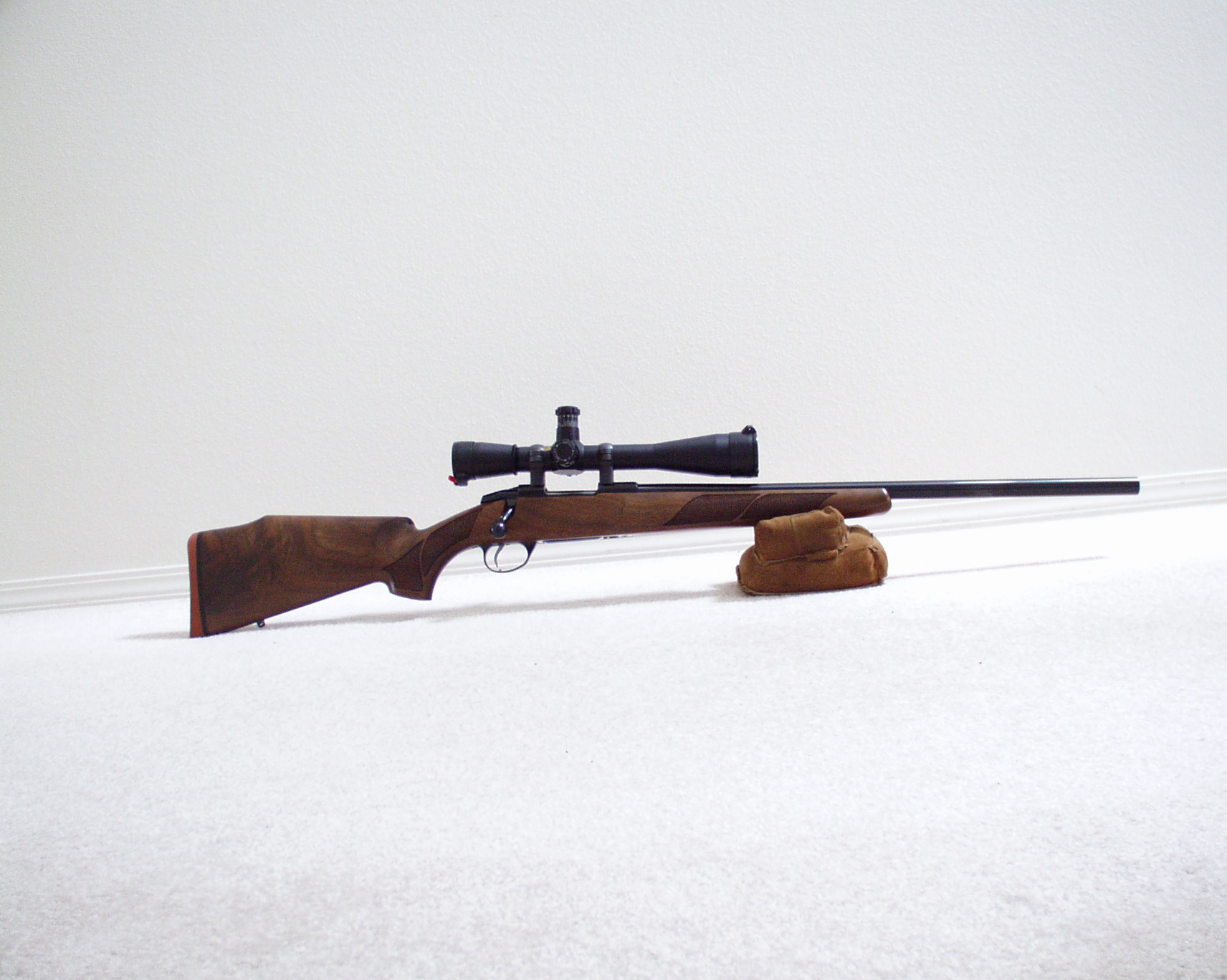

Is the Sako .222 Remington or .222 Remington Magnum? The latter is a pretty rare caliber, but I know Sako made them.
Sako 75 Varmint in .222 Remington. Bought it new in 1998. Leupold Mk. IV 16x scope with mil dot reticle by Premier.
