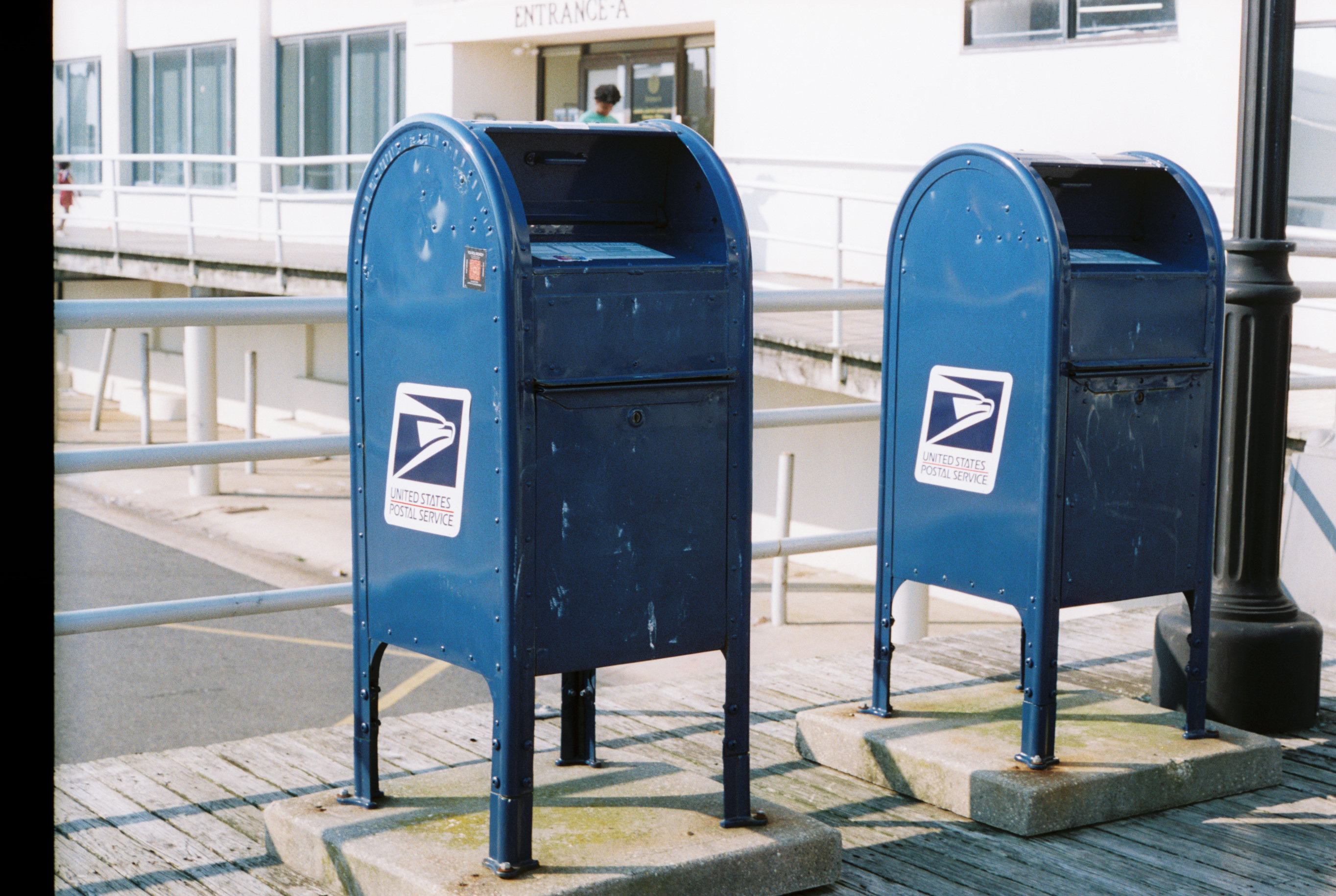

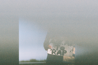

So first few exposures of the roll are like the mailbox picture and middle 30 exposures are like the unclear one just as a reference. Thanks everyone - I know this is dumb shit I’m asking but I’d really like to use this camera.

The problem frame looks like a light leak or maybe some weird shutter curtain problem, not overexposure due to a sticky aperture.
Show us a picture of the negatives so we can see whether there is light outside the frame. Is the pattern of extra light similar in all the bad frames?
That first picture doesn't look like an overexposure problem -- it looks like fogged film or a light leak. Look at the negatives -- does the fogging (which should show up as a dark patch) only exist in the frame, with clear sprockets and visible edge writing, or does the fogging extend outside the frame to the sprockets? If the latter, the film was exposed to light -- it could be a light leak but it may also be that something went wrong in the lab. (If the former, it could be a shutter curtain problem, but it doesn't look like that.)

If that leak does not extend outside the frame in the negative, then it is most likely light leaking through the viewfinder. Else, it is the light seals from the back door. Can you post a shot of the negative, the part of the strip with that frame?

I do not think the problem is overexposure. It looked like light leak somewhere. However using a Pre AI lens can cause the EM to exposure wrongly. The shutter speed on the EM can not be seict manually so you always have to rely on the meter. The meter coupling either not touch the lens at all in which case the camera would think that you always shoot at mininum aperture. It may touch the coupling and moves it but in an erratic way. This is bad as it can damages the coupling.
