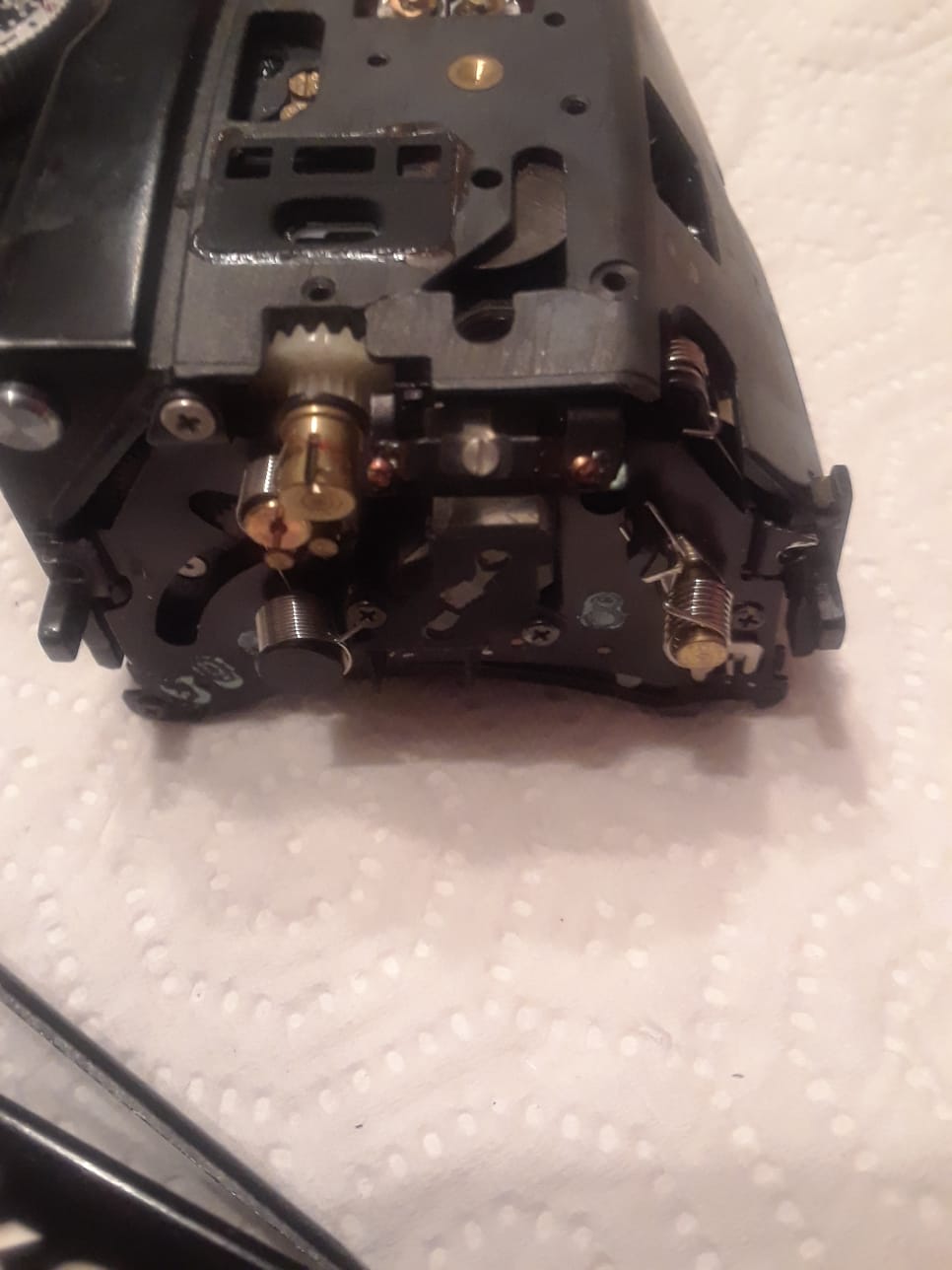

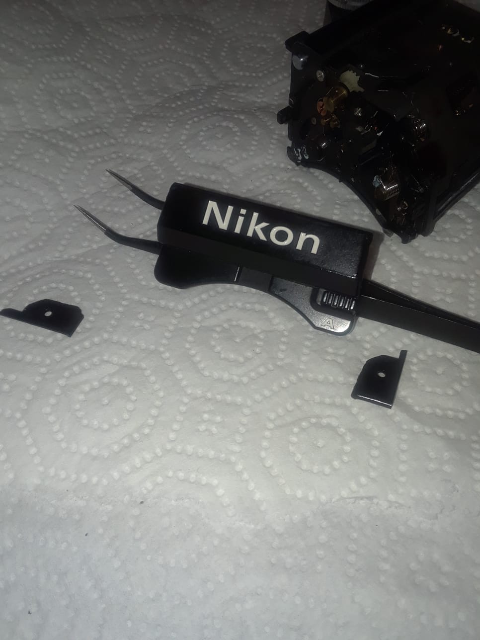

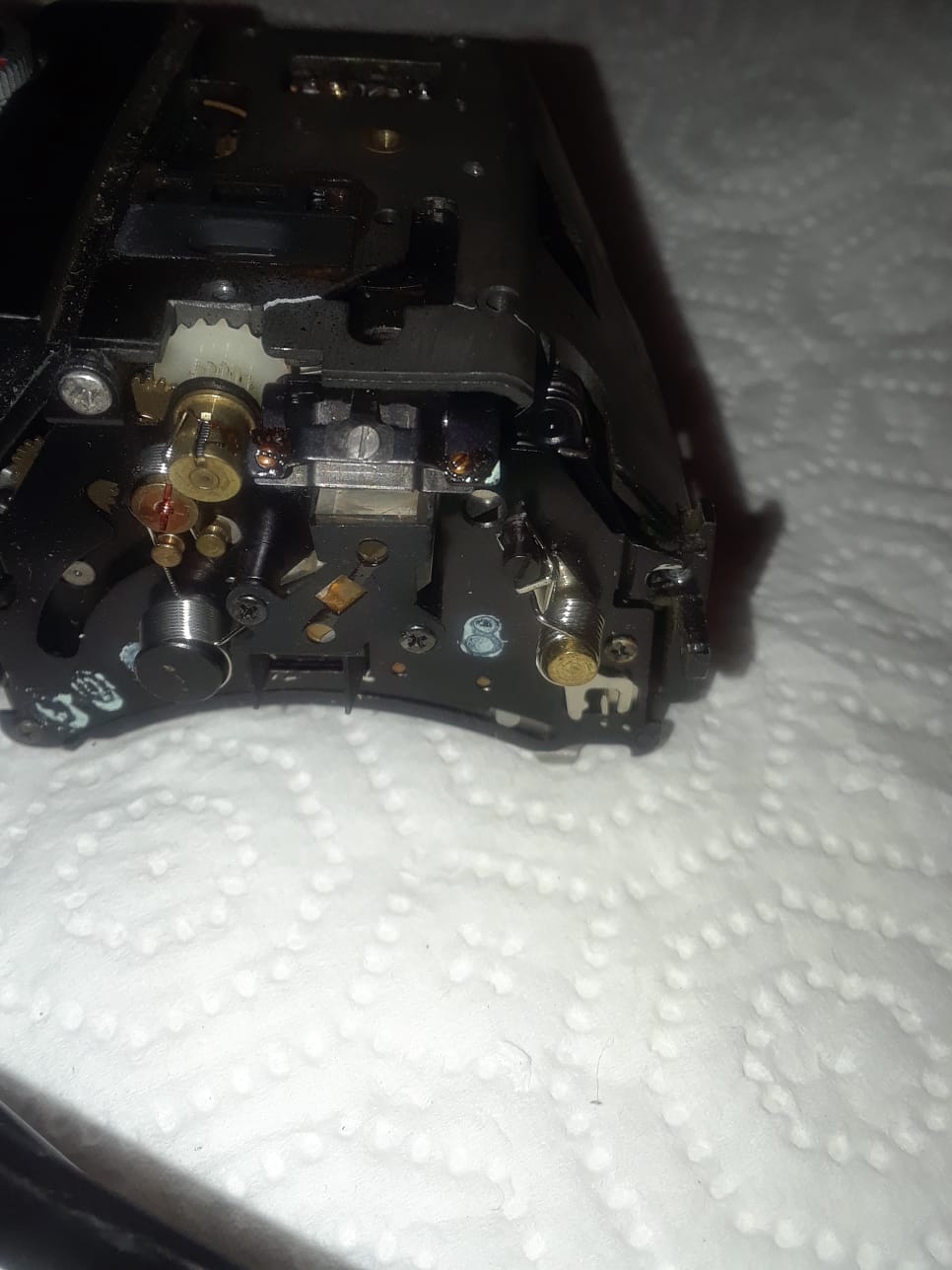

I have been using my father's Nikon F2 with DP-11 viewfinder for the past 5 years. After a 6 months hiatus, I took my camera out for a street shooting a week ago, but as soon as I took the camera out of the case, the viewfinder plastic cover (where it says "Nikon" in white) immediately snapped into 3 pieces.
I took the DP-11 apart to see what had happened, and I could just get the plastic cover glued or fixed. But when I unscrewed it, I found out a very bad news: in the past 6 months, the camera must have fallen or something, but I can see a big shock on the top of the viewfinder that broke the metal inside. I am not sure if this has an impact on the function of the viewfinder yet, it seems alright to me and to appropriately adjust the controls, but that's not so great.... I am attaching pictures of the damage.
Any wisdom about whether this can be repaired and how to repair it myself (if possible), or if there's a quick fix for that, would be greatly appreciated.

In the third photo, it appears that the cast aluminum case is broken. If that is the case, then it is very much not feasible to repair it....at least not properly. You can easily buy another DP-11 or DP-1 on ebay for not a lot of money. Someone here might even have one they would not mind parting with. However, finding one with an accurate meter might be more difficult and expensive. Good luck and welcome!
Thank you so much for your answers! Well that's what I thought, this damage seems beyond repair... But I am still not sure if that affected the function of the viewfinder, I did not see anything not working as it should yet. I'll give it a film and test it.
