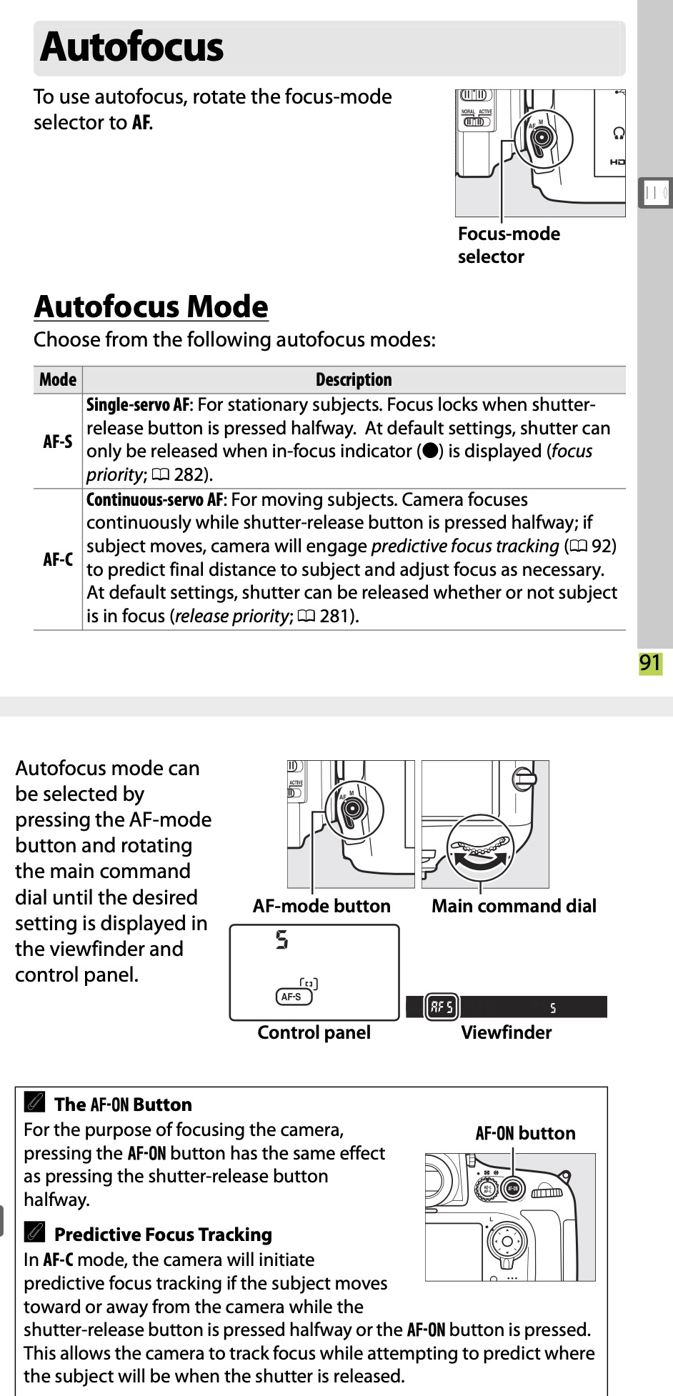

Unless you are misstating your issue with the D800, there are two settings for autofocus. Single and continuous--they are set with the wheel. Page 91 0f the manual:

The way I read it in the manual was to set the AF/manual switch to AF, then holding in the central button on the switch, (to be honest I had not noticed it was there) turn the main command dial on the top rear of the camera until the letter 'S' appears in the window on the top.
