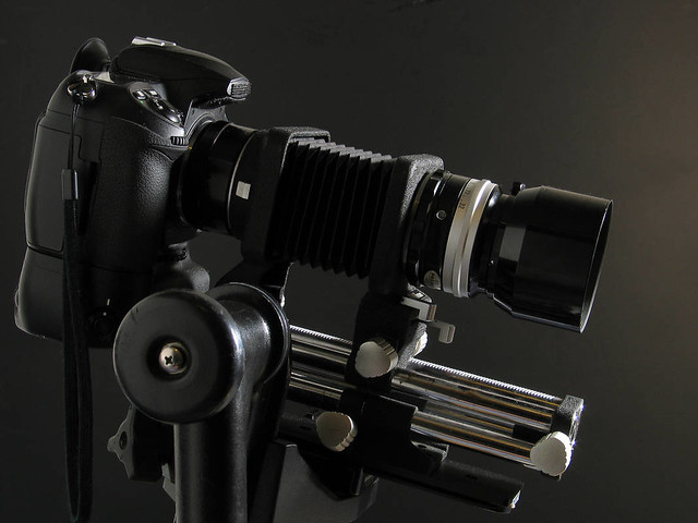

I have used my PB-4 on my F, F2, F3, F4, and EM Nikon film cameras. I use a DW-2 6x magnifier finder on the F2. I sometimes use a Nikon DG-2 eyepiece magnifier on the other bodies.
I have also used my PB-4 on DX bodies but I had to use an M2 extension tube between the bellow and the DX body in order to provide enough clearance between the handgrip and the bellows. In this configuration, I lost the ability to infinity focus but that was no loss because I used this setup for close-ups and macro—not for focusing on infinity.
Nikon Close-up by Narsuitus, on Flickr
