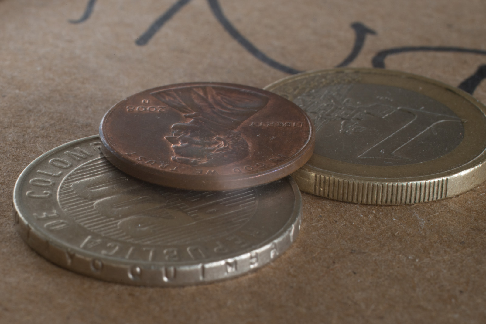

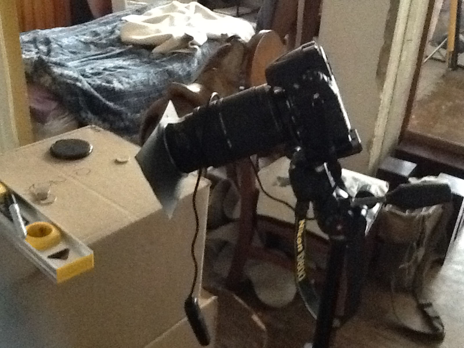

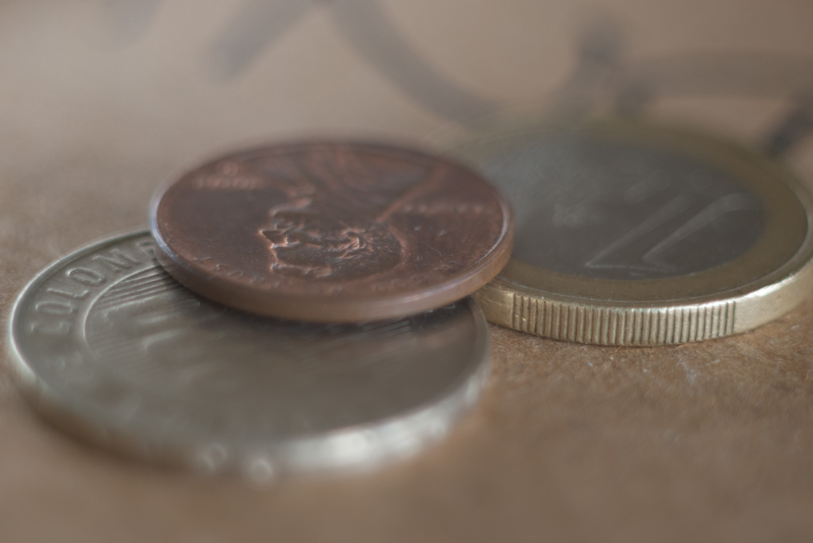

SKEPTICAL!! Luckily, I did myself "the favor" and I'm now sharing the result. The first picture was taken with the lens wide open, while the second one had a cheap piece of cardboard with a hole of approximately 4.5mm diameter. The third picture is just the setup taken with an ipad. I think this fast experiment delivers very good results, any suggestions? Imagine that if this works with lens caps, they could be painted white and avoid almost any reflections, even the ones from the lens, in jewellery photography or other kinds of products.

Well, I'll have to say that I'm quite surprised by the results. As your pictures show, the vignetting seems to be non-existent despite the fact that the "aperture" is not in the optical center of the lens. Unless you removed the vignetting in Lightroom. :whistling: Good for you! But a D800 .. on APUG .. naughty boy! :D (I don't care)
aca91
Jun 16, 2009
62
You have my word that I didn't touch them on lightroom, as for the D800 I agree it's out of place, but this is about optics that could be used with any Nikon body :smile: . Now, back to the topic, with this kind of magnification, what would you do? Maybe drill an equivalent to an f/32 to get an f/64 with the teleconverter, or an f/45 to get an f/90?
