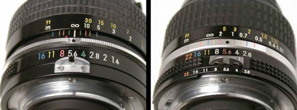

Gents that lens is not AI that is clear from the photographs. There is no ADR scale and it does not have the cut outs. Also the serial number will tell you if it is AI or not. Not being AI does not mean it will not mount on your D90 , it means that you stand a chance of breaking your D90, I have seen people do it before. I have looked at these photos several times now and I do not see the AI relief cuts in the ring. This appears to be a late production NON AI lens probably 1975 or 1976

Not that it matters much, but that doesn't appear to be AI converted to me. In the pic below you can see a non-ai on the left, AI on the right. Yours looks exactly like the non-ai. :cool:

Sorry about that then, my lens is like the non-ai from your picture Eurekaiv.
Though the back mount has 5 screws in it and everything else that would suggest it's a AI. See this website: http://rick_oleson.tripod.com/index-153.html but I don't have a ridge on it described in #4 on that site.
When mounting it to my D90, the aperture ring is a bit harder (still very easy to turn) to turn cause it's closer to the camera. Off-camera that ring works fine.
