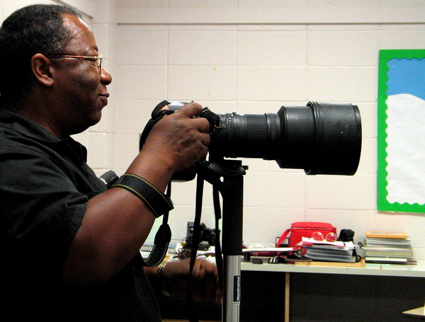

But both of those are about four or five times more money than I've ever spent on a monopod. I use a good sturdy Manfrotto/Bogen, and it supports an older 400 2.8, about the same weight as the 800 5.6 you are talking about. (Personally, I don't 'get' the attraction to Gitzos and their twist tightening systems, especially if you are going to be adjusting the height often - and some of their monopods have not 3 but 4 (or 5, like the GM5561T) sections to deal with).

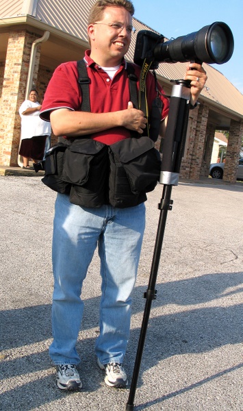

I'm very partial to Gitzo carbon fiber monopods, when used at ~80 - 85 % total length, they can be very solid. I have a Bogen tilt head on my Gitzo. It adds maybe three inches total to the length, not much mass and is very solid, too. Best of all, though, the monopod can now be folded along the length of the lens making carrying by a lens strap pretty comfortable without the obtrusion of a monopod extending at right angles to the lens.

For some time I used a 600 f5.6 ais coupled with an F3 and motordrive, this was on top of a Manfrotto 334B.
I know this is a smaller unit, but the best part of that monopod, is the pistol grip adjuster directly under the top of the monopod.
