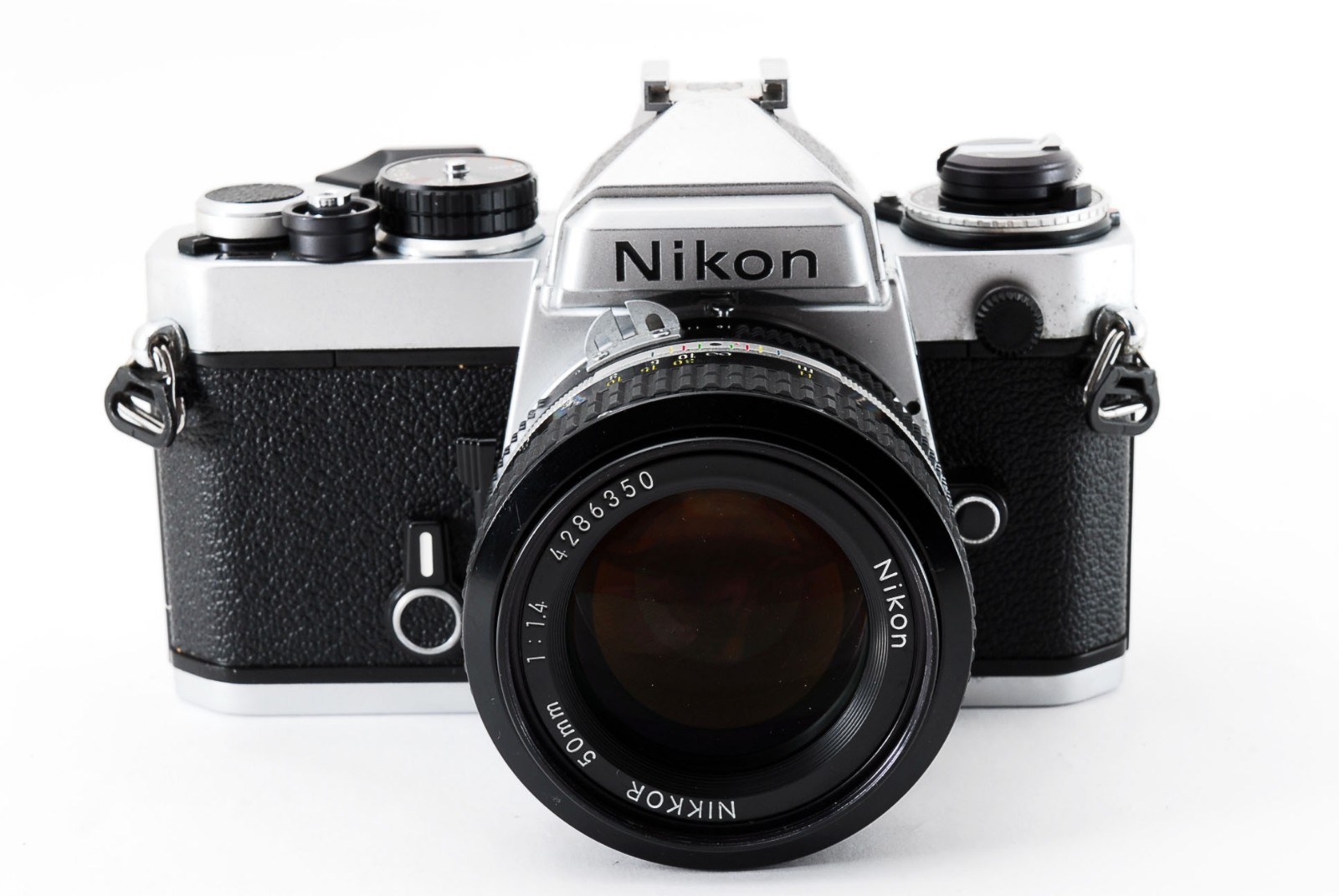

Would someone be able to confirm that this is indeed an AI/AIS lens that will meter (produce a light meter reading) on a Nikon FE? Thanks!

Nope - I'm sure it's a regular Nikkor 50mm f/1.4 ai. The ai-s versions starting with series nos 5100001 and the engraved apperture number f/16 should be in orange (not blue like the one above).

You're probably right (though I never saw a 50mm f/1.4 ai with the f/16 in orange).

Well, I think it has been pointed out to everyone's satisfaction that the lens pictured is indeed an AI lens. But I would like to address the OP's actual question. He was unsure of the meter coupling method, such that he was unable to identify what makes an AI meter coupling method an AI meter coupling method -- and after all, an AIs lens has just only a few slight changes to the original -- those that can be seen, at any rate. So anyway, it should be pointed out that in order to determine an AI or AIs meter coupling style, one must observe the longish curved tab attached to the aperture ring, which slightly overlaps the mount, and which couples to a tab on the camera that moves in a concentric manner. It is this longish tab on the aperture ring that is essentially what makes an AI lens an AI lens. A way of emphasizing this is pointing to an older pre-AI lens that has had its original aperture ring replaced with one made by Nikon specifically as an upgrade for that lens. Once that aperture ring is installed the lens has been "AI'd by Nikon."
