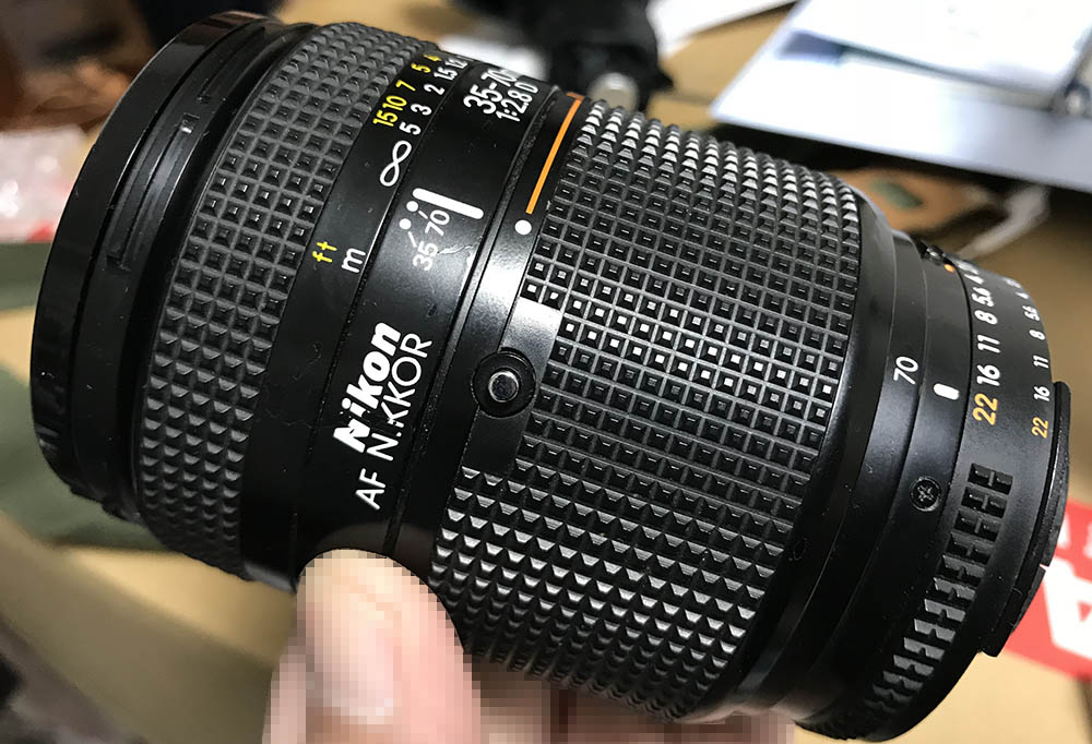

Recently I picked up an AF-Nikkor 35-70mm 1:2.8 D lens. it was an absolute bargain, in fine physical shape with clean glass. However, the zoom function only goes from 35mm-50mm. And while the macro button on the zoom ring can be depressed, it will not turn to the 'macro' position. There is no physical damage or wear to suggest that it has been dropped- although that is the most likely scenario.
Does anyone have any experience or insight on this? And/or experience with this lens? If it's worthwhile to do so, I'll send it to Nippon Photo Clinic for repair. But I don't want to "throw good money after bad".
It could be that bearings in the zoom mechanism have broken and are blocking it.
Similar here
This zoom lens often has clouding issues, which may not be remedied. A check with the LED light will provide some insight.

Per Andreas Thaler's comment (thank you sir), I shone a light through the lens- there is some obvious haze. So it's likely a paperweight.
But I'd forgotten that there is a Nikon dealer/repair shop here in Tucson. When next I go that way I'll show it to them; if they say it's not worth repairing, I'll donate it to them for parts.
