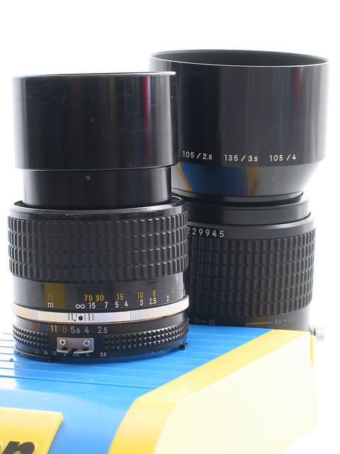

I do not know if it is a common problem but I bought a 105mm f/2.5 AIS Nikkor that had a similar problem. I purchased it at a discount because of the problem. It cost me more to repair the lens than I paid for the lens.
Nikon 105mm Lenses
by Narsuitus, on Flickr
