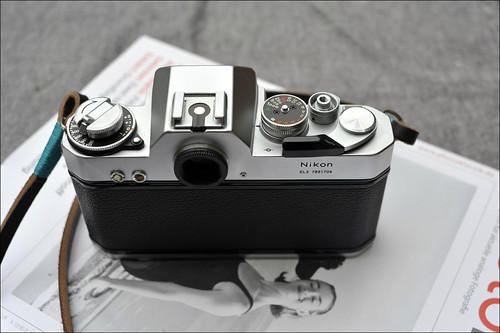

I had a Nikon F that developed (Photomic) metering problems. My partner has a Nikkormat FTN of the same vintage as the F (which I sold) and has never had any metering problems even with the battery replacement issue which to my mind is only a minor irritation and easy to work around. My FT2s and ELs still meter perfectly. Many have criticised the ELs for being "mindlessly electronic" but mine just go on working.

The EL2 and FT3 are the only models I can recommend given their age and complexity.
