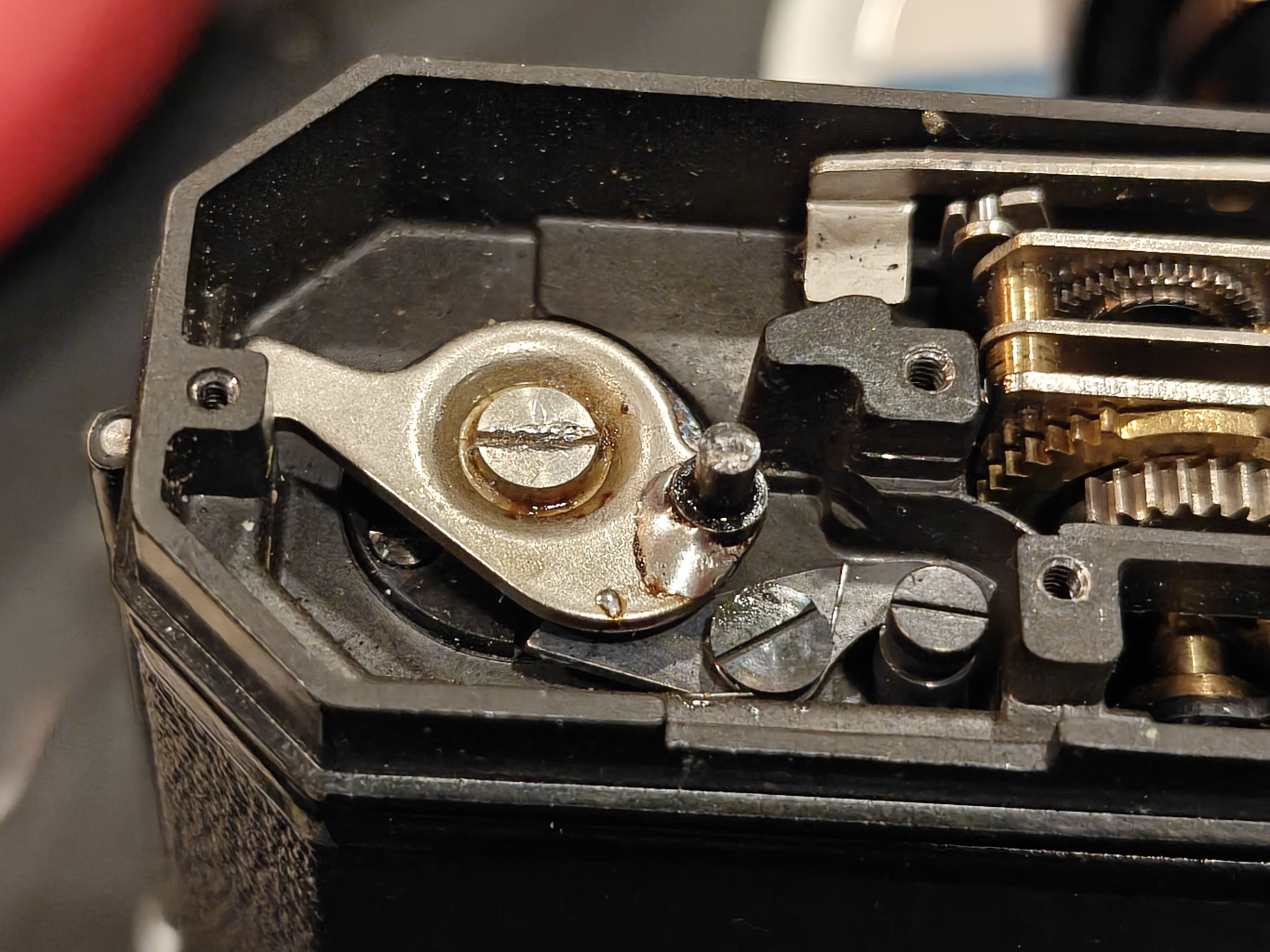

So I haven't pulled apart an FT, but in my FTN I experienced the same issues after the pin on the cam in the winding assembly came loose. It's peened in originally and mine popped out of the cam. I reseated the pin, soldered it into place, and retimed the winding arm which worked out nicely
Is that a pin present in the bottom?

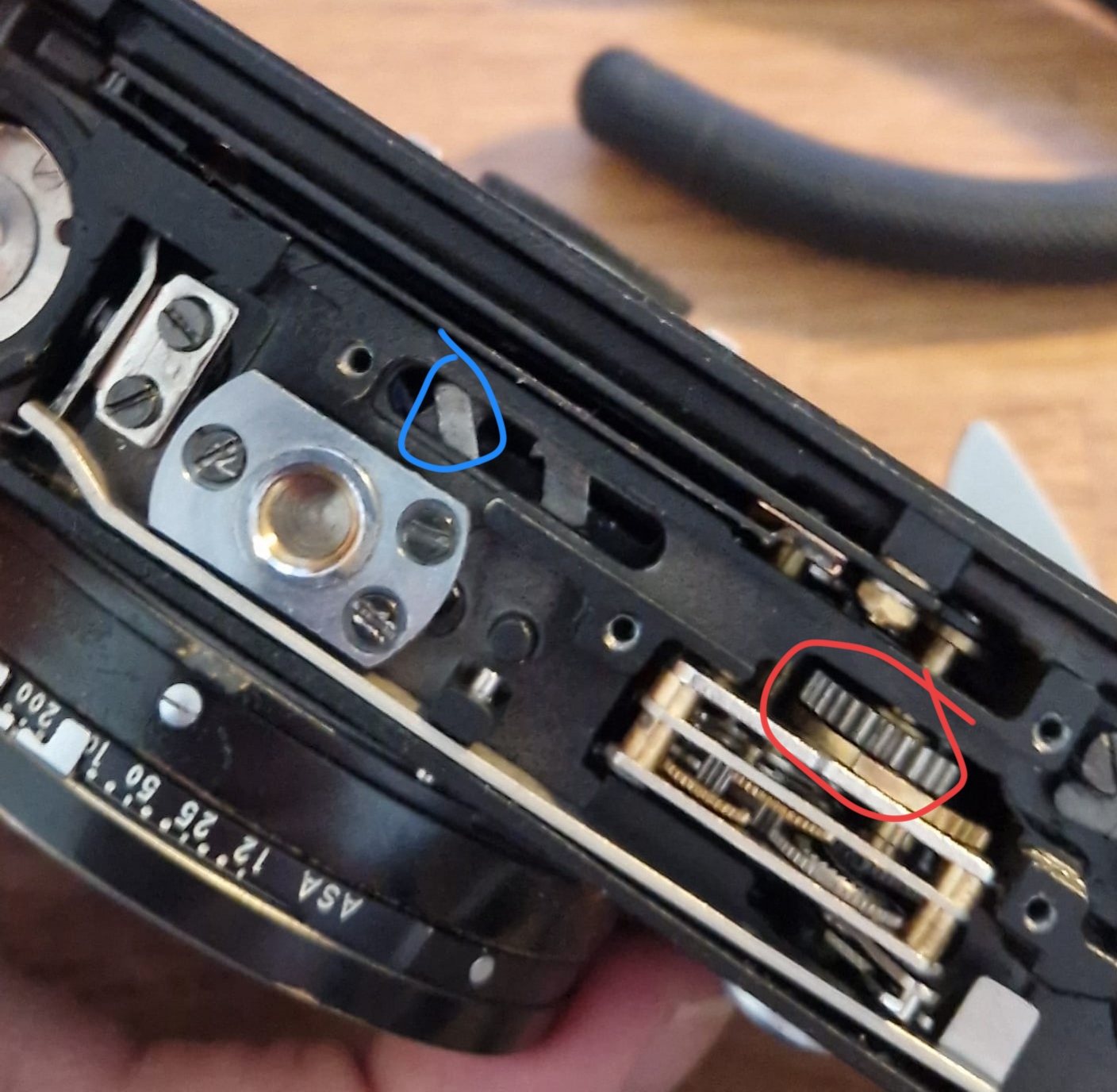

Sorry, totally missed this before. Yeah, the pin is on the winding cam, I've included a photo of mine post-repair.
I'll also note that I had a tricky time getting the brass rack reinstalled in the correct timing. The pinion I circled in red has a bit of backlash in it and it has to be set right up to where it begins winding the shutter before installing the rack, otherwise the shutter doesn't wind correctly.
The lever I circled in blue also has to be in the correct place so it ends up on the winder side of the pin on the rack that winds it. I accidentally installed the rack incorrectly the first time I reassembled it and ended up with that lever not getting cocked.

Thanks! I put the red gear towards the winder before assembling and now it locks in place properly! The issue seems to be the shutter not going back into the original position completely. I'm going to attempt a little more cleaning of residue to see if that fixes it.
