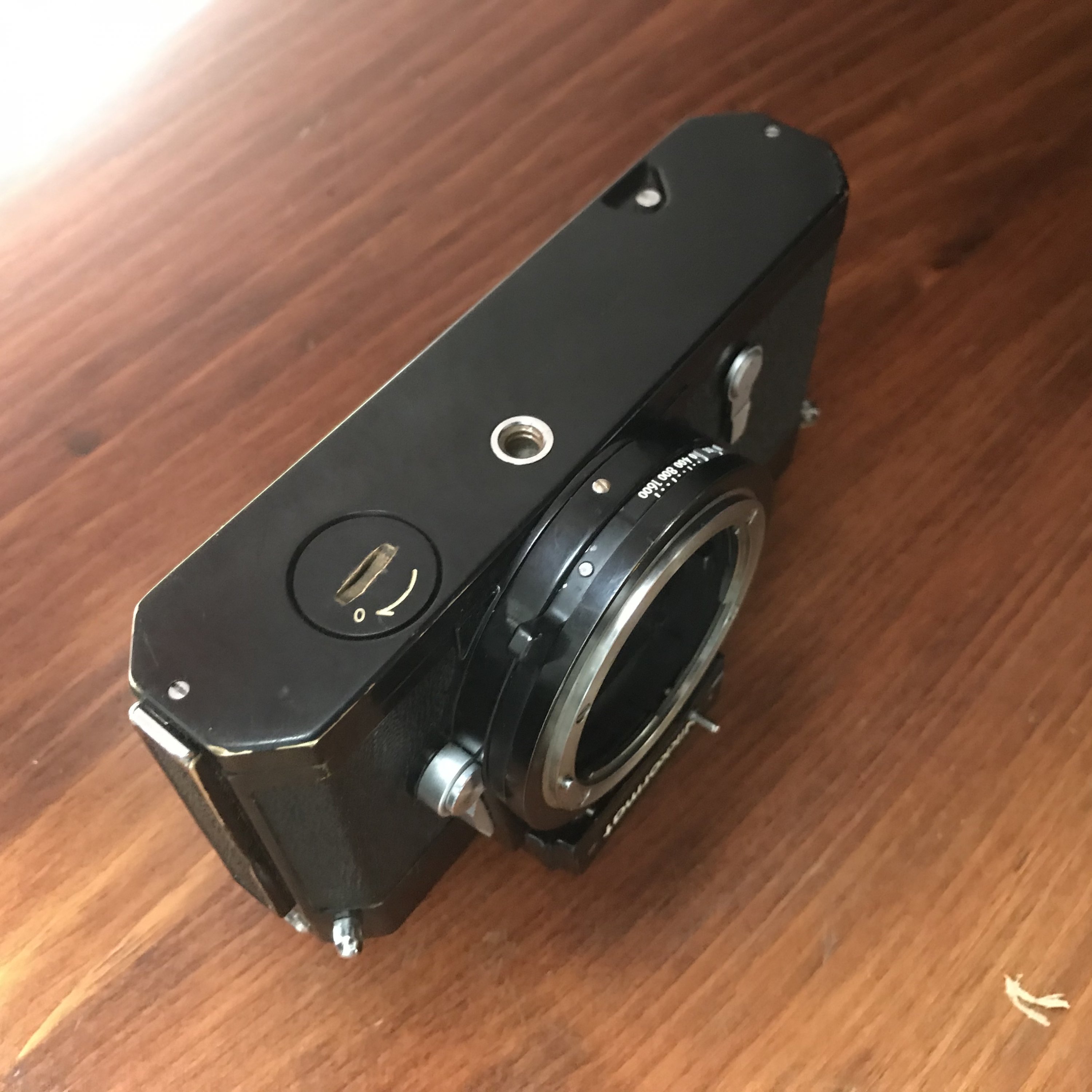

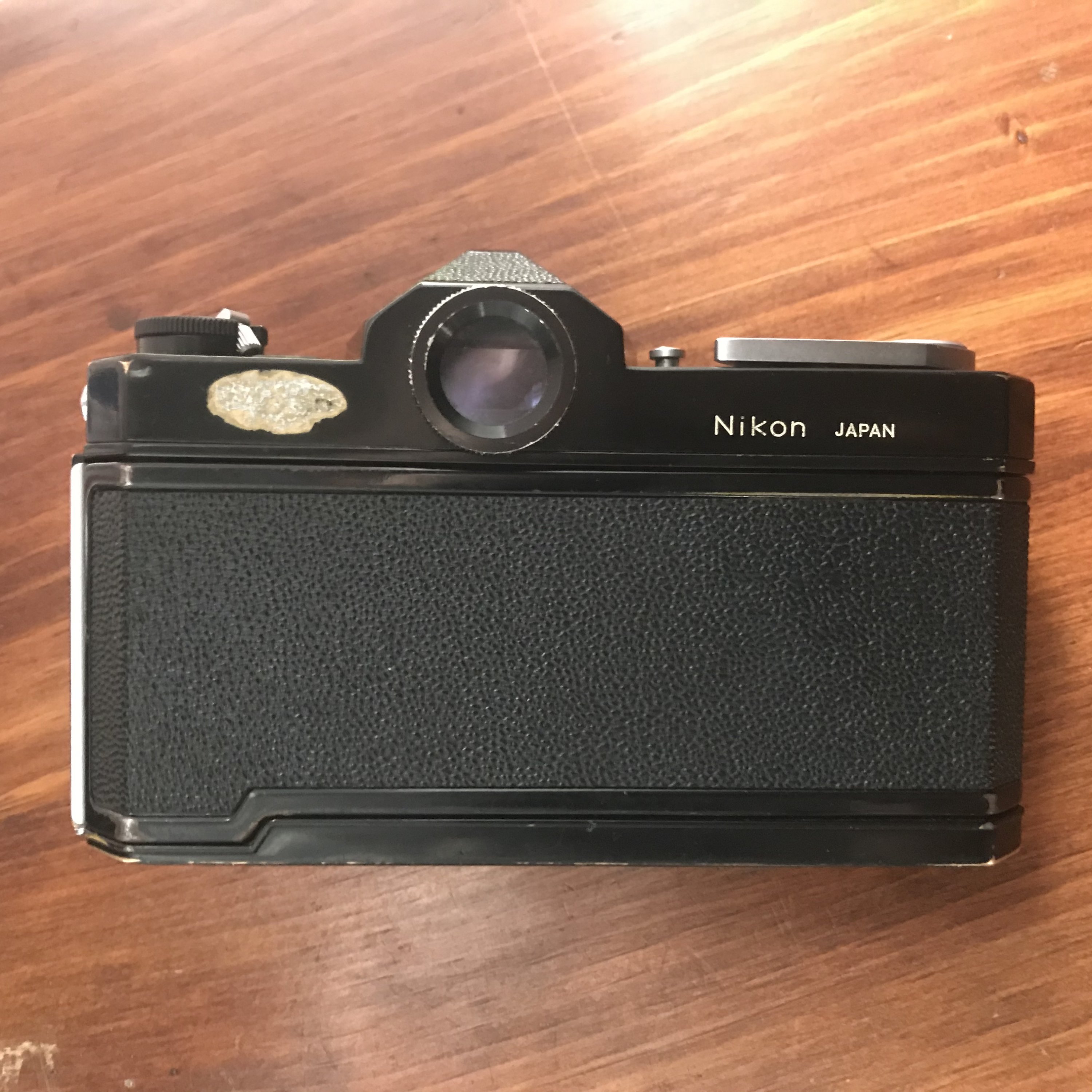

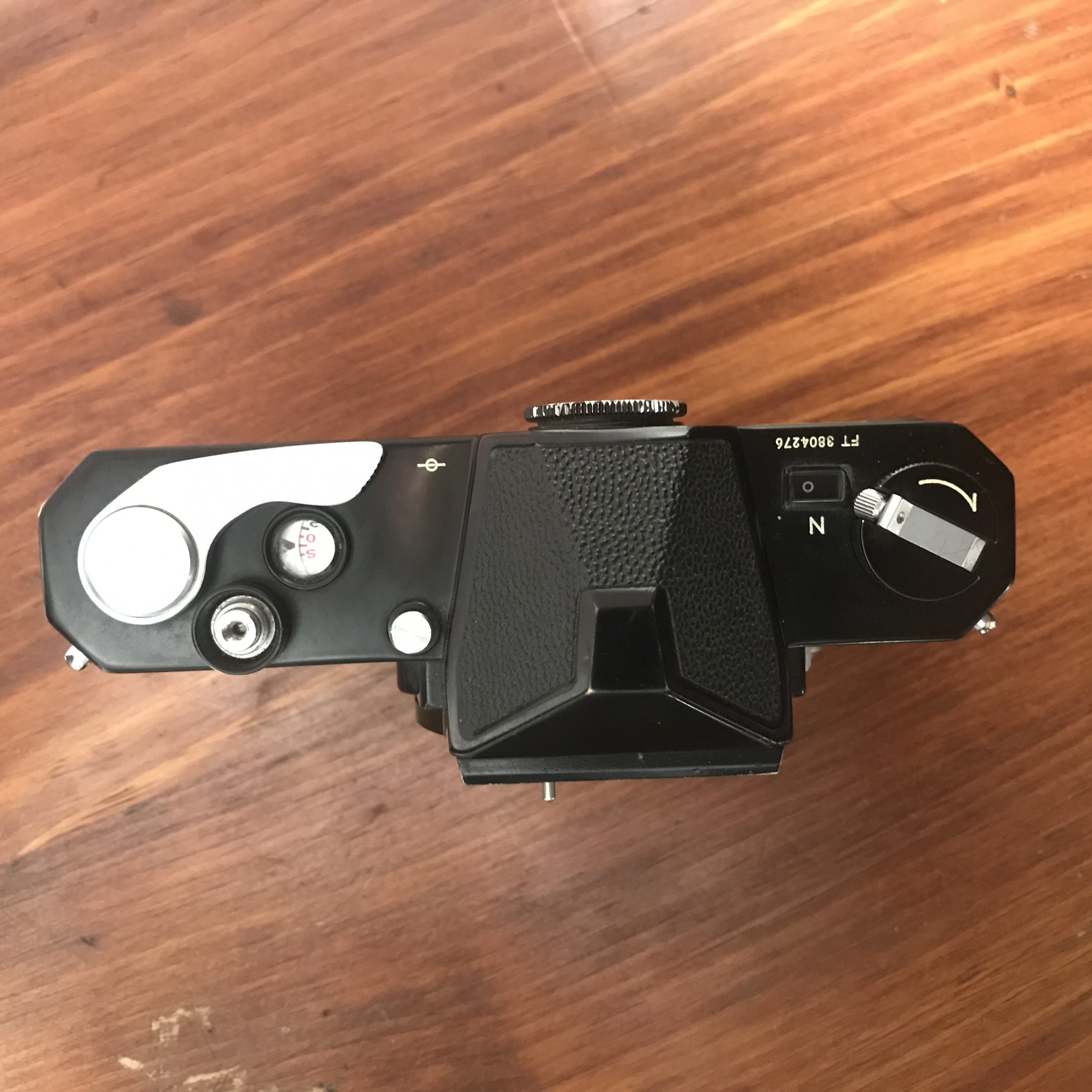

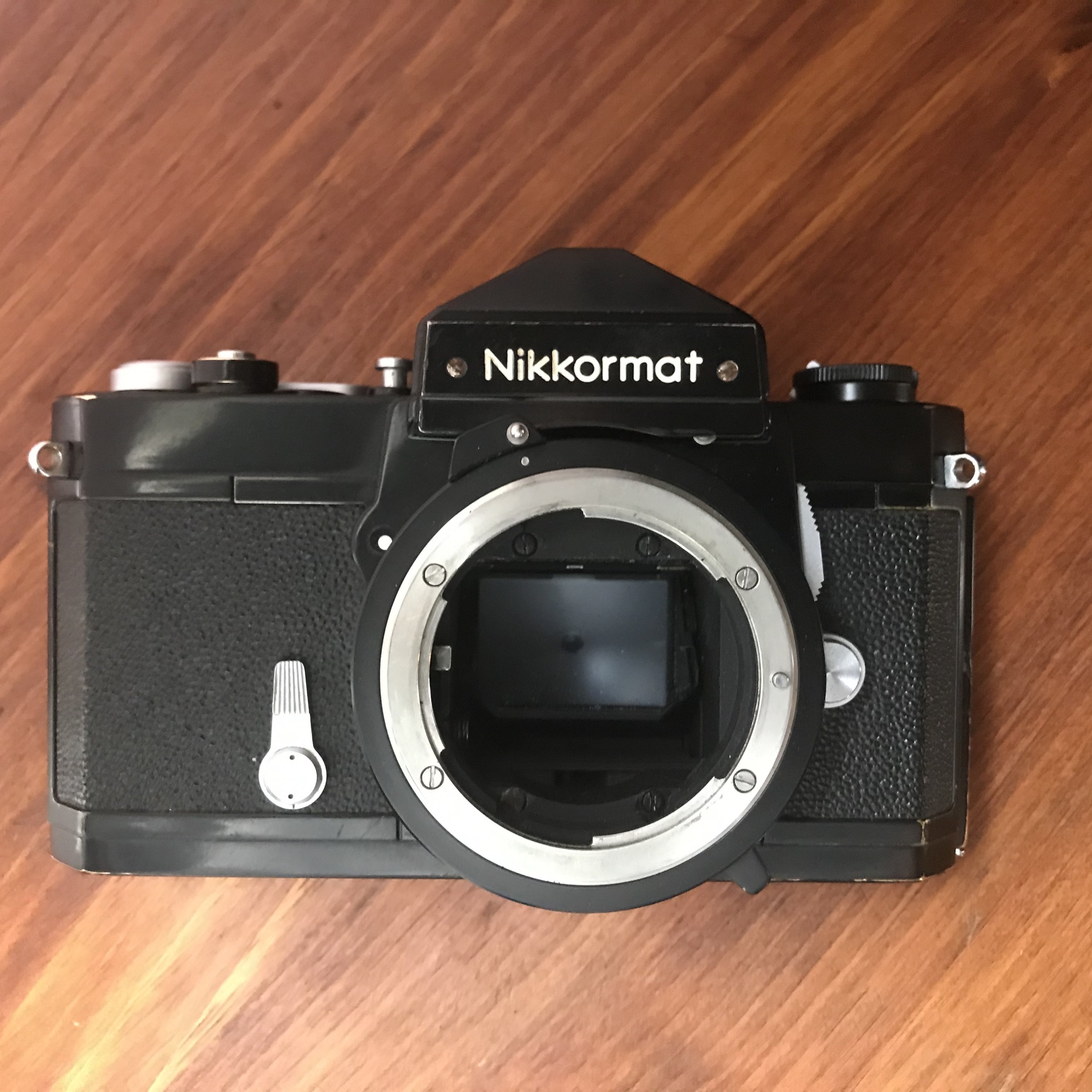

For sale is a nice Nikkormat FTN body in black paint.
Shutter is working at all speeds including slow speeds. Aperture level working. Advance working.
Unsure about the exposure meter as I do not have a battery suitable to test it. Compartment appears clean. Viewfinder is clean with some dust. Could definitely use some mirror damper foam.
Perfect all manual camera as it sits with very nice paint. Very modest edge brassing really looks the part.
Metal eyepiece is worn but included!
Asking 45$ Shipped anywhere in the USA
