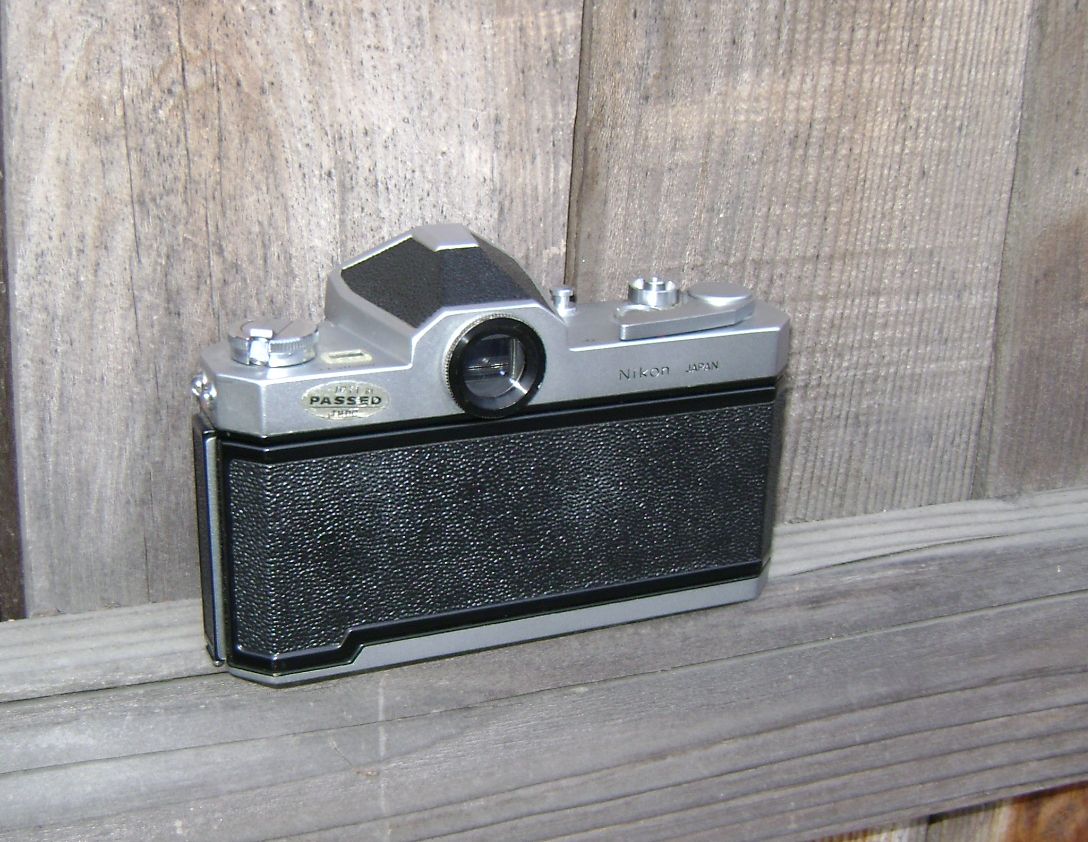

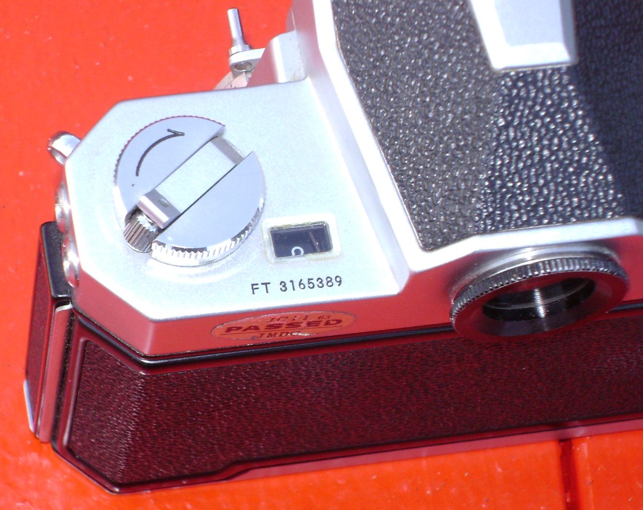

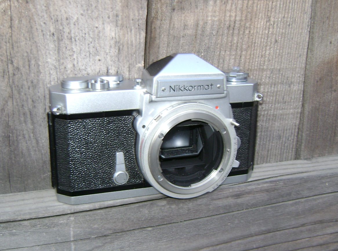

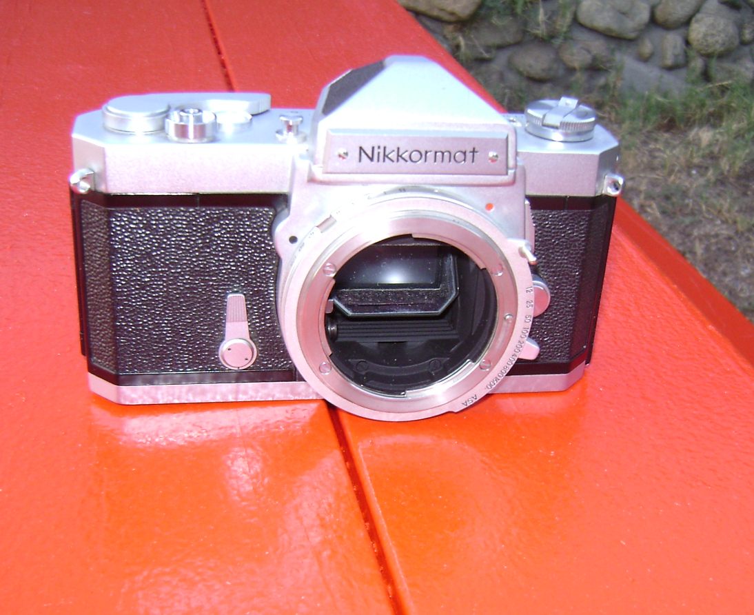

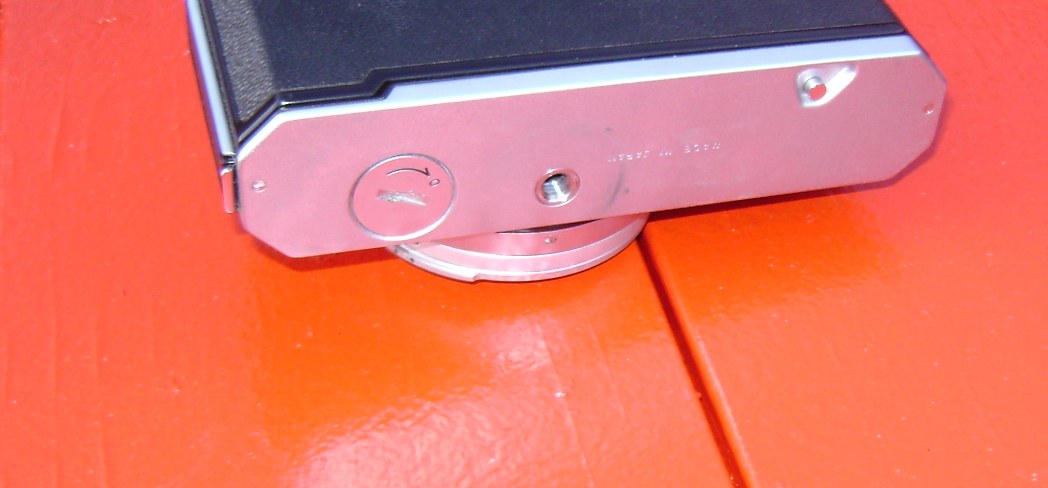

I am selling a Nikkormat FT body. Everything seems to be working and in reasonably good condition, even the meter. The meter action is a bit "jumpy" as one turns the aperture dial (common problem with Nikon), but it seems to settle down at fixed settings. The light seals could use renewal as with most vintage SLR's. A quality camera for pocket money!
Price: $20 plus shipping

Hah. It's mine, now. The pictures don't do it justice and it came with a working Wien cell. :smile: The cap for the cell compartment isn't as bad as the photo makes it look, either.

The procedure of which conversion is: Remove two screws holding bottom plate, lift off plate. Desolder wire from cell compartment. Solder diode in series with cell compartment and meter circuitry, replace plate and screws. $59 for 10 minutes work. The FTN finders for the Fs are simply recalibrated, which is a considerably more involved procedure.
