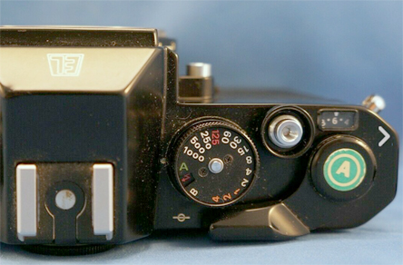

I took delivery today of a Nikkormat EL. The shutter fires but every few frames, the mirror hangs up just under the bottom of the focusing screen. If I just push it up the rest of the way, it comes back down. Is this a mechanical problem, an electronic problem or maybe a battery problem? The meter works and the shutter speeds seem right so I would like to get the camera functioning. My first Nikkormat EL has a split image screen with a microprism collar. The one that arrived today has a microprism in the center. I didn't know they were also made with the microprism in the center.

Some ELs have split image focus aid and some don't. The ones with it have a green "A" sticker on the wind lever cap (which may have worn off).
