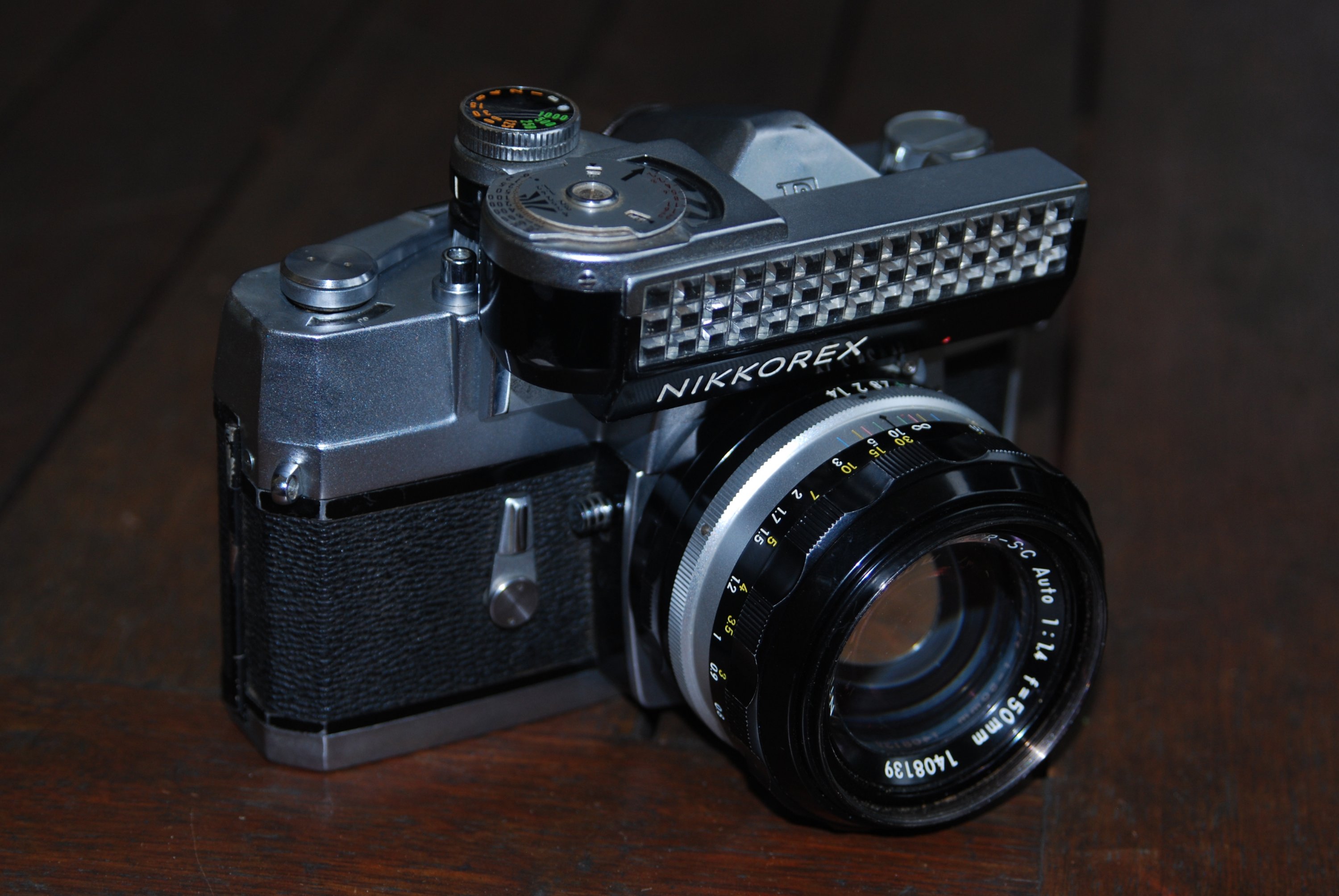

While perusing the camera cupboard at the local pawn store, noticed this old thing minus the lens for $20.
Why not?
Took it home giving it a tidy up and everything seems to work including the light meter.
Slow shutter speeds were a bit too slow but after plenty of shots seem to be coming good.

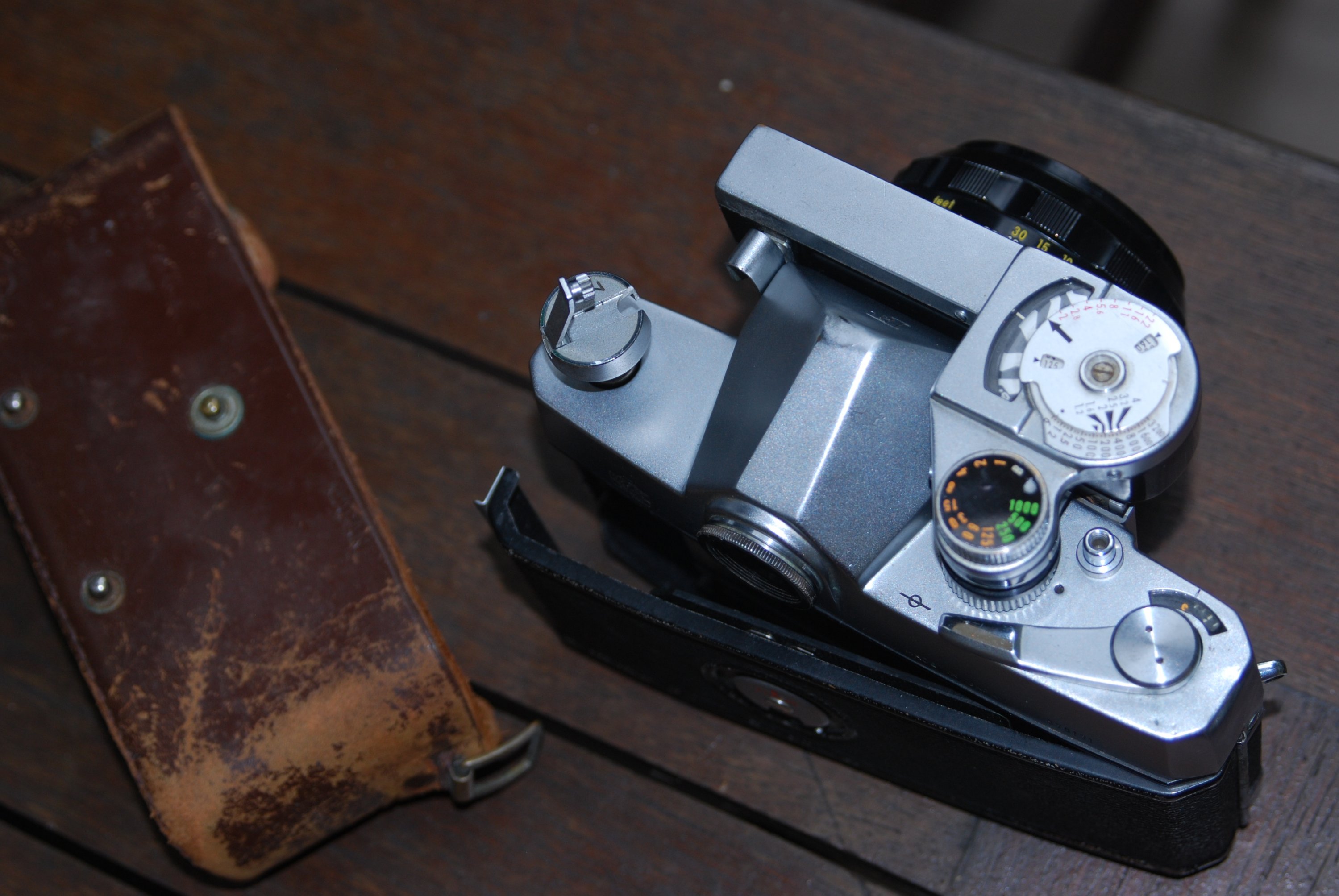

The speed dial on the meter is a bit lose and comes disconnect, should be able to fix.
Shutter button has stuck a couple of times, but should come good I hope.
A few dings.
Optics are clean as well.
Think it may be a keeper.
Anyone know anything much about them? From the net seems to be a budget Nikon F.

Selenium exposure meters like that will degrade over time, eventually becoming inoperative, if left exposed to light.
This problem is commonly encountered with both hand-held and in-camera meters.
The solution is to store the camera in a closed cupboard or drawer where it's dark, or in a closed camera bag.
If carrying it around outdoors, it's desirable to have it in a closed case. You may not be able to find one.

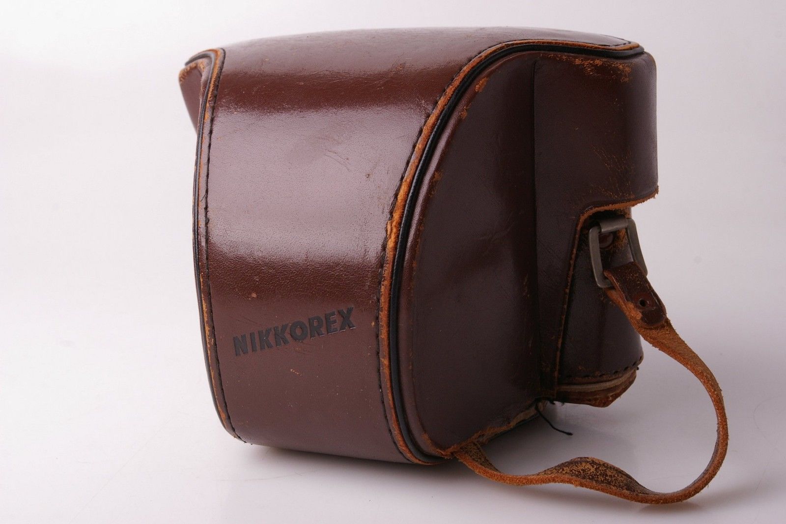

There happened to be an old Nikkorex case on ebay going cheaply so I bought it.

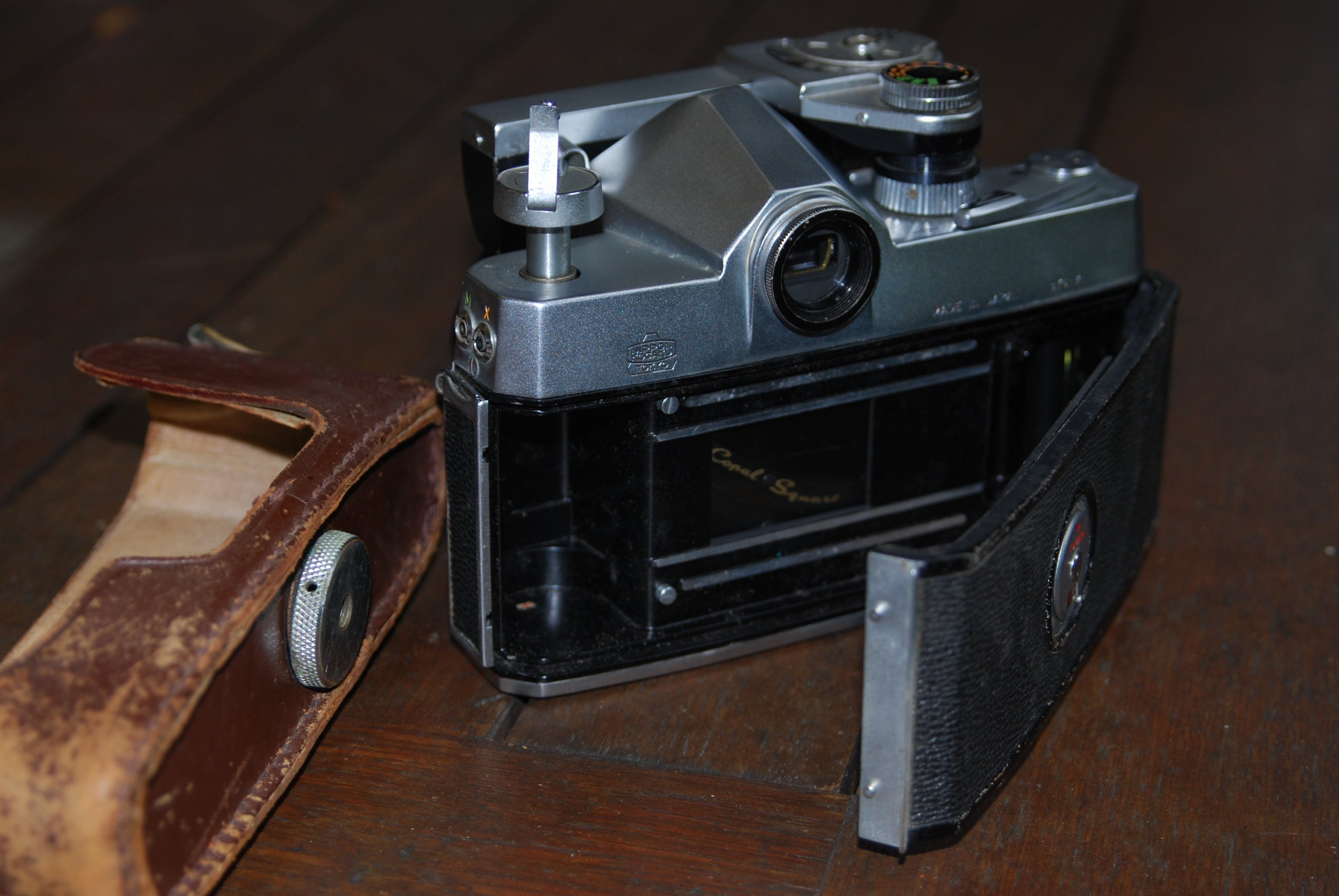

The Nikkorex has a Copal Square focal plane shutter, as you can see simply by looking at the shutter curtains from the open film door in back. It is a vertical travel shutter somewhat more similar to the modern dSLR shutter. As a result its X-synch shutter speed was faster than the usual 1/60 of horizontal travel shutter curtains, and you can synch with electronic flash as high as 1/125.

You guys are too harsh on the old clunker.
Given it a clean and all seems to be working ok now.
Tested the meter against a Sekonic and its spot on in good light, no good at low light.
The screen is bright and clean and is easier to focus than my f2 or f3, about the same weight as an f2. Its not as smooth as the Nikons, but its not that bad for a 50+ year old camera. Similar vintage to me and Im not as sprightly as I used to be:smile:.
The mirror lifts when using the timer to negate the clunk of the mirror slap, good feature.
Nothing more to do than load up some hp5, put on the Fedora and go out and take some snaps.:cool:
