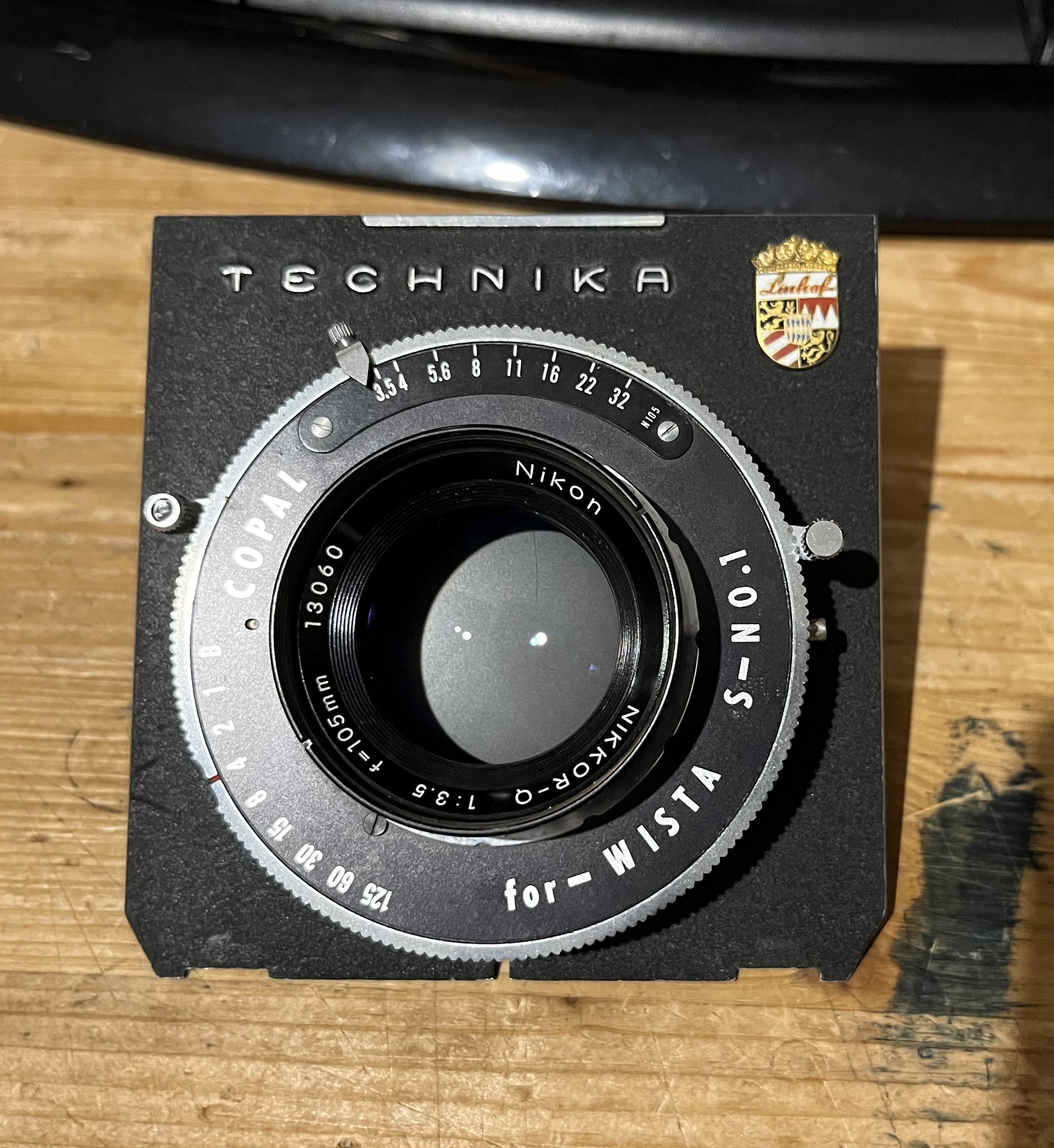

I also had this lens for my Bronica S2a and I loved it. But then I deided to concentrate on 6x9 and 4x5 and sold all smaller cameras except a Fuji GS645S and a Voigtländer Perkeo II.
For 4x5 I also have the Fujinon SW 8/105 with a giant image circle. I’ll use the Nikkor for smaller formats only. I bought the strange Wista shutter variant. But since I like self cocking shutters I‘m quite happy with it. Tommorow I‘ll test it witht the Lomo Instax back. Thanks a lot for all your information.
If you wanted this lens, you could have asked me :smile: I was planning to list one soon.
I‘m pretty sure I‘ll ask you again for nice things :smile: Sometimes I think I should complete my Nagaoka toolbox with the standard 4x5 field camera that could use all the backs I have.
The shutter itself isn't strange. The lens fits into a #0 size shutter, but the Wista variant is usually a #1.
These shutters were made specially for Wista. They have two cable release sockets. One is the normal socket for releasing the shutter. The second socket can be fitted with a cable that goes to the back of Wista cameras. When a holder is inserted into the camera, the shutter automatically closes and the shutter can be fired. The shutter opens for viewing and focusing when the holder is removed.

Thank you for your knowledge. I was surprised that such a small lens sits in a Copal 1 shutter. But for me this press shutter was the reason to buy the lens, since it is very useful for my douple exposure projects.
