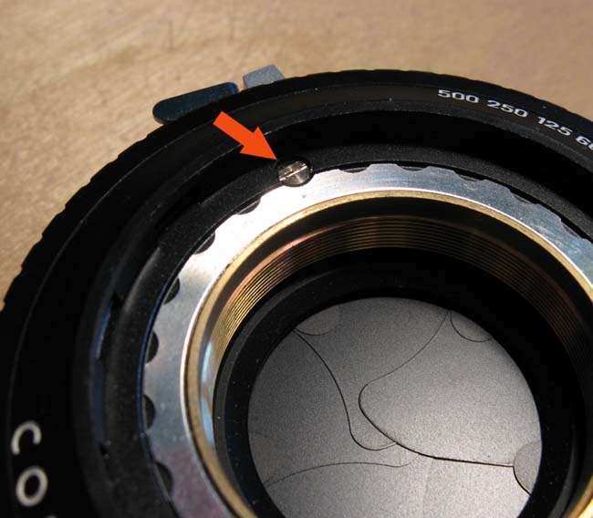

If it's only the shutter speed ring that's loose (and the whole front element doesn't wobble when you try to move it back and forth), then you can try this:
Unscrew and remove the front element (watch out for any shims that could fall off). Turn the locking screwhead (red arrow in the picture) 180 deg, cw or ccw, so that the flat part faces inwards. Use your fingernails to tighten the notched silver retaining ring (clockwise) a few notches. The ring should turn easily. Test and repeat if necessary. If the shutter speed ring gets too stiff, back the retaining ring off a notch or two until things move freely.
As for swapping shutters, you should be able to unscrew and exchange the aperture scales if it's the same type of Copal shutter. On Nikon lenses the scales are printed directly on the band of thin aluminum that wraps around the shutter, so you have to remove the whole band. Alternatively you could transfer the markings onto a sticker on the replacement shutter. The Copal shutters are made with pretty close front-to-back tolerance, so you should move any shims that are there across with the front element.
Stress from the weight of the elements would cause loosening of the screws that hold the two halves of the shutter together. These are accessible from the rear of the shutter, but are buried under a couple of layers of rings...

I ended up buying the 120mm copal 0, but emboldened by the fact that I would have a working shutter soon even if I horribly destroyed the one in my possession, I bought a set of mini-screwdrivers and went to work on it. From behind I removed 3 small screws which held a silverish retaining ring in place, which in turn held the aperture ring, which finally held the open/close shutter ring in place. Underneath all three of these were 4 screws, which sure enough, were loose.
Few wristurns later, and 2 attempts trying to get everything back together and still functioning I now have a new problem: what lens to buy for the new copal 0 shutter I'll be receiving in the mail soon :smile:
