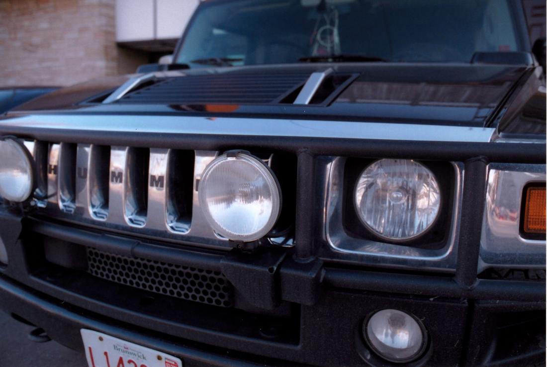

First shots.
Had a roll of film developed this A.M. then dropped my last few $$ to lay away the 24mm.
I like this lens!!
