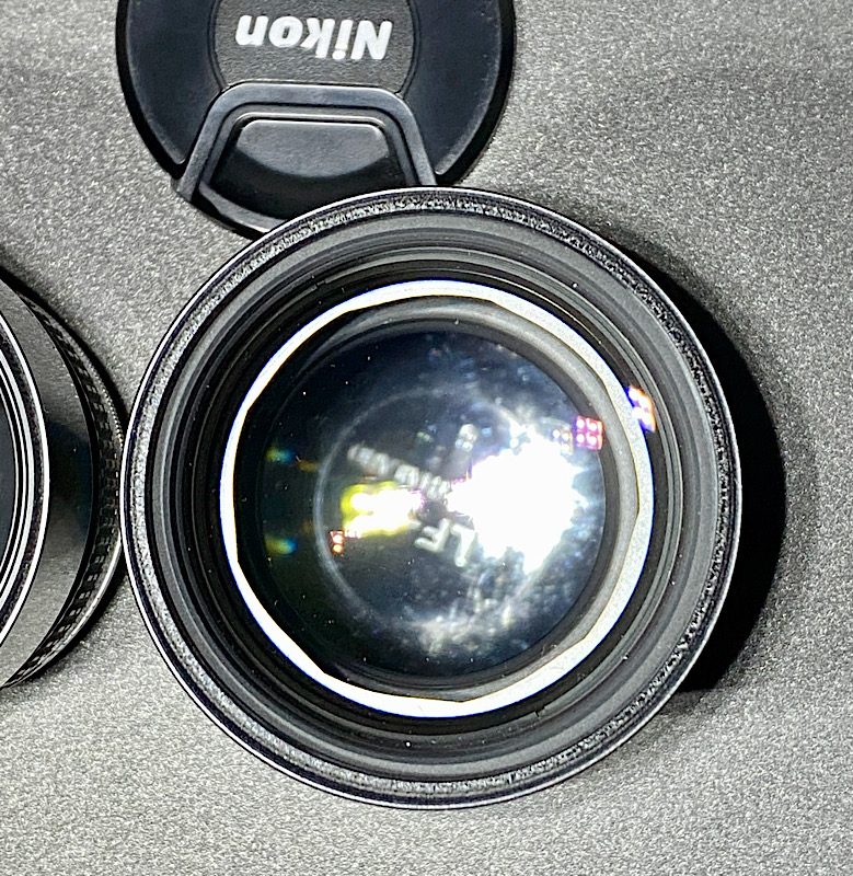

My new second-hand 135 DC still shows some of the aperture blades at maximum aperture which should not be the case:
I suspect that the aperture is misadjusted and I have already corrected this on another lens.
But I will be careful not to try to do anything myself here, this complex lens is not for DIY, at least not for me.
I have already asked Nikon and I think they will be able to adjust it.
Update to follow.

I asked a repairman friend of mine about this, who is a professional with Nikkors and has a lot of experience.
He said that the aperture misalignment is below Nikon's tolerance limit, which is 1/3 of an aperture. If that bothers me, it can be easily adjusted. It has no practical effect on the image results.

Nikon Support says that everything is within the norm and nothing needs to be adjusted.
I'm glad that nothing needs to be repaired for once 😊
