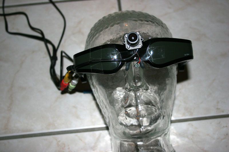

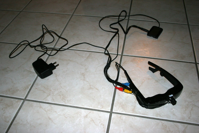

I use selfmade IR-goggles since many years and I don't want to miss them.
I add a camera in the center of TV-videoglasses. The camera must be B/W.
Illumination of the darkroom is done by 940nm LED floodlight. The camera itself has some IR-LEDs to enhance near field brightness.
8 years ago, when I built the thing, the video glasses were very expensive. But now you can get them below $100.
The only thing is to be sure that they have a composite video input.
Cables limit range of movement a bit. I wanted to make a battery pack but never did.
With these goggles I can handle all kind of materials, even processing E-6 in tray.
