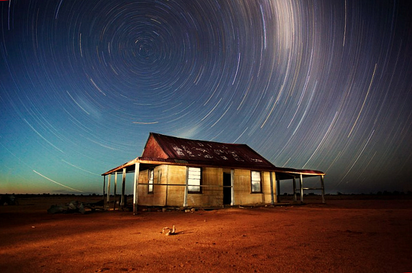

Outback night skies,
Silverton, New South Wales,
Australia.

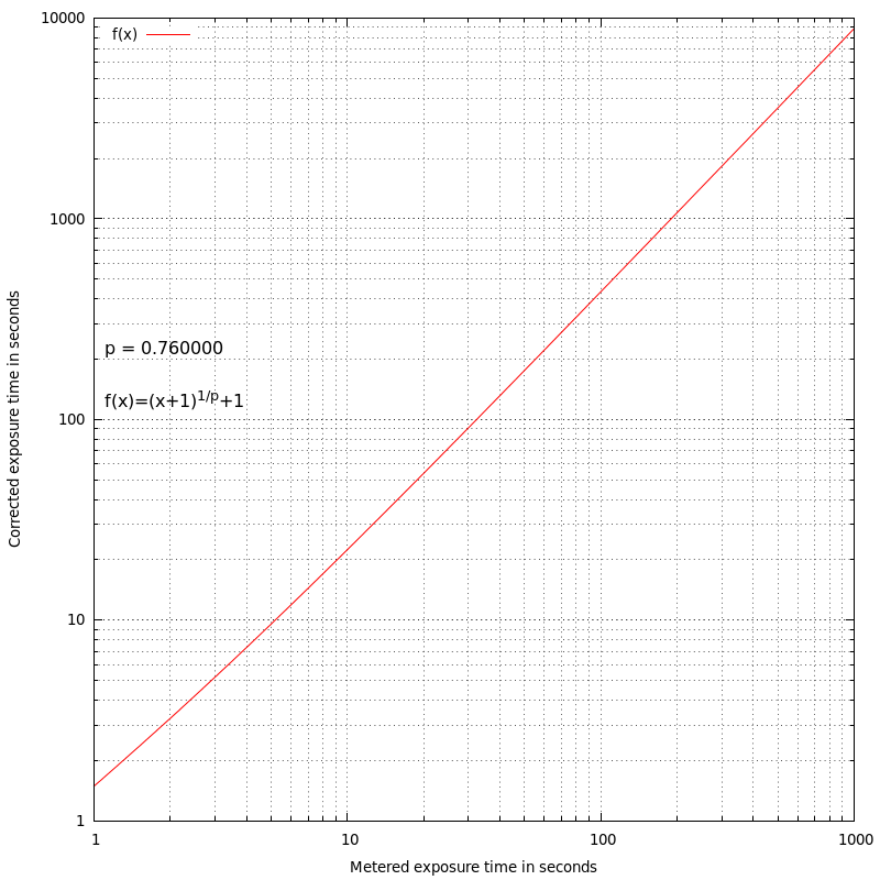

The last reliable test data I have for Pan F Plus is from over a decade ago, taken from Robert Reeves' book on wide field astrophotography. He got a Schwarzschild factor of 0.76 for the film in testing.
I'll attach a .pdf chart of the adjusted exposure times for metered times out to 16 minutes, which you can use as a starting point. These are calculated with the standard Covington modified Schwarzchild formula, which you can find in several other posts on APUG.
Lee
P.S. Came back and added a graph of Reeves' findings for Pan F Plus in case you like that kind of thing. Both axes logarithmic.

  • ReevesPanFPlusReciprocity.pdf

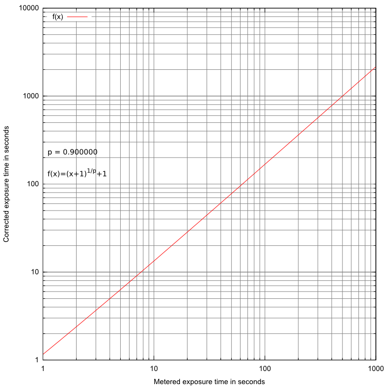

A tester on the f:295 website found that his tests matched the published data reasonably well.
http://www.f295.org/main/showthread.php?15391-Efke-PL-100&highlight=efke+reciprocity
This works out to a Schwarzschild exponent of around 0.90, not bad reciprocity performance at all, and the attached graph should be a reasonable starting place.
