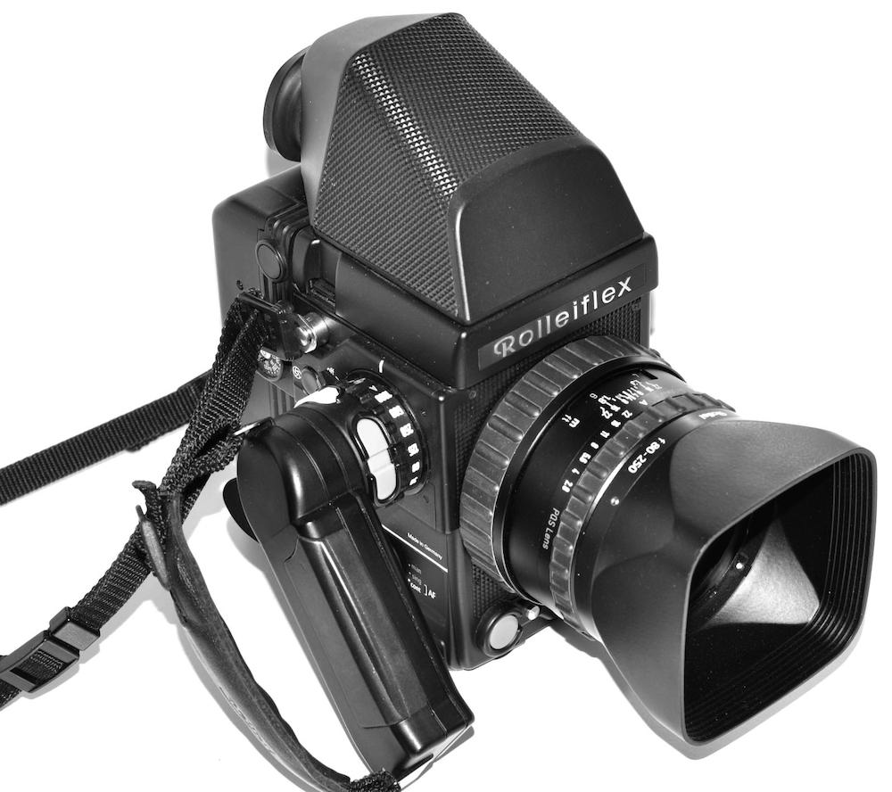

In my mid-thirty's I discovered one day at a bus stop that I was near-sighted. So I went to an optometrists and got a prescription for distance glasses. Most of my cameras, 135 and MF, are equipped with diopters so I placed rubber eye-caps on the view finder to protect the lens from scratches. However there are no diopters on large format cameras so to focus off the ground glass I had to remove the distance glasses. Then in my 70's I developed cataracts and had cataract surgery for both eyes choosing the distance option with reading glasses. Now when focusing the view camera I have to place the reading glasses on to focus and take them off for distance – the direct opposite of what it was when I was near-sighted!
ic-racer
Feb 25, 2007
16,485
USA
...autofocus...😝
