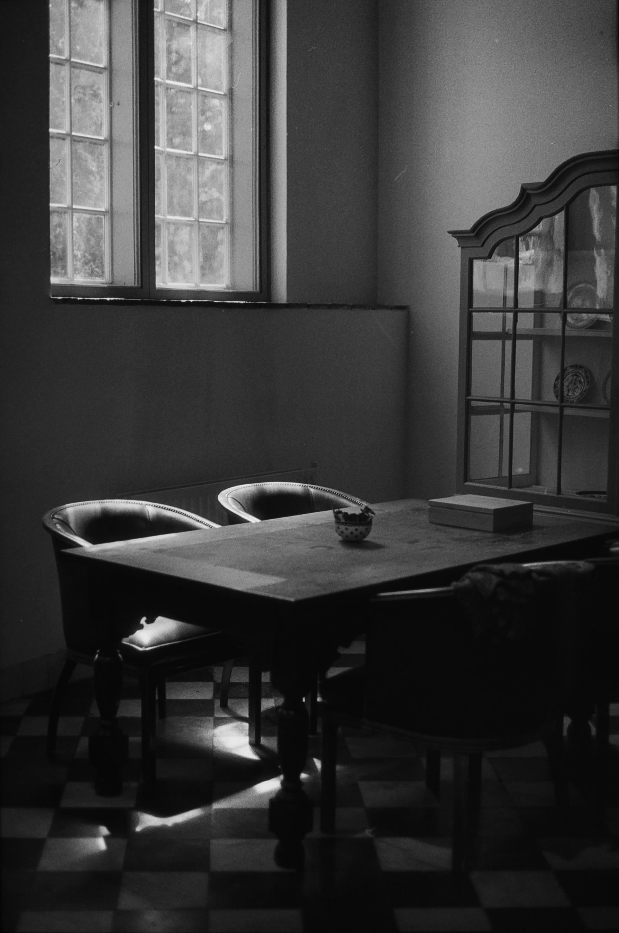

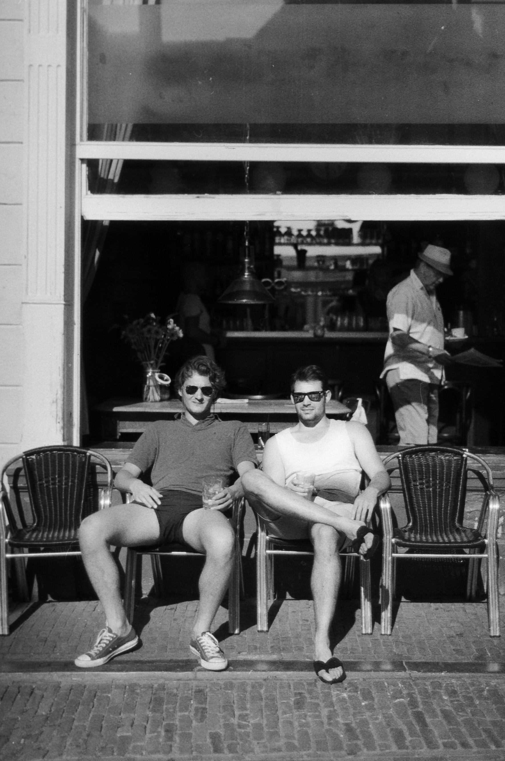

Hello everybody, first time poster here.
I was shooting film for the first time ever earlier this month, and had a few different films to try out, including a roll of Tmax 100 and Delta 100. After developing both in Microphen (which is what the local store had), I really loved the Tmax tonality (the room shot below), and really loved the Delta 100 sharpness (the Delft houses stand). I don't imagine I could make the Delta look like Tmax, but is there a way of making the Tmax sharper?
Any other 100 films I should try? I have two rolls of Acros which I haven't shot yet.
Thanks in advance!
Boris

Tmax is just as (inherently) sharp as Delta is. This has been proven time and again through the decades.
Something is amiss with your procedure, Boris, and I cannot pinpoint just what, at this juncture. Perhaps the camera was shaking slightly (tripod?) or not precisely focused. Or ... perhaps you used a lens that was not 'fabulous' at maximum aperture. There could be countless reasons, but I (we?) think that the culprit is NOT Tmax 100.
Actually, the window panes seem sharper than the table (especially more so than the front-most chairs at the near right). Thus, it just might have been wrong focus.
Given this small enlargement, I assure you that it is not the choice of developer. Both pictures should (and could) have been stunningly sharp. - David Lyga

Thanks for the reply, David. The two shots above were taken with the same camera/lens, on the same day. Both developed in Microphen, using Ilford's suggested times. Could it be the scanning? I use a DSLR for scanning, and I refined the procedure as I went along; the Delta was scanned last.
Edit: another reason to suggest it wasn't the camera/lens/photographer's (my) fault, is that *all* the Delta shots are noticeably sharper than the Tmax ones.

Again, looking closely, I am disturbed with the panes being sharper than the front-most chairs (although the metal buttons on the rear chairs are quite sharp). Focus more precisely.
Maybe scanning is the problems here, but I am not technologically savvy. - David Lyga

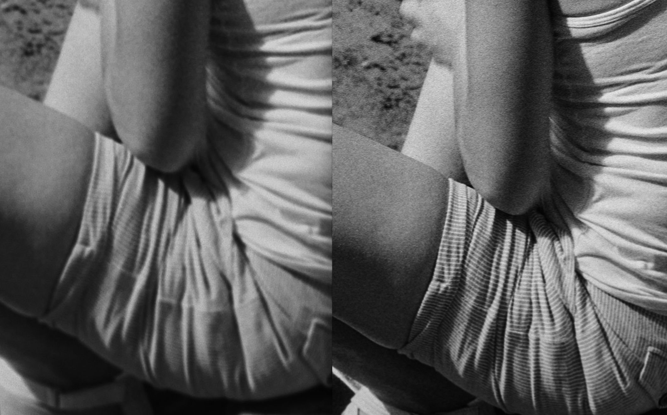

Edit: regarding the initial question – it seems to have been a moot one in a way, as both rolls seem to have much more fine details resolved than the initial scans showed. See below; earlier attempt on the left, newer method (4 shots + stitching) on the right.
