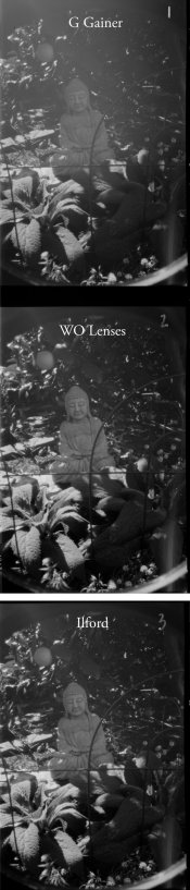

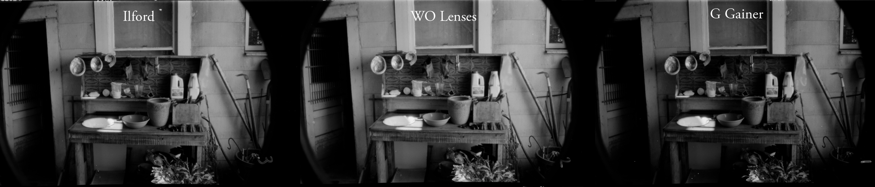

Thanks for the replies, folks. I tried out a roll of HP5 and I'm not surprised about my conclusions. First, at shorter times, the differences are much less noticeable. Second, the folks who spent lots of time and money creating the film generally know what they're talking about. To my eye, the Gainer exposures are underexposed. The Ilford exposures are very nice. The WO Lenses exposures are almost as good as the Ilford, but at longer exposure times they become too long for me to use them.
So, I'll stick with the Ilford times for now.
Attached are the results. (Now I have to cut away at the part of the camera that's causing the vignetting.)
The Ilford and WO lenses are similar until you get to the longer exposures where it is difficult to imagine that the Ilford and WO lenses exposures can be similar in terms of the negatives produced as the differences are astronomical.
I wonder how WO Lenses arrived at its exposures after about the first 4 mentioned?
