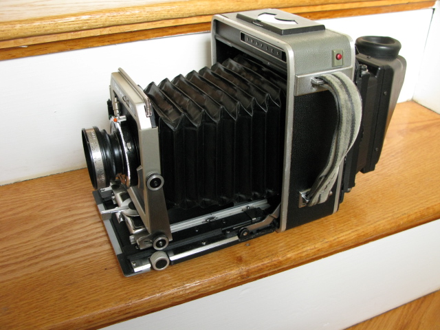

how about something with no " up side down" :smile:
