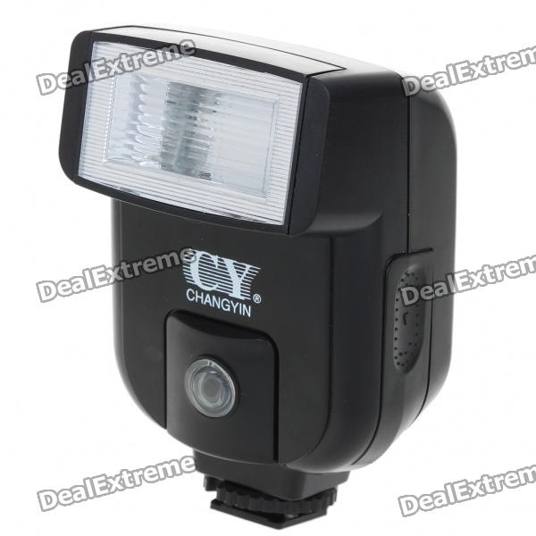

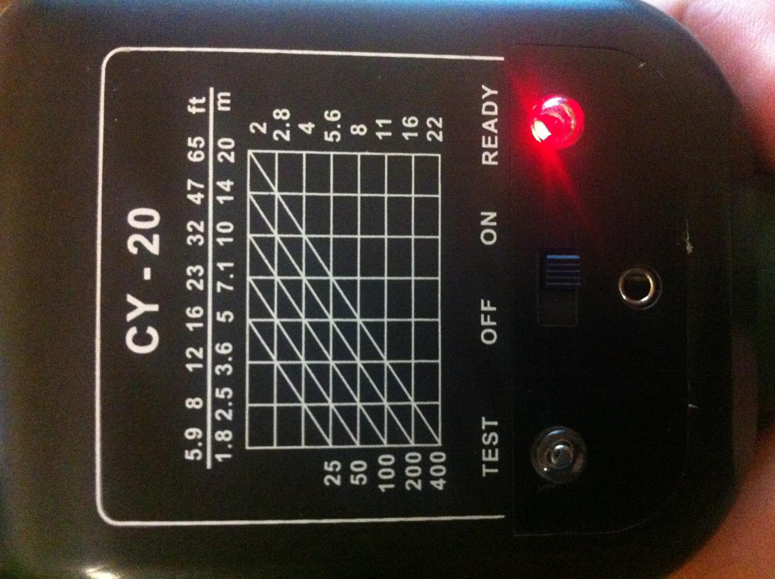

Just got myself this cheap new flash to start off into flash photography..!
I have a FM2n and a GF670 so TTL was a no go.. Also, I wanted to understand what the hell is going on before I have some auto-calculator figure things out for me.
The graph on the backside seems straightforward enough: If I use asa 100 to photograph something at 3.6m/12ft use aperture f/5.6. Things closer become overexposed, things farther become underexposed. Fair enough.
But that's considering that there is no light in the environment? Does this work during daytime fill as well as nighttime no light?
The flashes front side has what seems to be a little lens.. does that have any influence?
I'm gonna play around with it this weekend but I just wanted to know if I'm about to muck everything up.. Am I on the right track?

I would guess that the little lens in front might be part of a built in optical slave trigger.
And as for daytime use, you determine the aperture to use with the flash from the table at the back and then adjust the shutter speed to give appropriate exposure with the ambient light - remembering that with most focal plane shutter cameras you are severely restricted in which shutter speeds may be used with flash.
Your GF670 will most likely synch at all shutter speeds, but the FM2n won't.
You can adjust to taste the ratio of ambient light exposure to flash exposure. I tend to prefer normal exposure from the ambient light, supplemented by flash that is one stop under-exposed.
The first paragraph above is correct re over/under exposure.
Your second sentence is also correct. In daylight if you can use a suitable speed/aperture combination, you can get fill lighting that will slightly open up the shadows and not be apparent.
At night, you can get a properly exposed subject(within limitations of equipment) and very dark background. anything in front of the subject will be overexposed. How much depends on distance between flash etc.
The lens looks like a sensor, but there's no obvious way to turn the auto exposure on or off.
If the lens is a sensor, what is it doing? Would it be backing off the flash power when it senses ambient light?
I believe this CY-20 is equivalent (read identical) to this Metz: http://www.bhphotovideo.com/c/product/483159-REG/Metz_MZ_20220.html
There's no manual with this and there's something weird about an "Auto Flash" not doing anything automatically..
Ps: Only buttons on this is On/OFF and TEST. All of which carry their obvious functions. :D

The CY-20 isn't at all similar to that Metz flash - it clearly doesn't have any auto functions.
I expect that it shares a body with another model, which does have auto functions.
By the way, I've never encountered a flash that sensed ambient light. The auto flashes measure light from the flash bouncing back from the subject, and "quench" the flash at the appropriate amount.

It looks like the light has one setting. Much like a flash bulb it is all or nothing.
So if per the chart you set your camera at say F8 with a film EI of 100 to place the subject properly when 8' from the camera, then you would them adjust shutter time to place the background properly per your meter.
It really is that simple in theory. In reality it takes practice.
