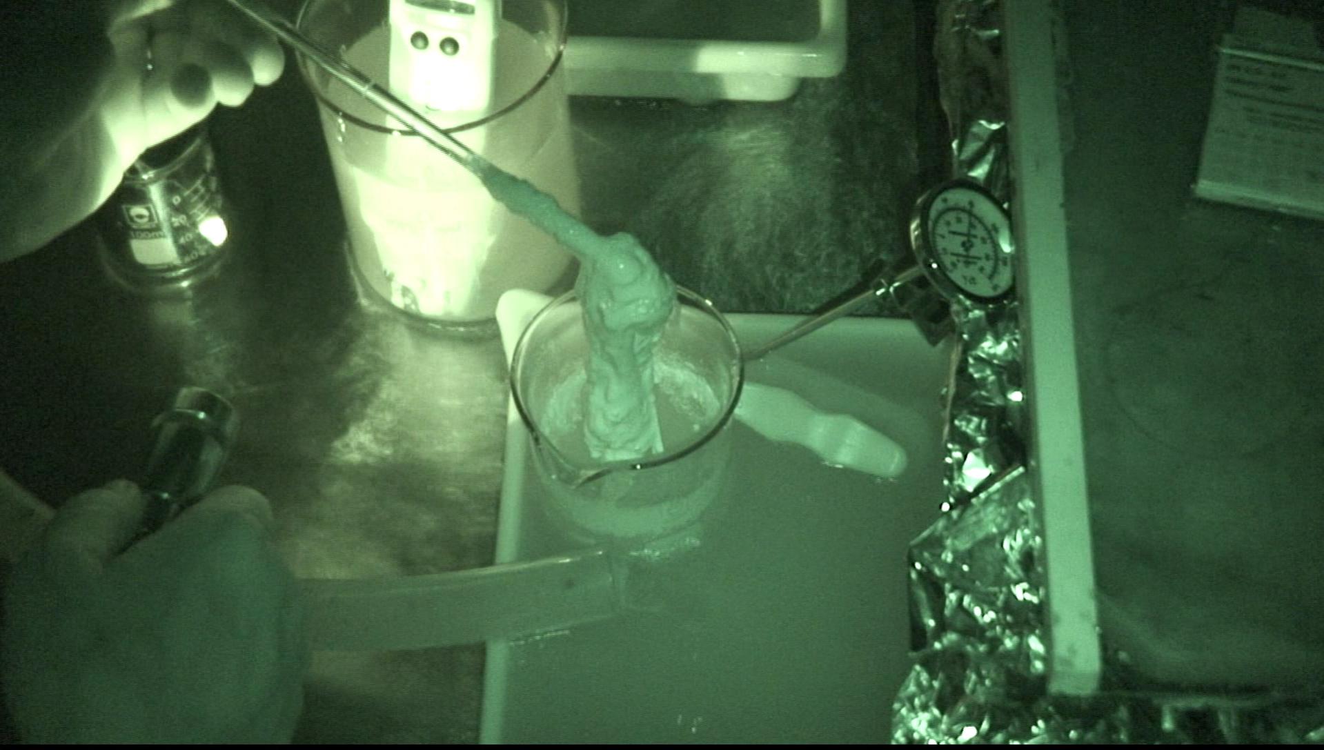

Flavio, pharmaceutical grade is ok, but food grade is not. Also, PA gelatin is not made in pharmaceutical grade AFAIK. Gelita gelatin is a tad more active than Kodak or Rousellot, and so expect more speed and fog for a given set of conditions.
As far as ISO wash, basically, chill the emulsion and reduce the pH from about 7 to about 4 with dilute Sulfuric Acid and the emulsion coagulates into one large lump. Pouur off the water and wash the "lump" several times with cold DW. Then, bring the emulsion to a weight that is short of what you want with DW and gently warm it while adding Sodium Hydroxide solution. The emulsion melts and you have washed it of impurities.
As with any wash, test the wash water and it should be clear to be a good wash.
HOWEVER, if you overwash, you can cause fog.
Now, in production, we relied on either conductivity of the wash water or on vAg which is the voltage you get across test electrodes placed in the wash water. This prevents overwashing as you can wash to an exact value.
The attached photo is a frame from DVD #1 which shows the coagulum undergoing washing.
PE

Ron,
I think you have a mistaken idea about wet coating. If you are using the right amount of emulsion, why would it run off the table? And if your piece of paper is wider than your coating rod, why would it run off the edges?
