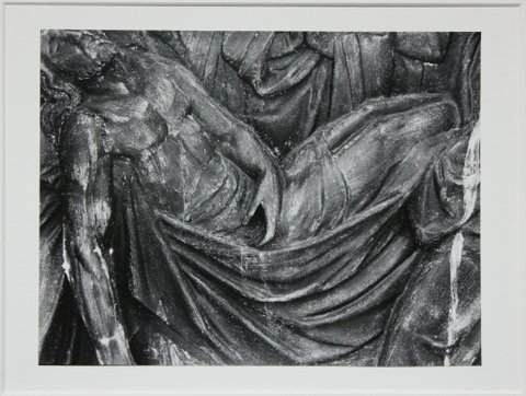

Hi Guy,
In the gallery are some shots I took in flat lighting on a weekend at Russian River (but not at the secret Bohemian Grove conclave).
I developed the film longer than "normal" because I knew the film I shot was under flat lighting. As a result, the film which normally has a 32 speed, came closer to 40 speed.
I could have underexposed by a stop.
When making prints I had to print this on Grade 3 1/2. If I had developed normally, it would possibly have needed Grade 4 or more.
I enjoy printing a negative that fits between Grade 2 and 3. When working with higher grades of paper, I feel like I have to work with a higher degree of accuracy because exposure times, burning and dodging are more sensitive to changes.
So to echo what others have said... Underexpose if you wish (but probably not necessary). Develop longer than normal if you wish (but if you use higher contrast paper, even this is not necessary).
