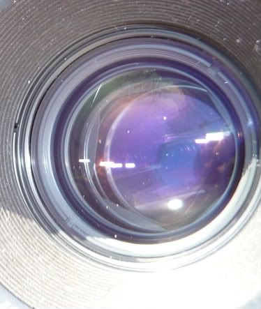

Fulfilled my dream and bought a Hasselblad 500cm. I got it complete with 80mm lens and back. I was happy to pay a bit more for it than for what they usually sell for at the auction as it was a 1986 build and the back were from the same year with matching insert with an overall fantastic condition.
However after it arrived I found it had a hair fine 5mm scratch at 3 o’clock on the front of the lens. What bugs me about the scratch is that on the auction side it was not mentioned and it was not noticed when I approached the seller… regardless of that I don’t think I will get my money back and as I said it is a great camera overall.
I ran two films through it bw and a c41 but have not got them back yet. However I think it will not show on the images at all anyway. What I am worried is flare and I looking for advice on this. Can it be corrected or would I need to buy a new lens?
If it helps I can try to take a picture of the scratch…
Would love to hear your input?
If it's just coating that's scratched off it won't make any difference, if the glass itself is scratched then under some lighting conditions it mighthave a very slight effect.
However you seem to be saying it's hardly noticeable in which case it's not going to be a problem at all.

Thanks for all your input. Amazingly I don’t think I can see any flare or other issues on the negs either. Optics baffles me. Here is a picture of the lens:
You can see the scratch on the left top of the lense. It is hard to show it in a photograph.

That scratch is well off center, although it's very visible. Even so, I don't think it will have significant visible impact on most of your photos.
This probably is a scratch that will affect the photos in a couple of instances in a way that you won't notice unless you're looking closely. Once you figure out what those instances are, then maybe you can avoid them.
Some people have filled such scratches with a flat black paint to reduce the possibility of flare, and you might try the same.
A filter combined with a hood will go a long way toward protecting the lens, and the hood will be more effective at preventing flare.
Just an additional note:
It doesn't matter where the scratch is. The entire front lens is used in the image forming process. Even with the lens stopped down.
Only two things do matter:
- The size of the scratch, proportional to the surface area of the front lens.
- How much light the edges of the scratch will scatter, and in what direction. Even a tiny scratch can cause flare.

That scratch is insignificant/Forget about it
