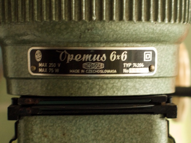

after almost a year shooting film again, i crossed with a guy selling an old meopta opemus 6x6 and went for it. i've looked on meota website, but could not precise the year or model of it... maybe they changed names to sell in brazil?
anyway... it took me a long time to clean it properly, replace the cables and switches, and also buy all the other things needed - lamps, trays, paper, etc.
now what is holding me is the lens... and i need your help on that.
the lens that came with it is a belar 75mm f4.5, and it is hazy... i took it to my repairman, and he said he could not get rid of the haze. even on simple tests i feel a lack of sharpness - films with huge grain and i can see none, details i can see with my loupe but not on the enlarger... disappointing enough to make me stop and reconsider...
there is no way i can find/afford a better enlarger over here. so i think i've married with this one!
all i need to know are the options...

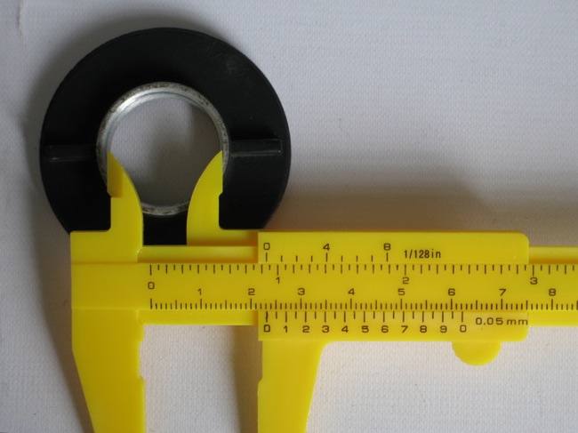

1. wich lenses have this odd 23.5mm thread? is there a list somewhere?
2. how easy it is to make another lens board, with a proper m39 thread? is it even possible?
i've been searching and emailing a lot about this matter. even got in contact with fotoimpex in berlin, but they have not the lens board i need. right now i'm watching ebay - see if some 75-80mm lenses with this thread will show up there.

According to this manual for a slightly newer Opemus 6 Standard they made 4 lenses with that smaller M23.5 x 0.5 thread:
Belar 4.5/50 #392 812 110 262 (that you have now, but hazy)
Anaret 4.5/50 #392 812 10 239 (don't confuse with Anaret S that has Leica M39 thread)
Anaret 4.5/30 #392 812 110 271
Anaret 4.5/80 #392 812 110 245 (don't confuse with Anaret S that has Leca M39 thread)
I'd search the internet for one of those. I think the later enlargers used a larger lensboard that may not fit your enlarger.

Schneider Componons came in that thread as well. Also it wouldn't be difficult to bore and rethread that lens board for a 39mm lens.
Anscojohn
Dec 31, 2006
2,704
I believe there is an adapter for that which allows one to use 39mm lenses.
As Bob-D659 says, however, it might be possible to bore out the lens board. It might not have to be threaded if there is enough room for a jam nut.
Your enlarger brings back memories. We had one in the college darkroom where I spent far too much time in the early 1960s. It's really a capable enlarger.
I believe the Schneider thread is 25 mm.
Let us know how you make out.

You may think me crazy.. but consider:
disassemble the enlarger to remove the lens board from the bellows and rail
Make a rough bore out of the lens board, using the type of stepped sheet metal drill an electrican uses to drill conduit connectrs into enclosures where there is no hole. They are eminently suited to enlarging existing holes in thinish metal
If you cant find one of those then carve a wooden plug to fill the existing hole to allow you to start a pilot bit, and use a metal hole saw to enlarge the hole to the size of the hole saw.
Then file down any sharp burs, and mould the holder for the new lens diameter out of 'Fimo' modelling clay from an artists supply store.
It dries very hard, can be fixed in place if it slips using hot glue, and is more than strong enough for the task. If you live in a very humid place, consider baking it slowly, and then spray acylic coat it to prevent it from re-absorbing mositure.
It will not be the prettiest, but with an over coat of paint, it will never be noticed once you are done.
John Koehrer
Apr 3, 2004
8,277
Aurora, Il
I like Bob-D's solution of just having the hole enlarged. It's quick & easy and there's certainly enough metal there. If you can't do it yourself there should be a machine shop somewhere in Brazil that could do it.

Enlarging the hole on that lensboard? Are you guys kidding. Thats going to leave him with a little ring of 5mm of metal. I would not recommend destroying your only lensboard. Look for a 25.5 mm x 0.5 lens. Also, some types of hazyness DO clean off. I'd not give up on that lens you have until I had disassembled it and tried cleaning all the surfaces. If the haze is going to come off, it will come off very easily. If it does not come off easy, then the glass or coating has been etched by the fungus and its not going to get any better with cleaning.
Here are some new lenses in M25 (expensive, but just an example of what to look for)
http://www.bhphotovideo.com/bnh/con...&bsi=&bhs=t&shs=m25&ci=547&basicSubmit=Submit
Here is one for $35:
http://www.bhphotovideo.com/c/product/800510855-USE/Isco__75mm_f_4_5_Enlarging_Lens.html

ok, people. i just wanted to share with you the solutions i've found in order to be able to enlarge.
it turned out impossible to find anything with the same mount my Belar lens had. all i could find was used ones, with nasty pictures of it... no way!
it was very easy to find somebody to make the same plate but with a l39 hole in the middle, so i've done it! right now there's a russian industar 50 on its way to my home.
at the same time, yellowcat made me this offer for his schneider componon, and all i had to do was to take the old plate for the same guy who made me the l39 and ask him to open the hole a little bit wider. now i'll have the 80 and the russian 50!
i'll attach some pictures.
i want to thank you very much for your concerns and help. it was very useful for me!
