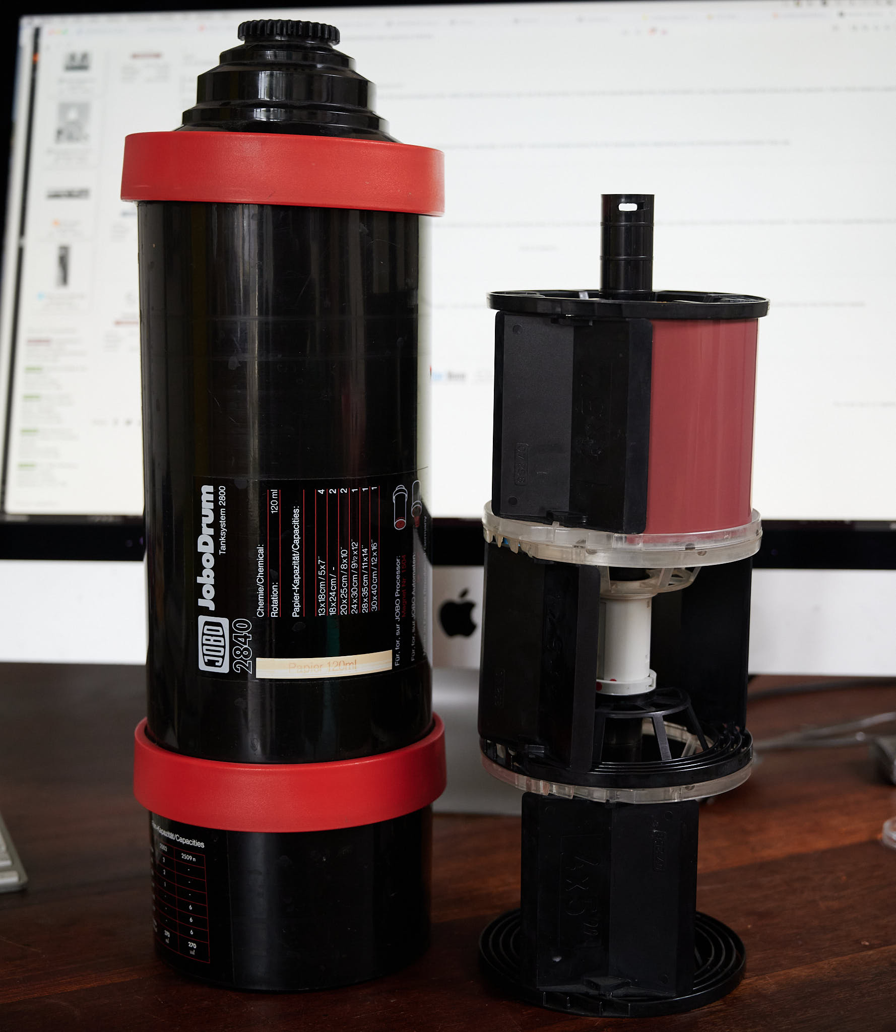

Ive seen 6 sheets reels, i think there is a tank where i can stuck two of this reels
koraks
Nov 29, 2018
25,631
Europe
OK, so we're talking about 4x5" I assume.
I see what you mean; this would be in the 2500 series. See e.g. the #2560 tank, which should indeed fit two reels. I do not see this tank listed anymore on the jobo.com website, but it's still on the jobo-usa.com website and it may pop up here and there on the 2nd hand market.

Agreed! Use the recommended time for 1st developer, there's a lot of different recommended times out there. I use 6'30". I definitely would try it with a single sheet 1st.
The 4x5 reels work great if you can get them loaded 😊
I use IR goggles.
I believe that the increases in development times are published for subsequent batches. I would be cautious. With E6 1st developer time and temperature is extremely critical.
When I shoot 35mm I use auto bracketing of 1/2 stop (Nikon F5) this has saved me many times!
One thing nice about the sheet film reels is the ease of washing. Bad thing is loading.

My 3010 Jobo drum will handle up to 10 4"x5" sheets.
