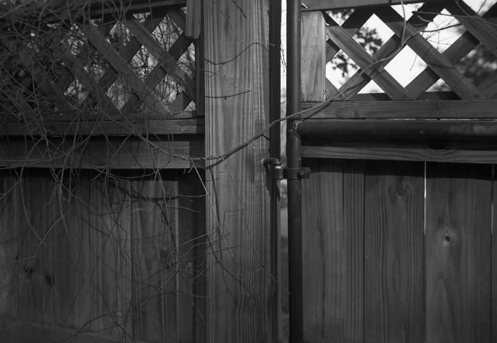

I picked up a Zeiss Ikonta folder the other day. The focus is set by distance and not through the lens, which is a bit different, but I was amazed at the "look" of the shot! Something "Old School".
What else would I expect from a camera that is 60+ years old???
Anyway I liked the look. It has a Prontor SV shutter and a Novar astigmatic 105mm f/4.5 lens.
The sample photo was just one of the test shots in late afternoon sun but it holds up to a 100% crop!
