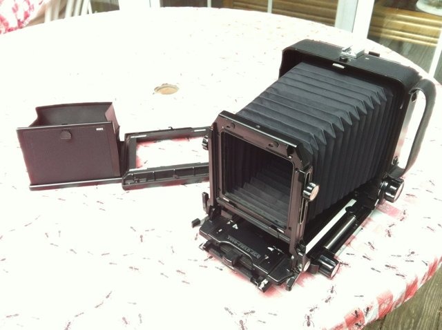

Ugh, I feel like mold plagues me everywhere...
Just got my first 4x5 in.
It doesn't SMELL like mold like everything else I've gotten that made me cautious, but there were mold spores between the focusing screen and ground glass, which gave me pause.
I've put the body out in the sun and been rotating it to try and get all the sides etc, and taken apart the glass holder and washed it and no more mold spots... What do you think? Send it back to Japan or keep it?
It's used, eBay, PITA to ship back, but don't want to be foolish.

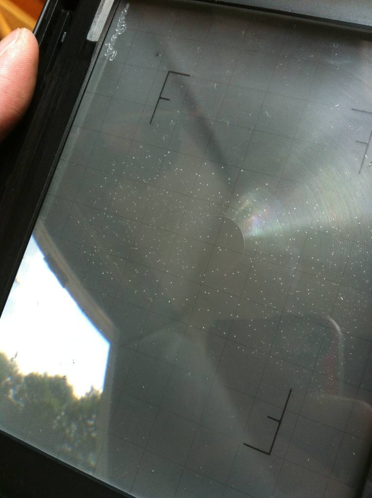

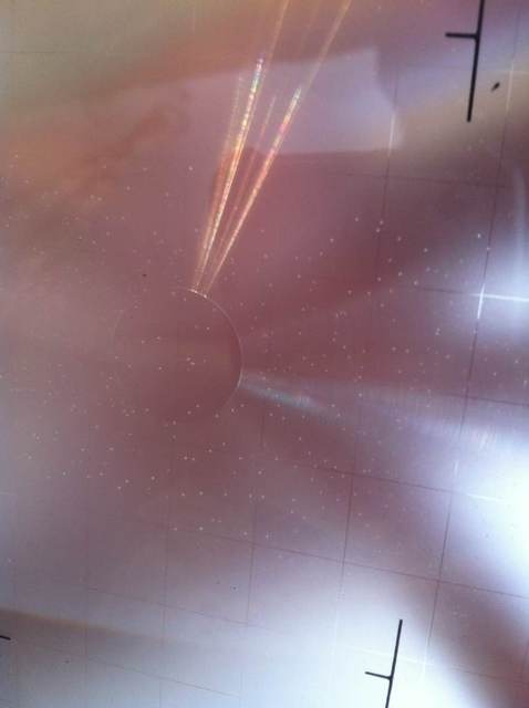

It seems to only be concentrated at the center of the ground glass and not on the edges. Again it was wedged between the two pieces and not on the outside...
Suggestions?

Always wash ground glass and fresnels with your finger tips only rubbing the fresnel in the direction of the ribs only. I use Dawn dish soap. I spray mildewed bellows with Lysol Disinfectant Spray on the inside after washing the outside down with Isopropyl Alcohol. Treat the outside of the bellows with Pledge Furniture Polish in the yellow spray can as a final step. The bees wax and lemon oil is good for vinyl and leather.

99% isopropanol or drug-store hydrogen peroxide. Test on a corner area first. Doesn't look like anything major to me, nor does it seem like a mold invasion.
Stone, mold spores are already all around you in daily life. There's no avoiding it - only controlling the conditions to prevent growth.

I had similar mold like specs in one of my toyo gg+fresnel sandwich combos. Took them apart, cleaned carefully with mild dish soap and problem gone. Until there will be again enough moisture and proper environment for growth....
The moisture comes from rainy days and when it's cold enough that breathing under the dark cloth fogs everything.
