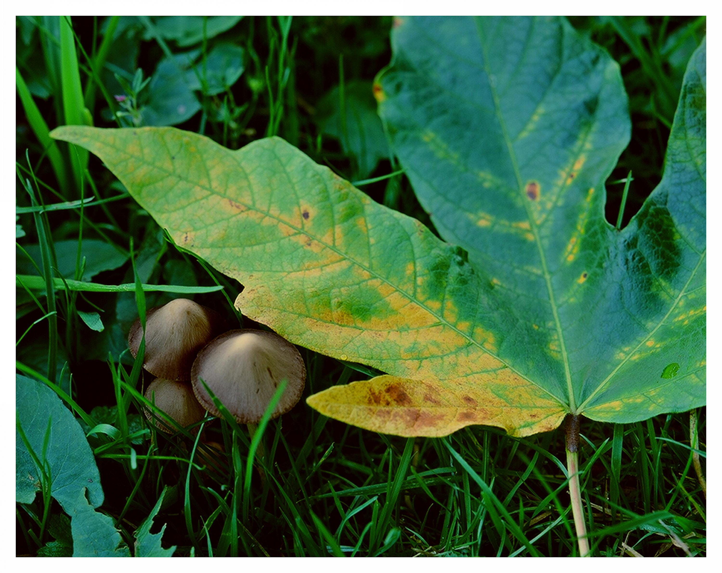

Increased exposure is helpful for negatives, but hurtful for slides.
Actually, there are some similarities between digital work and slides, because blown-out highlights are the most common errors in both.
You need to evaluate your exposure carefully, because you have relatively low latitude available.
I tend to prefer slight underexposure for slides, but then I aim for projection more than printing.
This was shot on slide film and metered carefully:
