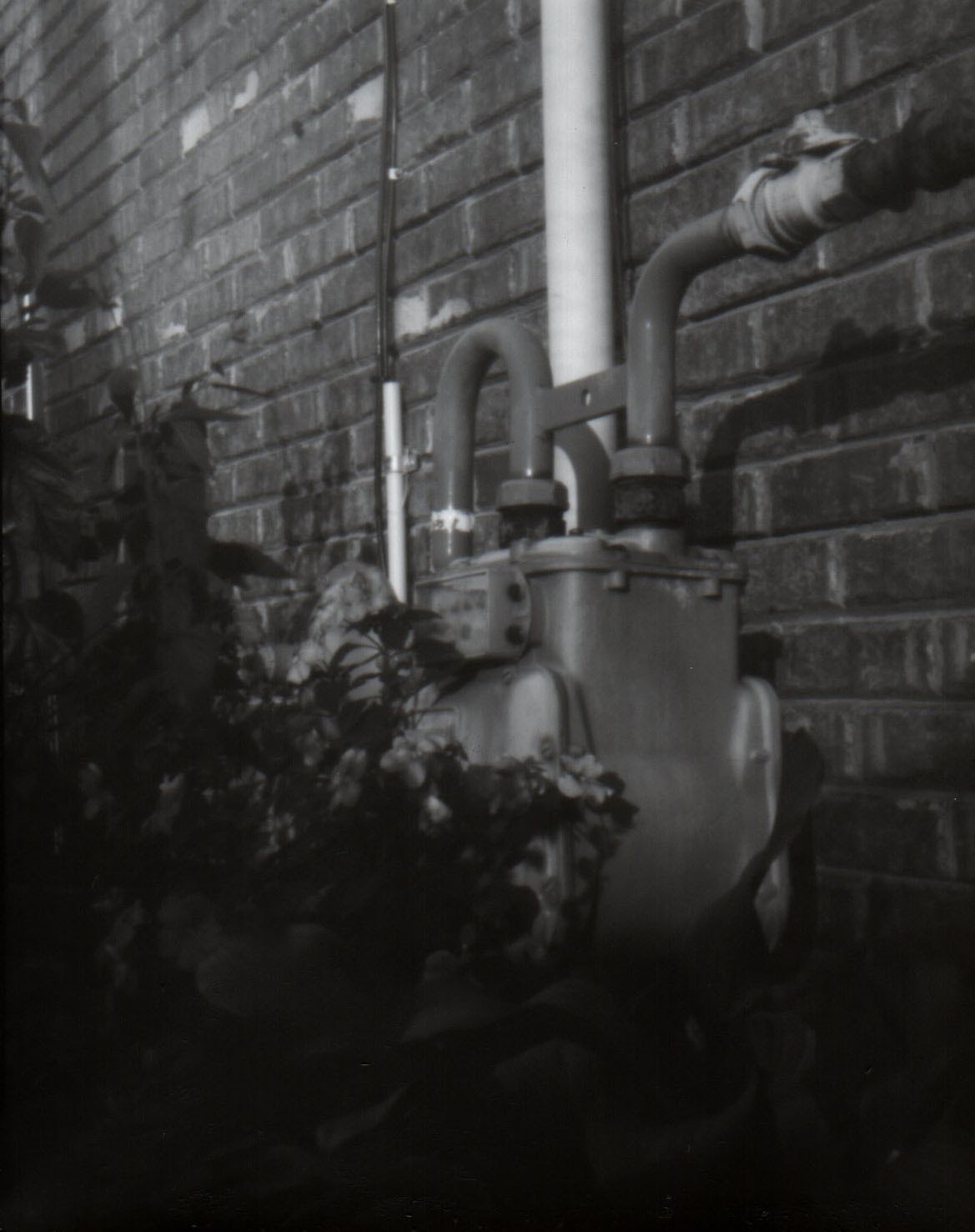

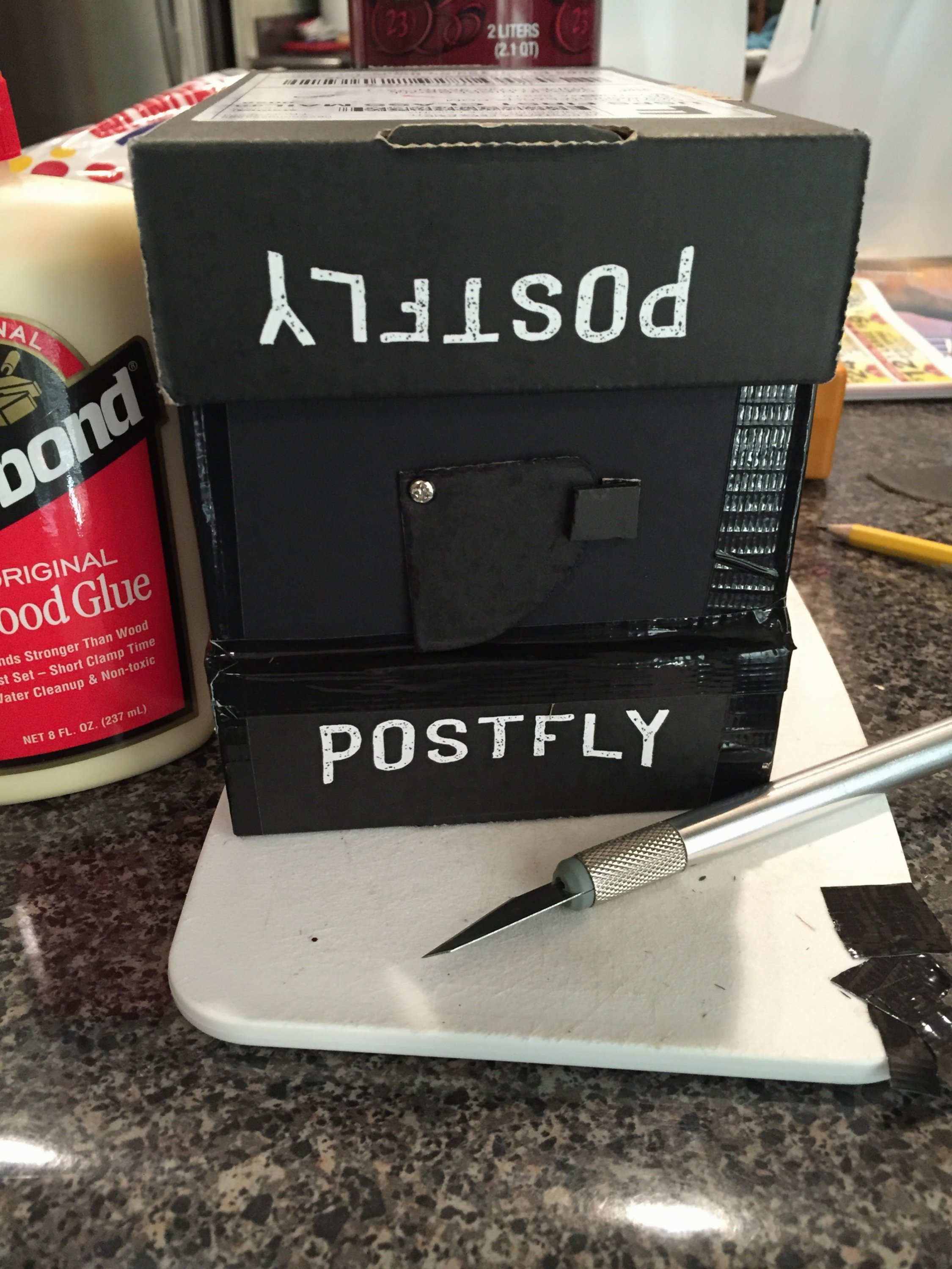

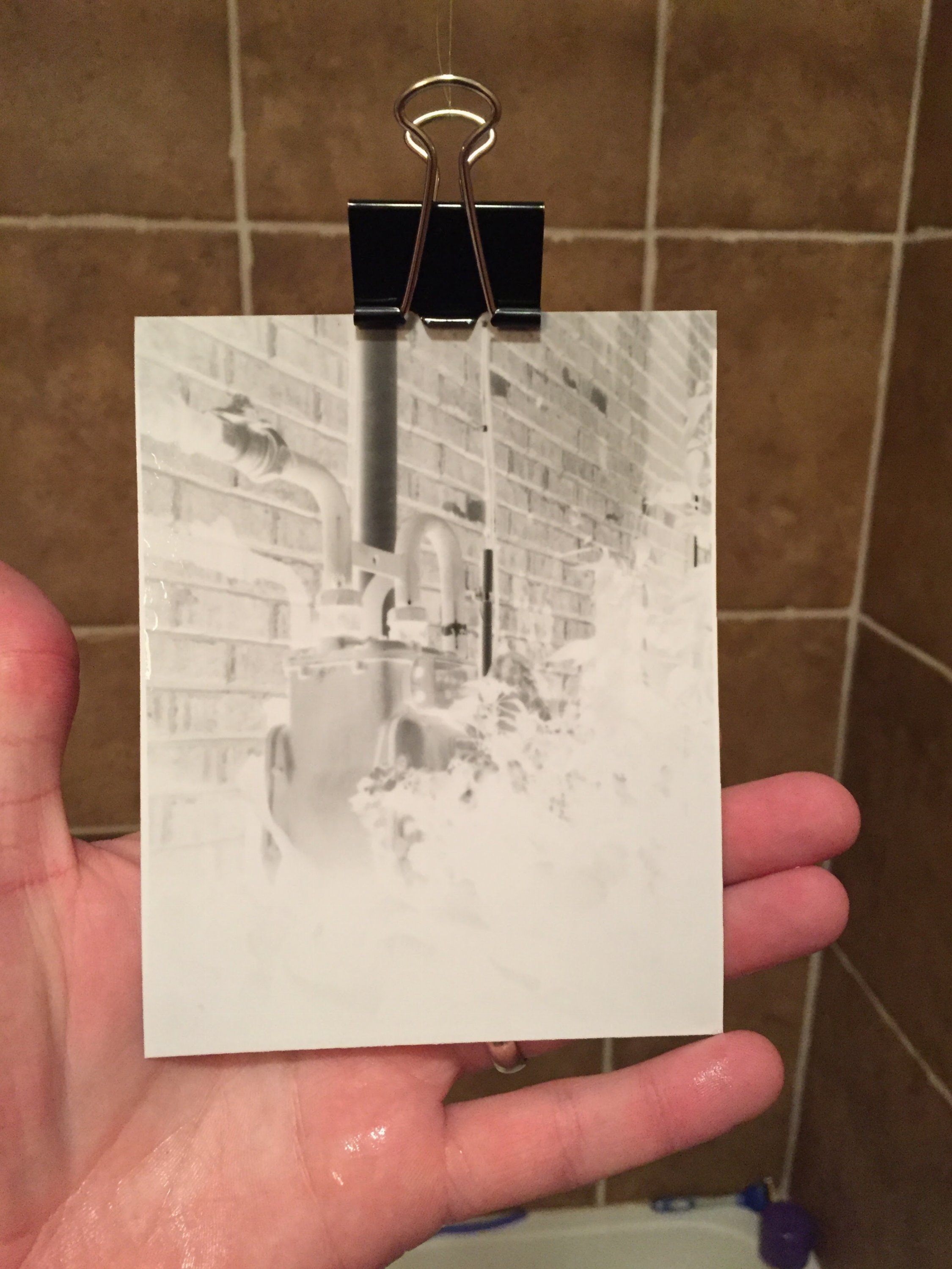

I am new to pinhole and the forum really. Would like to start some home developing so I decided pinhole would be a great step in that direction. So after some research I made a camera, worked out the bugs (light leaks) and got a real photo on try 3.

It is a bit additive, I catch myself looking around for boxes. I used the "PINHOLE PHOTOGRAPHY AND CAMERA DESIGN CALCULATORS" on http://www.mrpinhole.com/calcpinh.php.
I first started with the Ipanorame from pinhole.org but after building it I was checking measurements against what was written in the text and something was off (focal length was suppose to be 4.8", mine was 3.75"). I ran the numbers through the above mentioned calculator and the measurements did not line up again, so I scrapped it and started over.
I may have printed the template wrong.

I love your design. Did you create from scratch or use some sort of template? That shutter is the bomb :smile:

Joe,
I figured out I wanted to use 4x5 sheets, cut from 8x10 sheets. Price works out really cheap that way. 20 8x10 sheets makes 80 4x5, in theory.
Then used the pinhole calculator and went from there...that shutter is horrible! I need to redo it to a smooth sliding one.
