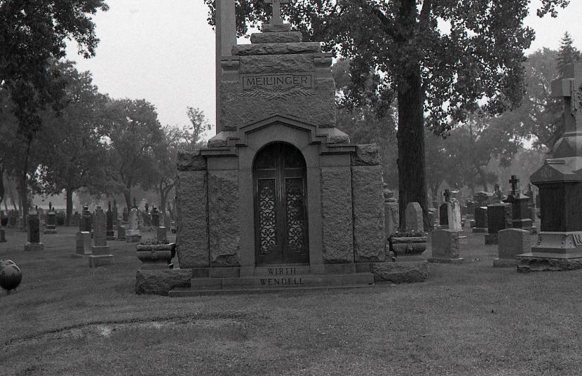

I was trying to make a print and i think my negative is not printable. This is my 2nd time trying to print a negative with no luck. The print comes out so grainy its awful! It goes from extremely grainy to complete black. I have no previous experience and was wondering if someone can give me advice on how to print. I really think the negative is no good for printing because it to dark. Below is a scan of the negative.

It's very difficult to say what's going on with such limited info. The scan looks ok, but did you have to do any extreme levels or curves adjustments to get it to look this way?
If the negative is really dark (overexposed), you may very well get a grainy print.
If the print is totally black, it could be the paper was exposed to room light. Is your darkroom light tight? Are you safelights too bright? Is your fix exhausted?
With all due respect, if this is your first time printing on your own, you may be doing several things wrong. Basic printing is not hard, but there are a few things you must/must not do.
I highly recommend Tim Rudman's book on printing. It's called The Photographer's Master Printing Course. There are, of course many books on printing, but this is an excellent one.

Don't despair. That is not bad for a first effort.
Don't forget composition, rule of thirds, etc. The cross on top is cut off...
It helps when you list specific details of your process. At a minimum:
  • film format, film type, developer
  • Paper (VC or graded)
You scanned a positive image of your negative which makes it a little more difficult to evaluate. But if your scanner can make a decent representation, you can do better.
On my monitor, you need more contrast so use a higher contrast filtration when printing or more magenta exposure time if you are using split contrast printing technique.
In regard to grain, I assume you are using 35 mm film and enlarging that. You will get grain but if the print is black then you overexposed the paper or fogged it. Are you making test strips? You should if you are not. Posting a scan of an 8x10 test strip would get you a lot of advice for printing.

The scan is a regular scan with nothing done to it. When i try to print it looks like grainy 3200 film. If i exposed it longer on the enlarger it starts to go black, with no detail at all. It turns black if i expose it 3 seconds or longer at f8. I dont know if this matters but the film is hp5+ and the developer was rodinal. I will look for the book on printing that you mentioned. Alos the paper is new and the safelight is four feet away and its no a real safelight but a red bulb that is in a lamp that i was told i can use for printing.
I don't use that combo but I believe that HP5 in Rodinal is quite grainy. For 35 mm, try TMAX400 in TMAX developer for minimal grain.
I suspect that your "safelight" might be a problem. Do a crude safelight test by taking an unexposed sheet of paper and place it under the safelight in the same position as you print tray and then do a test strip by gradually covering up sections of the paper and noting the time of each section. (A proper test would be to flash the paper first with a subthreshold amount of light but that is overkill for your purposes.)
If you exposure time is just 3 seconds then you need to stop down your lens or add neutral density to the filtration. Try f16 for starters.

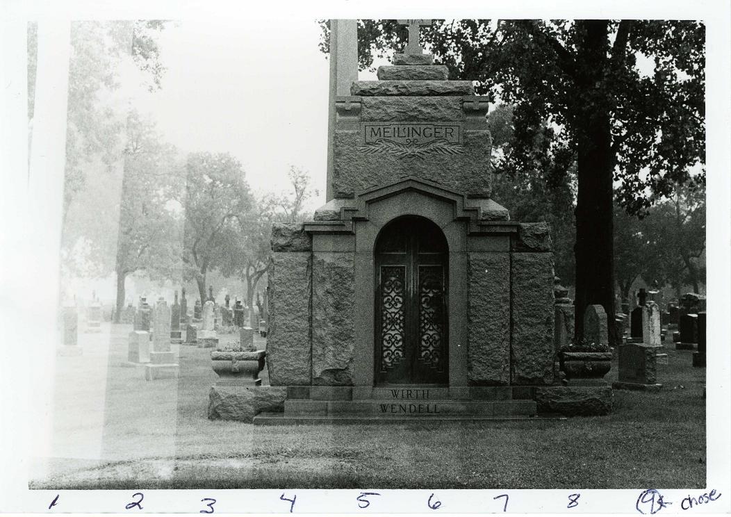

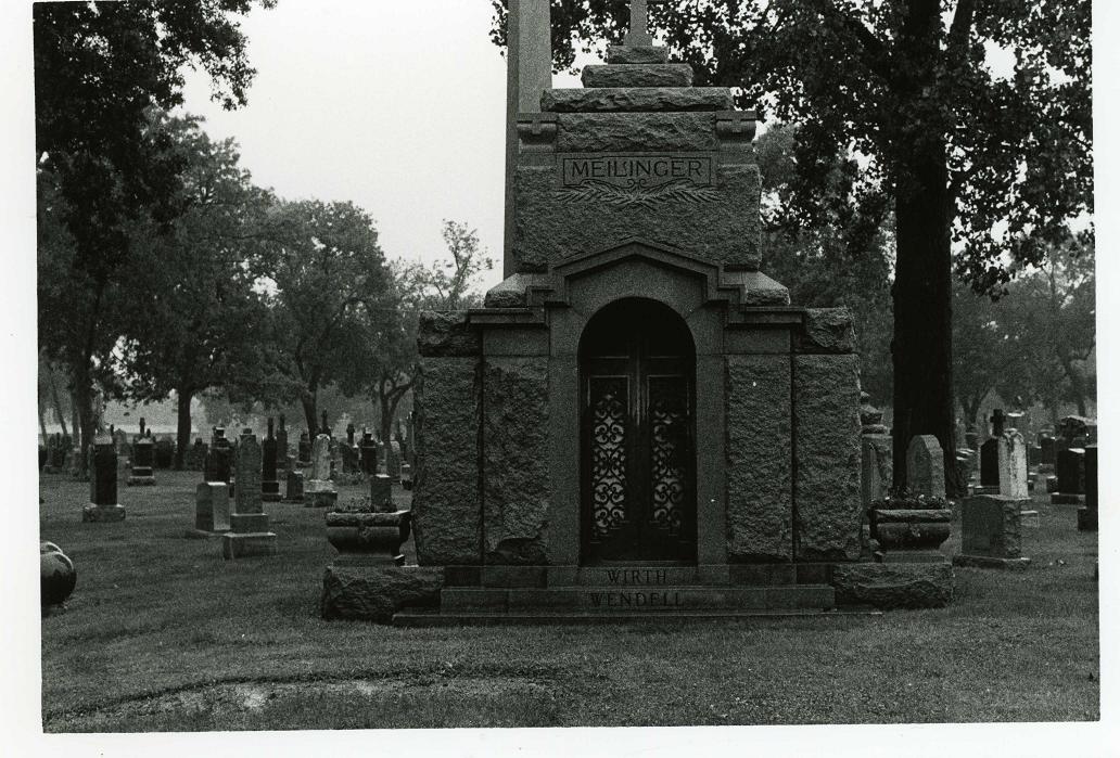

I wanted to reprint it last night but after a talk with my neighbor who has a son who studied photography he offered to have him come by and give me some advice. When he arrived he told that i have 2 issues. My first issue was my main light the is directly over my developing trays, it is a Cf bulb that he said glows after its turned off. the second issue is that my developer is no good. the developer i was using was purchased new from a well know dealer and appears to be old. My developer is a very dark yellow and almost like a syrup and should have been more near a clear color. He gave me some ilford developer and i changed the bulb above the trays and i used a 2# filter as Jbruner suggested.
When i first tried to print the negative before the print was so grainy the you could not understand the name on the monument. I know the print is terrible by your standards but its a start for me. I used f11 for 9 seconds with the 2# filter and the results are below. Please keep in mind that this is the actual first time i printed a negative and was able to have the image clearly visible on the print. The scan of the print is very bad because the actual print is sharp and detailed. The print is nowhere near the negative scan but im very happy that im learning and making a little bit of progress. I chose the 9 second exposure but now i think i should have chosen the 8 second.
I have already purchased the Tim Rudman book and cant wait for its arrival.
Thank you to everyone for helping me!
R Smith
Oct 20, 2008
10
Is there a way to post the print in better quaility? The print is sharp and detailed but the post of the scan is terrible.
CBG
Nov 21, 2004
889
... I chose the 9 second exposure but now i think i should have chosen the 8 second ...
Wet prints tend to look lighter than when they are dry. They get darker when dried. It's not a huge amount, but as you can see, it makes a difference.
So, when you are near a final print time, it's a good idea to quickly dry a test print to see how much "dry down" you're getting. A hair dryer can be handy. Various papers have somewhat different dry down characteristics. There was an article somewhere. Maybe someone will have a URL handy.
C
